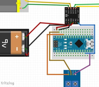

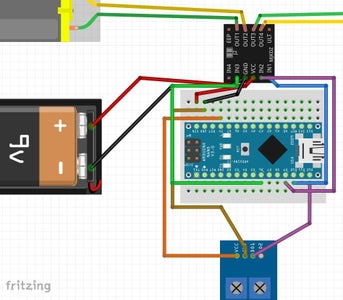

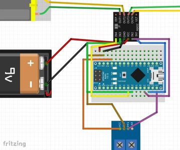

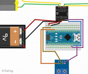

Step 6: The Cricuit
Please use the images to follow along. The following steps are numbered to the images.
- Take the red wires coming from the 9v battery case. Take the end with the input and attach it to the VCC pin on the DRV8833 motor driver. Take the remaining wire with the pin and insert it into the mini breadboard adjacent to the VIN pin on the Arduino Nano.
- Take the black wires coming from the 9v battery case. Take the end with the input and attach it to the GND pin on the DRV8833 motor driver. Take the remaining wire with the pin and insert it into the mini breadboard adjacent to the GND pin on the Arduino Nano.
- Using a purple wire attach its input side to the D0 pin on the TCRT5000. Insert the pin of the attached purple wire into an input on the mini breadboard adjacent to the D12 pin on the Arduino Nano.
- Using a brown wire attach its input side to the GND pin on the TCRT5000. Insert the pin of the attached brown wire into an input on the mini breadboard adjacent to the GND pin on the Arduino Nano.
- Using an orange wire attach its input side to the VCC pin on the TCRT5000. Insert the pin of the attached orange wire into an input on the mini breadboard adjacent to the 5V pin on the Arduino Nano.
- With the front of the robot facing you take the two wires coming from the right motor, your right, not the robot's. and insert one into OUT3 and the other into OUT4. Do not worry about which right motor wire goes where, you will adjust this after uploading the script.
- With the front of the robot facing you take the two wires coming from the left motor, your left, not the robot's. and insert one into OUT1 and the other into OUT2. Do not worry about which left motor wire goes where, you will adjust this after uploading the script.
- Using a blue wire attach its input to the IN1 pin on the DRV8833 motor driver. Take the attached blue wire and insert its pin into the mini breadboard adjacent to the D10 pin on the Arduino Nano.
- Using a purple wire attach its input to the IN2 pin on the DRV8833 motor driver. Take the attached purple wire and insert its pin into the mini breadboard adjacent to the D9 pin on the Arduino Nano.
- Using a green wire attach its input to the IN3 pin on the DRV8833 motor driver. Take the attached green wire and insert its pin into the mini breadboard adjacent to the D6 pin on the Arduino Nano.
- Using a yellow wire attach its input to the IN4 pin on the DRV8833 motor driver. Take the attached yellow wire and insert its pin into the mini breadboard adjacent to the D5 pin on the Arduino Nano.
- Using an orange wire attach its input to the VCC pin on the HC-SR04 sensor. Take the attached orange wire and insert its pin into the mini breadboard adjacent to the 5V pin on the Arduino Nano.
- Using a brown wire attach its input to the GND pin on the HC-SR04 sensor. Take the attached brown wire and insert its pin into the mini breadboard adjacent to the GND pin on the Arduino Nano.
- Using a purple wire attach its input to the Trig pin on the HC-SR04 sensor. Take the attached purple wire and insert its pin into the mini breadboard adjacent to the D7 pin on the Arduino Nano.
- Using a white wire attach its input to the Echo pin on the HC-SR04 sensor. Take the attached white wire and insert its pin into the mini breadboard adjacent to the D8 pin on the Arduino Nano.
- Your circuit is complete and your robot should have a fun hairdo of wires!

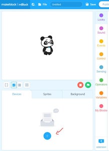

Step 8: Install Mblock and Prepare Environment
In your favorite browser navigate to https://www.mblock.cc/en/. Select Download on the topmost ribbon. Navigate to your operating system and select the download option. Once downloaded open the installer and follow the prompts. At the time of writing this Instructable mBlock is in V5.4.3, this may be different for you. Install the latest version and you should be good to go. You may also want to restart your computer after the installation process.
Step 9: Edit and Upload Code
SETUP:
Once mBlock has downloaded you will need the pre-written code. You can find the script here: https://drive.google.com/drive/folders/1c06kuLu3ujh788gS884428PngjDkNiKr?usp=sharing
Note: The following steps you will only need to do once.

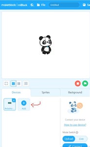

- Download the SUMOGEN3.mblock.

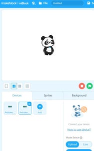

- Open the mBlock application and navigate to Devices and delete the CyberPi by selecting the 'x'.
- Select the blue plus icon.
- In the popup menu locate and install the Arduino Nano by selecting the blue plus icon and then clicking 'ok'.
- Navigate back to devices and select the Add option.
- Find the Arduino Nano (old) and install it by selecting the blue plus icon and then selecting 'ok'.
- Once you have both Arduino Nanos close the program.

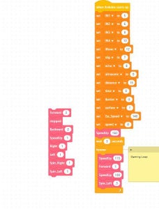

UPLOAD TEST CODE:

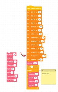

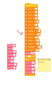

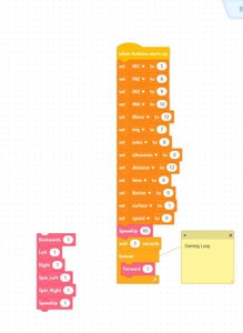

- Navigate to where you saved the SUMOGEN.mblock file.

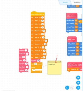

- Open the file and the mBlock application will open showing the pre-written code.
- If the code is not visible use the zoom out button, the blue minus icon on the lower right of the screen.
- Find the stack of code that has a note saying, "Gaming Loop". The forever loop block is where you will put all your robot's code in.
- Take the forward block and attach it to the inside of the forever loop.
- Repeat these steps for the Arduino Nano(old) device too.

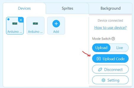

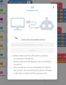

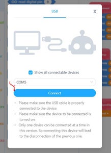

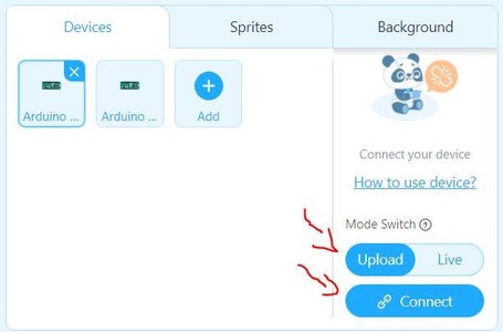

- Select the Arduino Nano and insert the USB cable into your device and then into the Arduino on the robot.
- Navigate to Devices, make sure Upload is selected, and then click Connect.
- Check the "Show all connectable devices".
- The Com number may be different for you, select connect.
- You will see the Device has a new option Upload Code. Select this to upload the code.

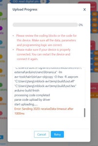

- If you get an error you will need to change to the other Arduino device. Select Disconnect from Device and then repeat the steps 8 - 11.
- Once the upload is complete and the popup leaves the screen you are ready to test.
- Remove the USB cord from the robot, insert the 9v battery, and power it on. The wheels will not start moving until after a 2-second pause.
- If both wheels are driving forward you are ready to upload more code and battle. Otherwise, locate where the motor driving in reverse is attached to the motor driver. Locate the OUT pins and swap them. For example, if the motor going in reverse is attached to OUT 3 and 4 remove them and replace them in reverse order.
- To keep the robot still while you attempt to upload more code or reverse the motor you can remove the VCC wire from the motor driver. Just make sure to replace this when you are ready to battle.
HOW TO CODE THE WRESTLING ROBOT:
- Navigate to the My Blocks tab to see all the different behaviors you can have your robot perform.
- Select any number of behavior blocks to program how your robot will move around the arena. Blocks are read top to bottom and left to right in the forever loop a.k.a the gaming loop. Once the last block is read the robot will start with the first block again until you power it off.
- Use the blocks that allow you to input a number. The number represents seconds and decimals milliseconds.
- You can also adjust the speed of each behavior block you use by placing a SpeedUp block before the action you want to adjust. The robots use PWM to control each motor's speed. PWM is a whole number between 0 and 255. 0 is off and 255 is max speed. A good range to choose from is 100, crawling, to 255, attacking.
- To adjust the range the robot sees an object using its ultrasonic input any whole number between 1 - 400 into the variable "distance". You can find all the variable blocks attached above the forever loop. These values represent centimeters.
- If you find the robot's arena edge detection movements too fast or slow you can adjust the PWM value in the variable "Esc_Speed".
- Once you have the movements you want upload your code and see how it reacts in the arena.
Note: the code for changing how the robot reacts to white and black surfaces is in the next step.
