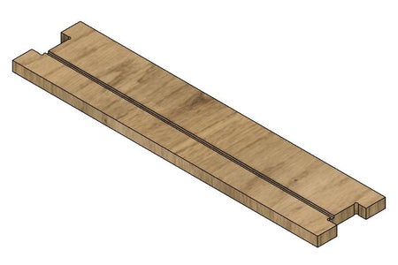

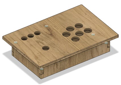

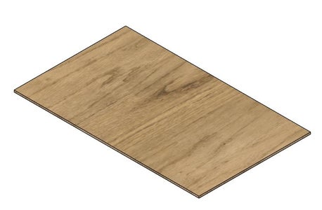

Step 1: Designing the Tabletop
We started with a piece of paper drawing some sketches of the tabletop, locating the buttons and joystick. We went with this design, seeking comfort by using a cushion below.
It has 6 wood pieces in total: 2 long planks, 2 short planks, 1 bottom panel and 1 top board. Files are attached below with some photos.

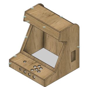

Step 2: Designing the Bartop
As on the previous step, we began by drawing sketches of how we imagined the bartop. After some time arguing and a bit of work on Fusion 360 we came up with this. Even though the marquee appears on this design as MDF, we went with some acrylic sheets instead

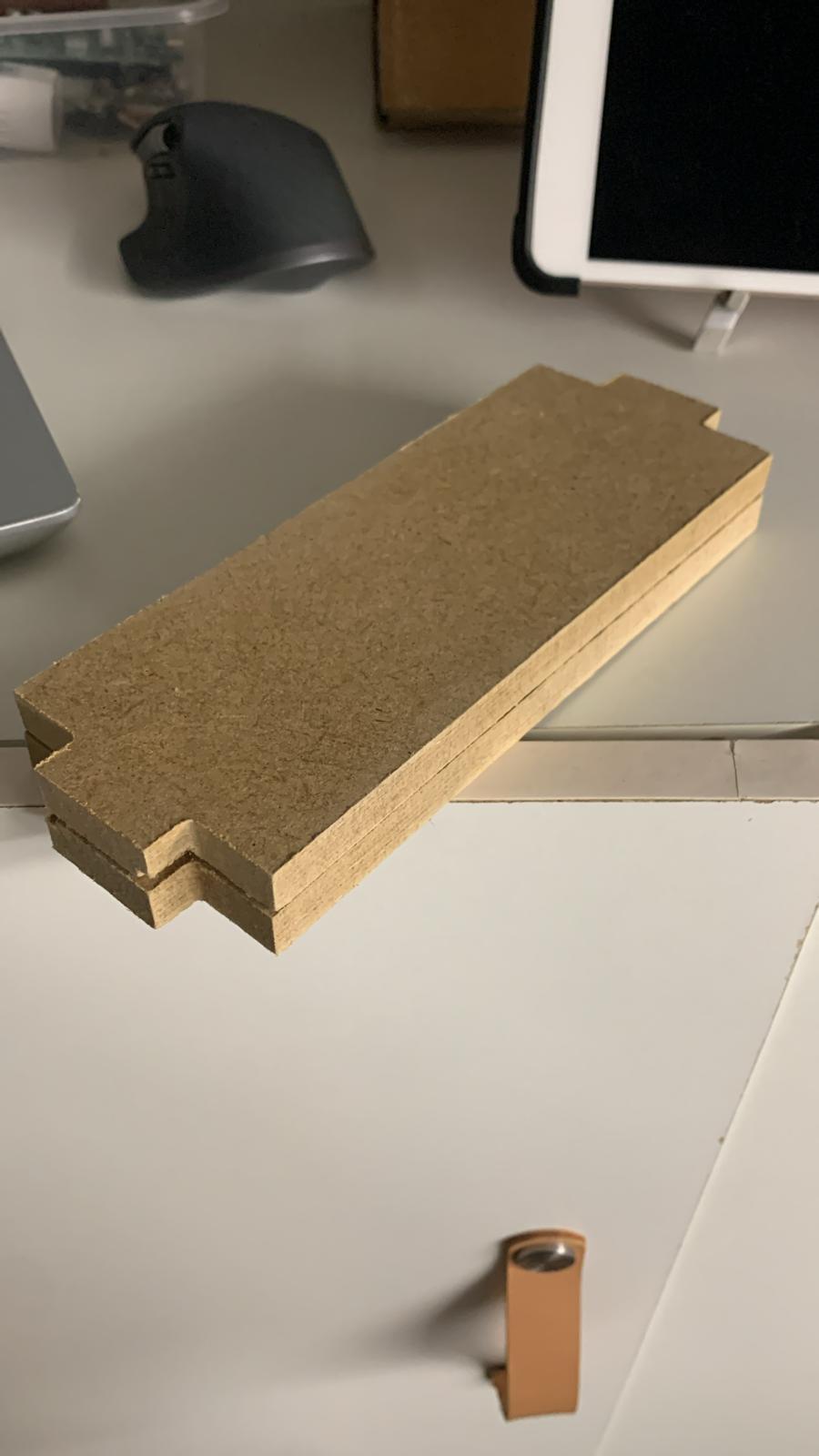

Step 3: Building the Tabletop
The final model of the tabletop consists in a base that uses 4 planks that fit one into another. Between them there is a wood pannel to hold the electronic components and a Raspberry. Over the base there is a large wood board which holds all the buttons and the joystick for the tabletop. To get the pieces well finished we used a CNC with the fusion's sketchs. Here you can see some pictures of the process. All the pieces have been primed and painted white.
To join the pieces of the board, we used a nail gun to securely hold the structure. However, the control panel has been attached with a hinge so that it can be opened to examine all the components in case of any issues. Holes have been made in order to hold the electronics in place. Wood filler was applied later to hide these holes from the outside

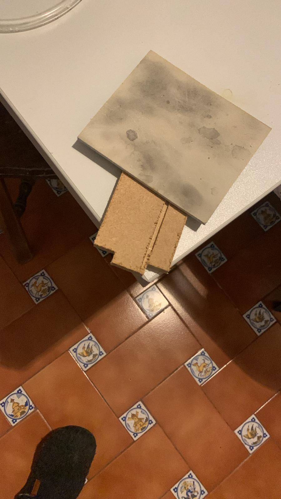

Step 4: Building the Bartop
Firstly, we divided all the boards into different pieces using squares and rulers. Afterwards, we cut them using a jigsaw and drilled some holes for the brackets. After much effort, all the pieces were obtained separately. We also made some room for the fan, the plug, and the switch on the back of the bartop, as well as a door in order to retrieve the coins inserted and be able to access the inside of the machine. For this purpose, this door is locked with a mailbox lock.
After cutting and preparing all the pieces, we primed each one to later paint them white. After allowing them to dry for some time, we assembled them. For this, we used brackets on the sides of the pieces, except for the bottom board, where we used glue instead due to the difficulty of tightening the nuts with the machine assembled, as this had to be the final piece.
