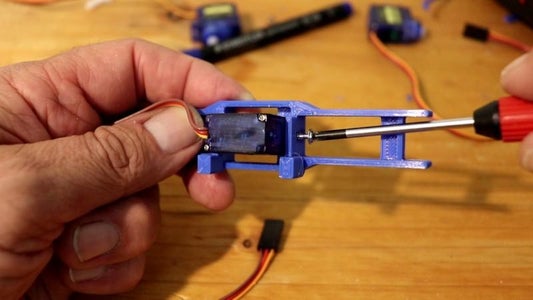

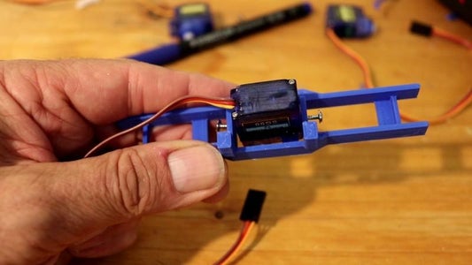

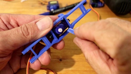

Step 1: Torso

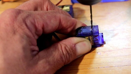

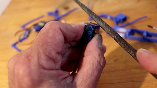

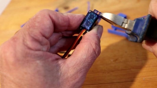

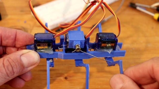

Remove the tabs of all servos with pliers/saw and file.

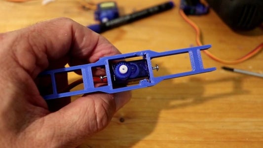

Print the chassis and fix servo 2 with two pointy screws as seen in the picture. The center servo should be able to swing. It also gets a little cap where to fix a screw later.
Fix servo 1 and 3 and the cap for servo 2 with hot glue.
Before mounting the legs, the servos must be centred! To do this, use the small program centerlegs.ino to set the servos to 90.

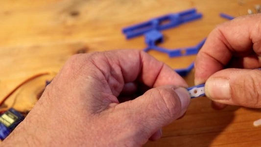

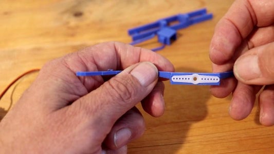

Step 2: Servos and Leg Parts

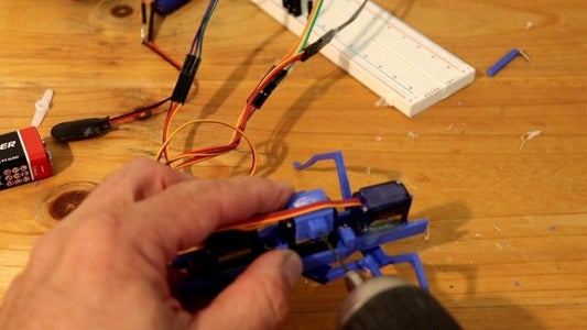

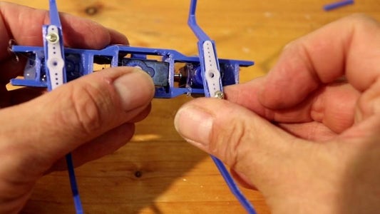

Each servo carries a leg pair, moving only a few degrees forward and backwards. Servo 1 and 3 move simultanously, so we could think about to use he same pin on the microcontroller for both.
Servo 2 moves in the opposite direction and should swing to bring the right traction of the legs to the ground. This swing is caused by servo 1 connected with a paperclip.
Print the legs and mount each to the servo. You may have to drill out the hole a little.

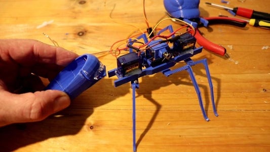

Step 3: Installing the Mechanics
Using screws and the paper clip, connect the mounting plate of the legs of servo 1 to the cap of servo 2. This should now tilt in rhythm with servo 1.

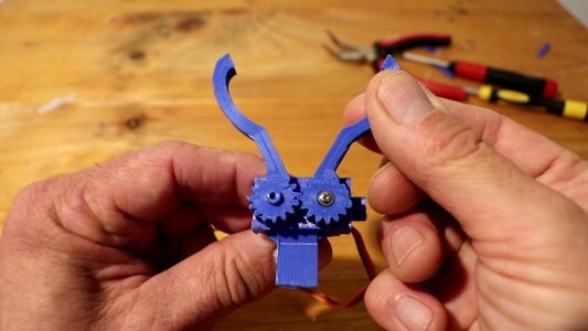

Step 4: Head and Gripper
The gripper is not really necessary, but it is a nice extra.
Insert the servo without arm into the frame. First set the servo to 90 ("centrelegs.ino" in Step2). Put the matching gripper part on the gear wheel and fix it with the servo screw. Then put the second part on the axis.

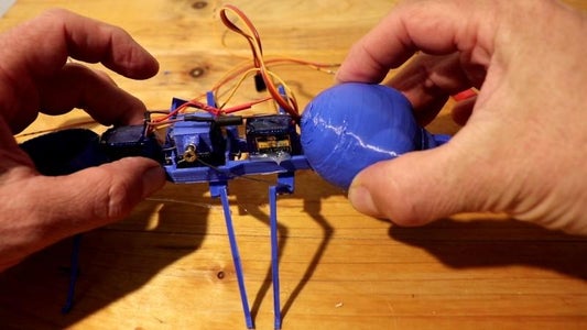

Glue the gripper upside down into the top of the head with hot glue and close the head. Put the head on the end of the torso and glue it.

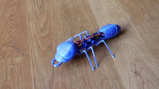

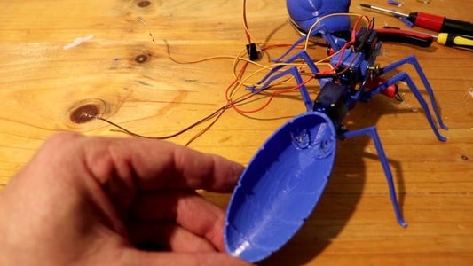

Step 5: Battery Tail
The lower rear part is also attached to the torso and glued. It will hold the battery and the microcontroler.

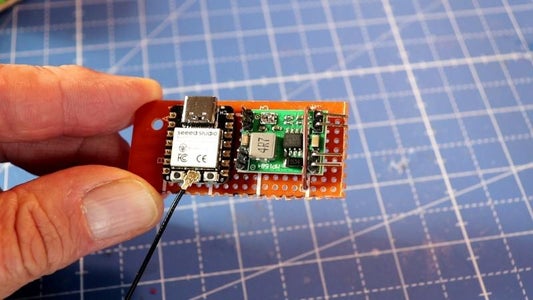

Step 6: Electronic and Software
The 9V battery supplies enough energy for the servos, but the voltage must be reduced to 5V by the buck converter.
The power supply for the four servos runs in parallel via 5V, the data wires are connected to the ESP32. More connections are not necessary. Additionally, sensors or LEDs could be attached.
The software "Blue_Ant-RemoteXY.ino " must be transferred to the ESp32. You can find information about this on Getting Started with ESP32-C3

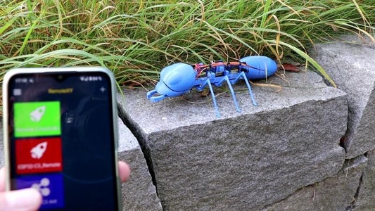

Step 7: RemoteXY Control
The remote comtrol is already included in the code (see marked code lines).
At https://remotexy.com/ you could create your own interface for the smartphone remote control and insert it into the programme "Blue_Ant-RemoteXY.ino". You can find more information in this tutorial:
https://www.instructables.com/RemoteXY-Editor-How-to-Control-DC-Motor-With-Smart/
The app for the smartphone is available here:
https://play.google.com/store/apps/details?id=com.shevauto.remotexy.free
https://apps.apple.com/us/app/remotexy/id1168130280
Install the app on your smartphone, activate Bluetooth, open "RemoteXY", search for and pair with
"ESP32-C3_Remote".
Step 8: Run!
Switch on Ant, wait a moment, activate App.
RUN !
