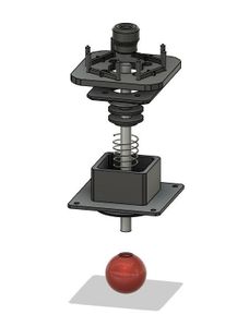

Step 1: CAD Design in Fusion360
I have attached my Fusion360 file as well as a step file for you to view and modify this model to your needs. There is an annotated image above as well as a cross section which should help you to understand how this mechanism is put together and the names of all the parts.
The way it works is there is a main metal shaft with 2 printed disks on it. One holds the spring in place whilst the other holds a washer which helps to prevent plastic-on-plastic grinding when it is pushed against the restrictor plate by the spring. The restrictor plate is what defines the type of motion of the joystick by restricting its movement. The main body conceals the disks and the spring whilst applying a compression force against the spring. The main body is bolted flush against the restrictor plate. Additionally, a switch plate is bolted on, which holds the switches in place. An end stop is pushed onto the end of the shaft where the switches are located, the shape and orientation of this is very important and can be changed to adjust the sensitivity of movement. As the rod is moved around in a joystick movement the end knob pushes against the triggers of the limit switches. The remaining metal shaft is inserted into your electronics panel through a slightly oversized hole (the thicker your panel the larger the hole needs to be), then fastened with screws/bolts through the holes in the main body's flange. Then finally from the upside of the panel, you can add the dust cover and the ball knob. You can adjust the shaft length by pushing the entire shaft through the mechanism.
