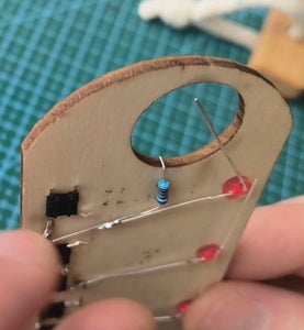

Step 2: Soldering the Buttons
Solder the buttons together the AND gate buttons should be in series, the OR should be in parallel and the NOT gate should connect to GND.
Step 3: Soldering the LEDS
Solder each of the leds the longer lead + should connect to the buttons as seen in the image, the shorter legs - should connect from each led the last one should stick out over the battery hole.
Step 4: Solder the Resistor.
We add one resistor to act like a jumper wire and to make the leds not so bright the end of the resistor should bend into the battery hole to connect the + of the battery. Join another wire to the last button for the NOT gate and your finished.
Step 5: Add Battery and Done
Add a coin CR2032 battery and you are done! when you push the back wire onto the battery the NOT gate will light up if you push each of the buttons the corresponding logics will be displayed.
