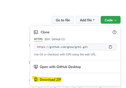

Step 1: Download Latest GRBL
Download GRBL from here, by clicking on code->Download ZIP
https://github.com/gnea/grbl
Download that zip, unzip it.

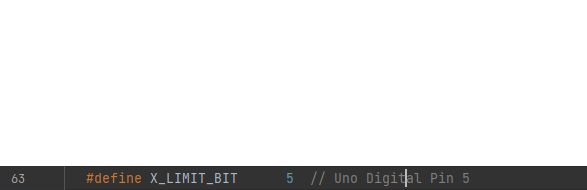

Step 3: Editing Config File
Now we need to tell the board, to swap the ports. I am gonna use X-limit-switch pin, to act as a probe from now on.
Somewhere in the file, around line 63, there should be
#define X_LIMIT_BIT      1
Change it to
#define X_LIMIT_BIT      5
Next, line 93 (or somewhere around it, that depends on version of GRBL)
  #define PROBE_DDR       DDRC
  #define PROBE_PIN       PINC
  #define PROBE_PORT      PORTC
  #define PROBE_BIT       5  // Uno Analog Pin 5
Change to
  #define PROBE_DDR       DDRB
  #define PROBE_PIN       PINB
  #define PROBE_PORT      PORTB
  #define PROBE_BIT       1  // Uno Analog Pin 9
Don't forget to save the file :-).

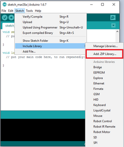

Step 4: Upload GRBL
Open your Arduino IDE and in Sketch>Include library>add .ZIP library
Choose your grbl folder (not the grbl-master!). After successfully adding library, go to
File>Examples>grbl>grblUpload
Connect your CNC and hit Upload. Make sure you have the right port and as a board "Arduino Uno".
If this does not work, instead of Arduino uno, select "Arduino pro or pro mini" (this was my case).
