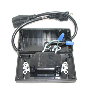

Step 7: Drill Enclosure for Extension Wire
The next step is to drill two 3/8” diameter holes in the sides, near the bottom of the case. Because the extension is a thick wire, I positioned the holes at a diagonal on opposite sides of the case. Then I passed one end of the extension wire through each hole.
Step 8: Wire the Extension
Once the extension ends are passed through the holes, we connect the two ends of the ground wires from each half of the extension together and twist a wire nut on top to secure the connection.

Step 10: Wire the Timer
You can wire the Timer using either the hot wires or the neutral wires to the Timer, and it will function properly.
Step 11: Connecting Wires to Timer
Connect wires to Timer
The Timer has two holes for the wire on the corners of the Timer, line, and load.
First, strip the insulation off the ends of the wire by 3/8”.
Insert the bare wire into the hole, then put the screw terminal in and lock down the wire. See the picture below.

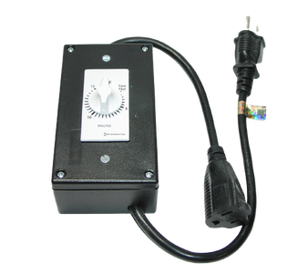

Step 12: Putting It All Together
Mount the Timer to the front of the enclosure using the two screws.
Step 13: Usage
To test the device, plug in a lamp. Turn on the lamp.
Plug the Timer’s plug into a 120 VAC socket.
Unplug the lamp from the socket and plug it into the receptacle on the Timer. The lamp should remain off, until you rotate the Timer know. Rotate the Timer knob for approximately 5 minutes. The light should turn on and remain on until the timer times out. None of the Amazon links are affiliate links. I have no financial interest or gain if you purchase any of these components. Parts List:
