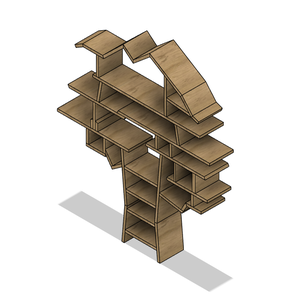

Our first Idea was to have a bookshelf that looked like a tree with hanging bookshelves coming from the branches (like playground swings). But this proved to be difficult in practice. We thought about doing a hexagonal design with little cubbies for your books. However, this had looked too simple and we wanted to do something more complex. We finally landed on the idea of the tree with many cubbies for your books and it looks very nice.
Step 2: Designing the Book Shelf

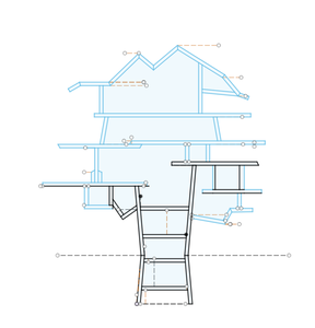

When we designed our Ideas we chose to base our project on a picture we found online. Firstly we sketched out a basic picture of the finished product. This would give an idea of what the product would look like. After that, we went to Fusion 360 to get the specific measurements of all our wood pieces.
 Once we had finished making the bookshelf in Fusion we labeled all our pieces with letters and numbers to make it easier to assemble after we cut our pieces. After we labeled the pieces we then wrote in all the measurements of the pieces and the angles in our engineering notebooks so that we could cut the wood with our specific measurements.
