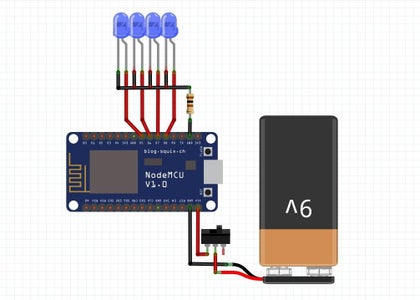

Step 1: The Electronics
For the electronics, we need a wifi-enabled Arduino and a few LEDs. The Arduino searches for WiFi networks in the surrounding area. Depending on the number of wifi networks, the LEDs start to light up. The strength of the wifi connection is not measured.
I use blue LEDs with a clear body. This way they are a little camouflaged later in the plastic foil of the "crystal".
The + connections of the LEDs are connected to pins D5-D8 on a NodeMCU Amica. The - poles run to ground via a 100 Ohm resistor.
Alternative: If you give each LED its own resistor, the light will remain the same brightness, no matter how many LEDs are on.
For a quick fixing of the wires, I used a wire winder. This wraps the cables tightly around the connections. In addition, I fixed the whole thing with heat-shrink tubing.
The LEDs are sanded a little with fine sandpaper so that the light becomes more diffuse and is better spread in the plastic film.
(Of course, you can connect more LEDs. You just have to change/extend the software slightly.)

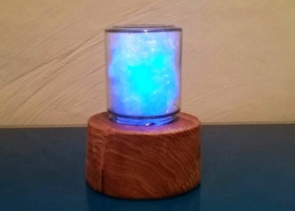

Step 3: The Crystal
The crystal consists of a jam/cucumber/olive jar and heavily crumpled gift wrap.
Wrap each LED in a little foil and then add another layer. Put the package in the jar and make sure it is filled well.
Step 4: The Base
I made the base of the crystal out of oak wood. But you can also make it out of clay, Fimo modelling clay, plaster or plastic. The main thing is to have room for the Arduino and battery. The switch is attached to the underside in a small drill hole.
If necessary, fix everything a little with hot glue.

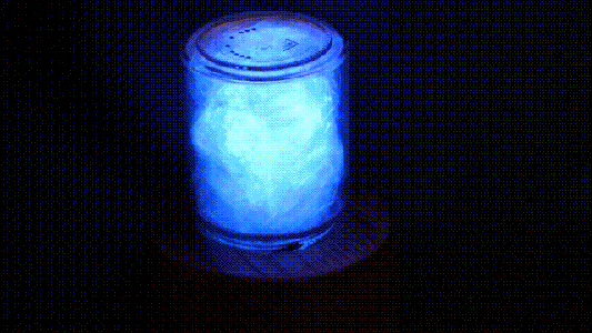

Step 5: Finished and Beautiful
Step 6: Discover ...
And then...
... your crystal will show you when there is evil wifi nearby.
