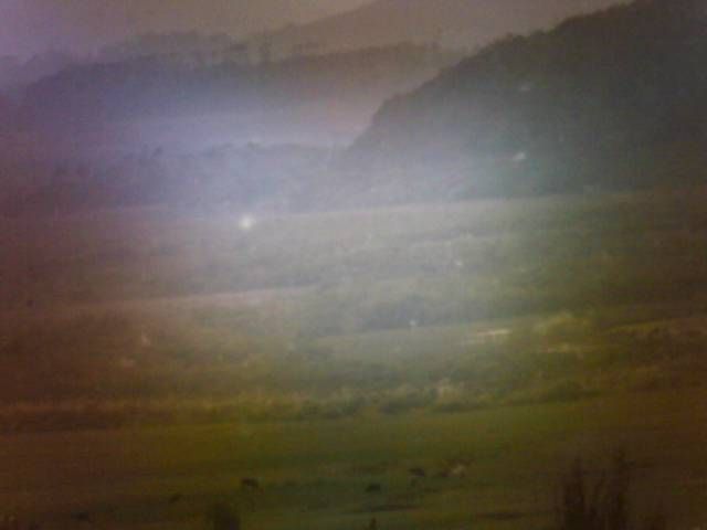

Step 4: Demonstration 1: Weather Station
These pictures show the weatherstation on my neighbors house. The first picture is made with my normal photo camera without zooming. The circle shows what the telescope is aimed at. The second and third picture are made with the telescope at 100mm and 210mm zoom setting.
Step 5: Demonstration 2: Antenna Mast at 450m
The first picture is made with my normal camera again. The antenna mast is in the circle. It's 450m away, I checked this with my gps. The second picture is with the telescope at maximum zoom.
Step 6: Demonstration 3: the Moon!
Here are 2 pictures of the moon.
You can easily see craters and mountains.
