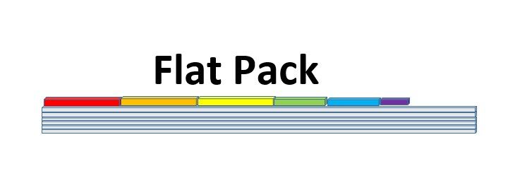

Introduction: 45 Minute Flat Pack Rainbow Bookshelf
This bookshelf is approximately 5 feet high, 6 feet long and 9" wide.
What's great about this shelf is it's super easy to do, looks great visually and packs up flat to an area of 6"x9"x72"! Even this could be made to disappear when you spread out the shelves under your bed mattress ;-)
I'm calling this the 45 minute bookshelf cause it's that easy! ( this is discounting the sanding and painting time!)
