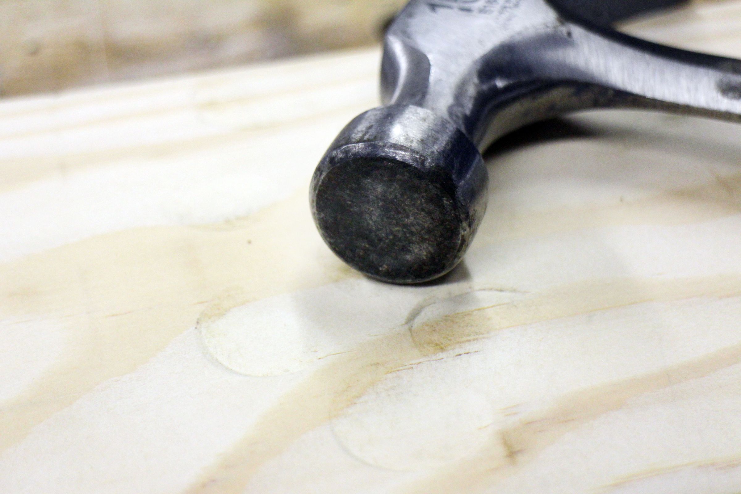

Hammerhead divots will add a dished depression.

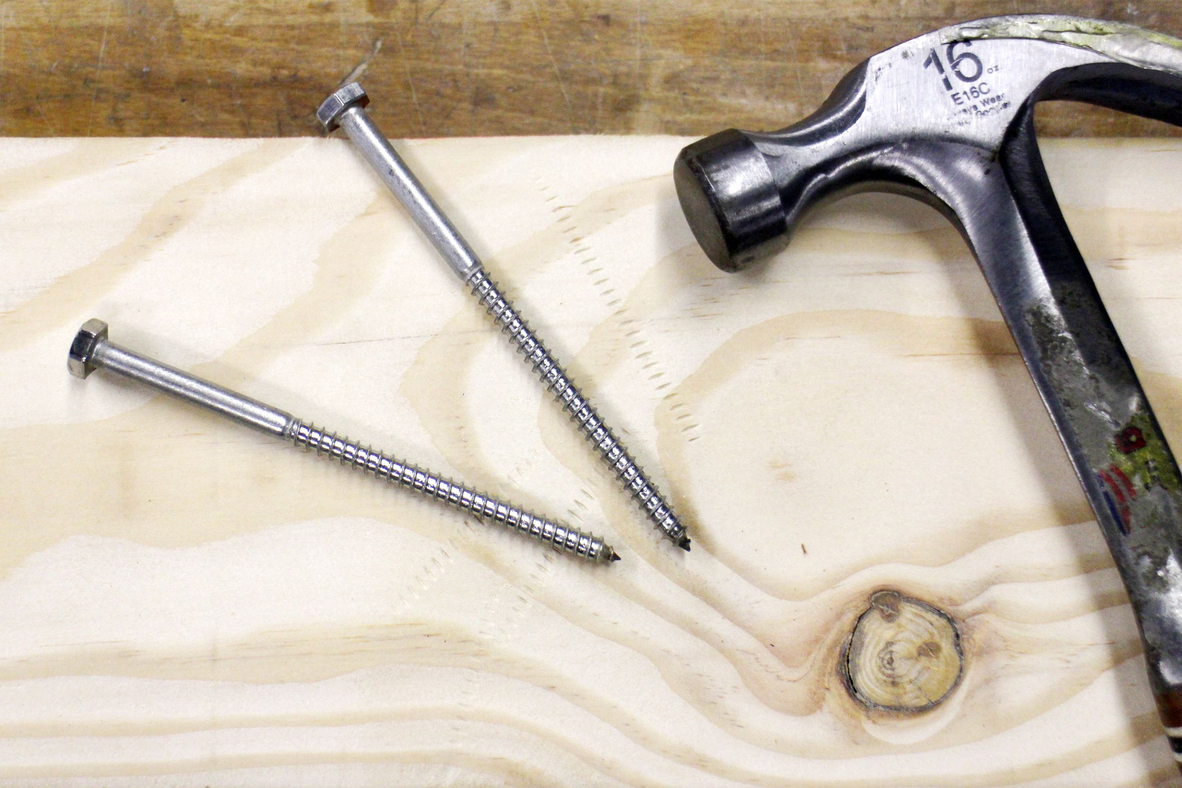

Threading from large screws leave an evenly spaced pattern.

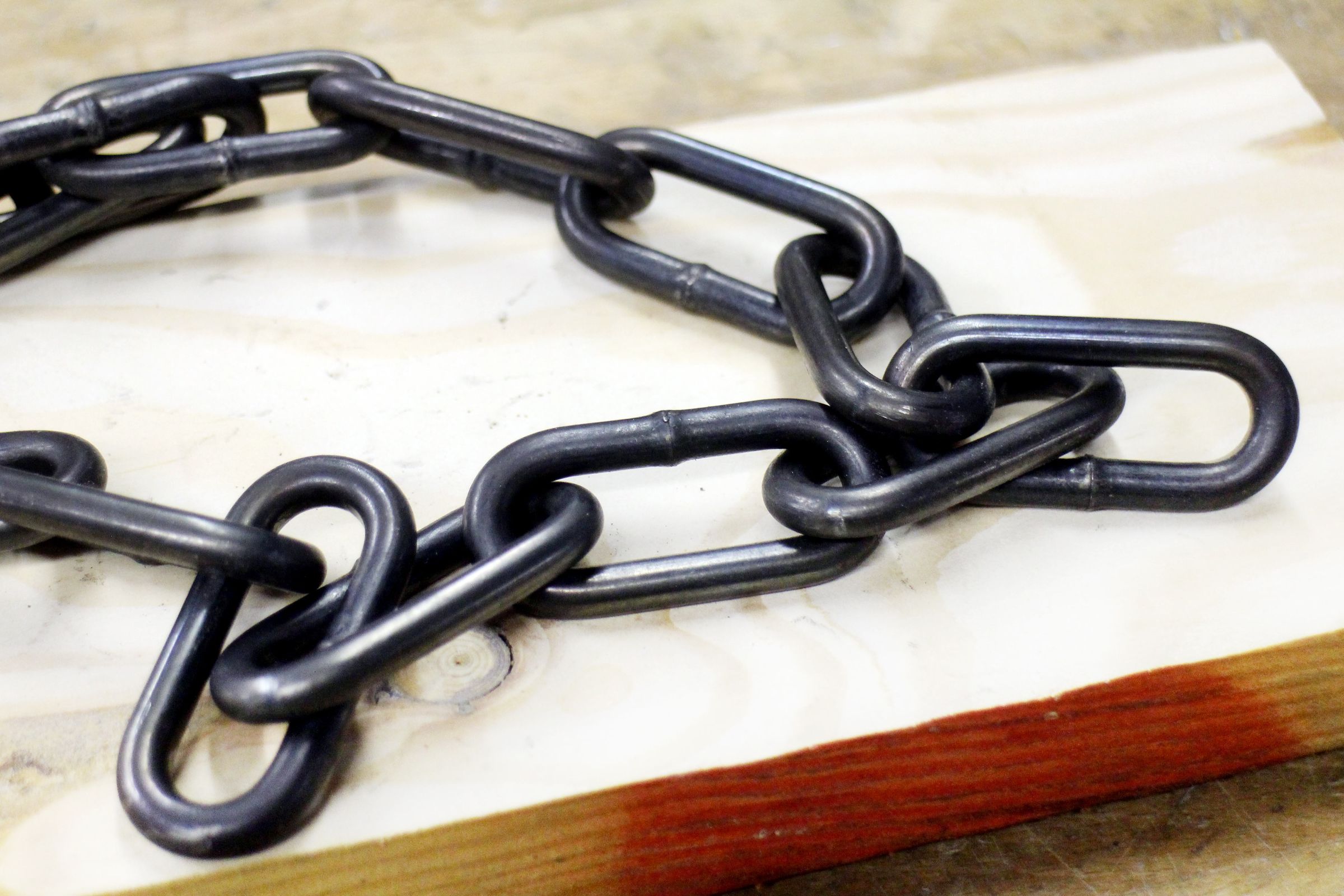

Steel chain can make irregular divots. greasy chains leave divots and some discoloration.

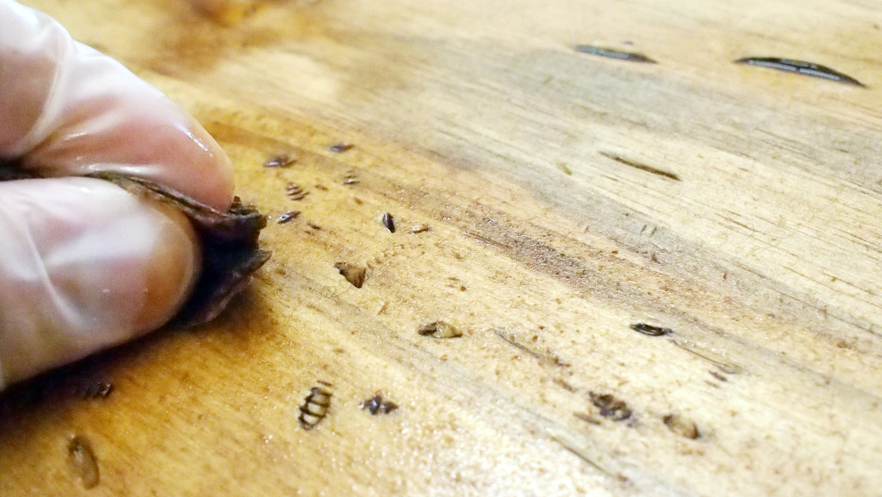

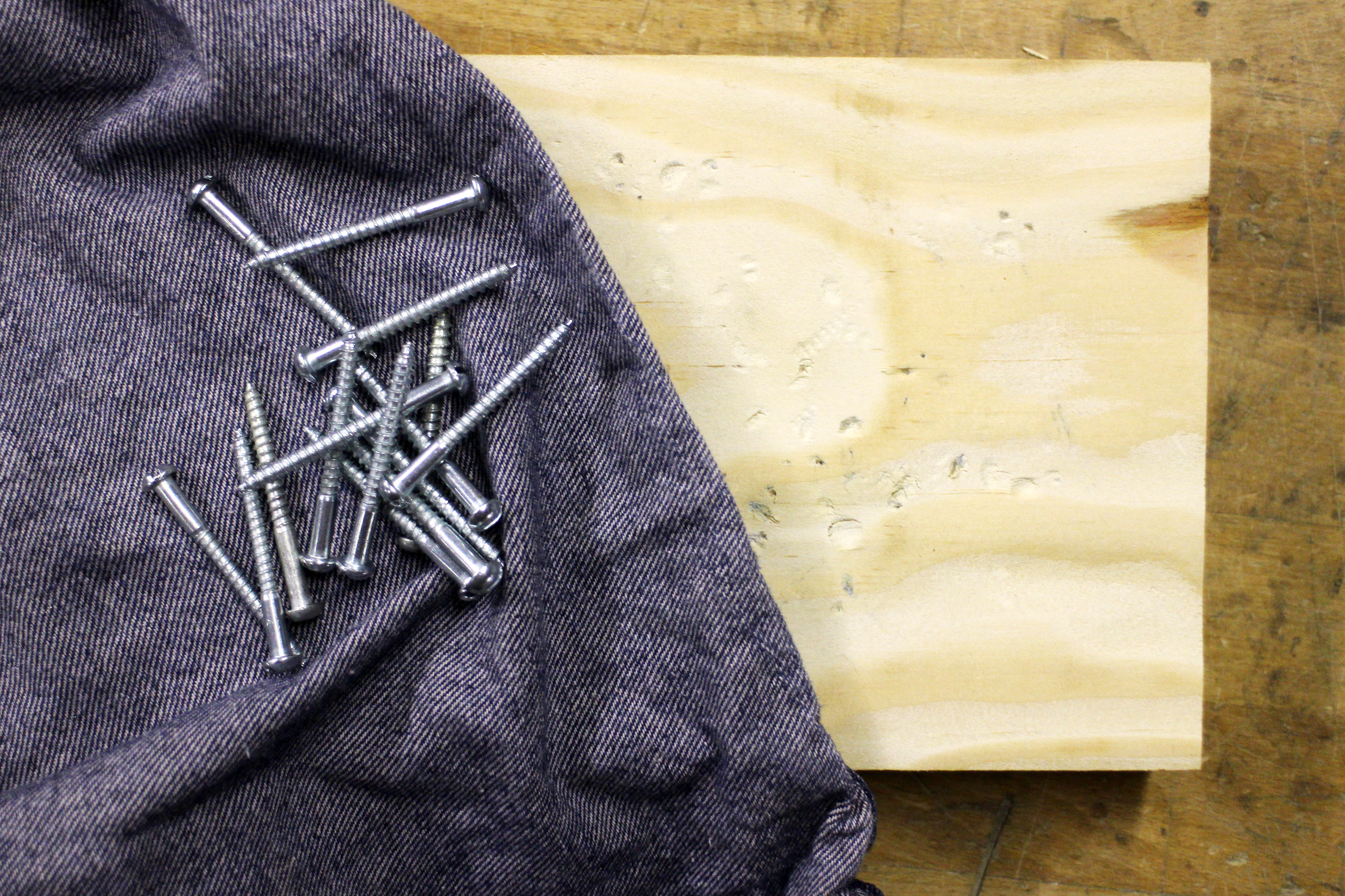

Placing a handful of nails into a shop rag and beating on the wood allows all kind of small indents to be made, rounded marks from the heads, spirals from the threads, and sharp pocks from the pointed ends. This is one of my favorites.
Of course, this is just what I had on hand. Experimenting with anything dense that has some shape or texture can provide pleasing results.

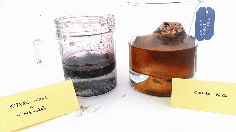

Tea staining is a chemical reaction between the bitter tannin from steeped tea and a mixture of iron acetate from the steel wool and vinegar to turn the wood a dark color.
Black tea is steeped and left to cool to room temperature. In a separate container, steel wool is submerged in vinegar and left for about 10 hours. When steel wool is combined with an acedic acid (vinegar) it causes the steel to oxidize (rust), making iron acetate.
When both solutions are ready, brush the tea onto the wood and allow it to soak in. Next, brush on the iron acetate solution and watch as the wood slowly begins to darken.

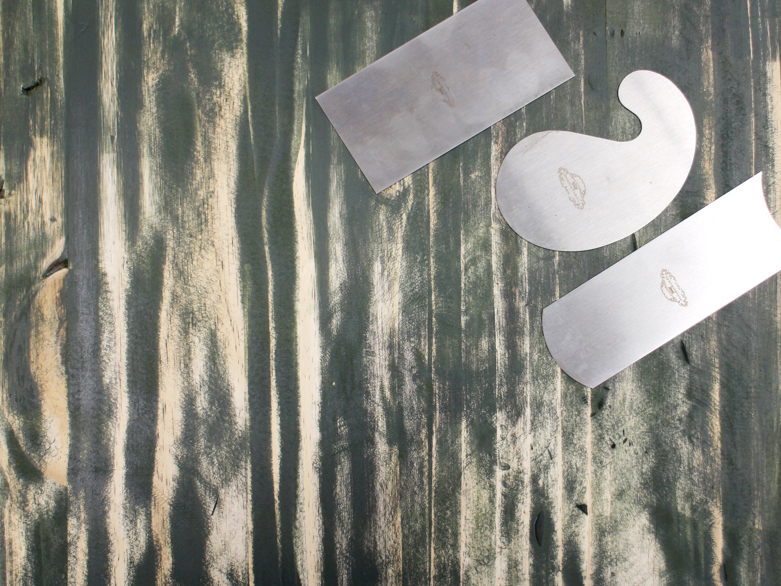

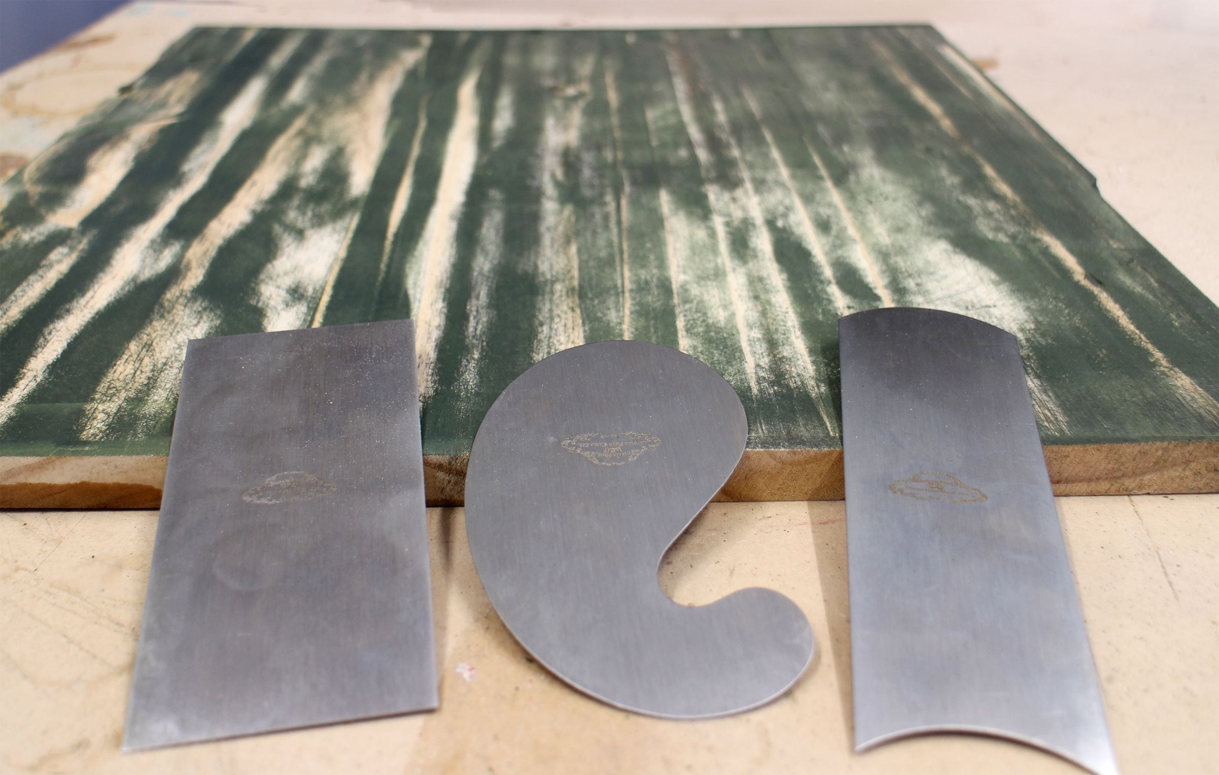

Using cabinet scrapers is a great way to get a faded look to painted wood without much effort.
These straight edged flat scrapers are used in woodwork to scrape and smooth the surface of wood, a common tool for cabinetmakers. However, they are put to good use for scraping off a painted wood panel to get a fatigued appearance without having to wait for the wood to naturally weather and remove the paint.
Cabinet scrapers come in a few different shapes, and are usually able to get into any spot you might need.
This set of 3 was under $20 and take up no room in my tool cabinet.
