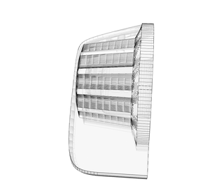

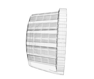

Step 3: Virtual Modeling
The next step was building a fairly detailed model, in scale, in my current 3d application.
Some of these parts were sent out to Shapeways to be 3d printed. The rest was built a little less detailed, as it was there to keep everything in proper scale, ensure it all fit together, and get an idea of what it would like like when completed.
