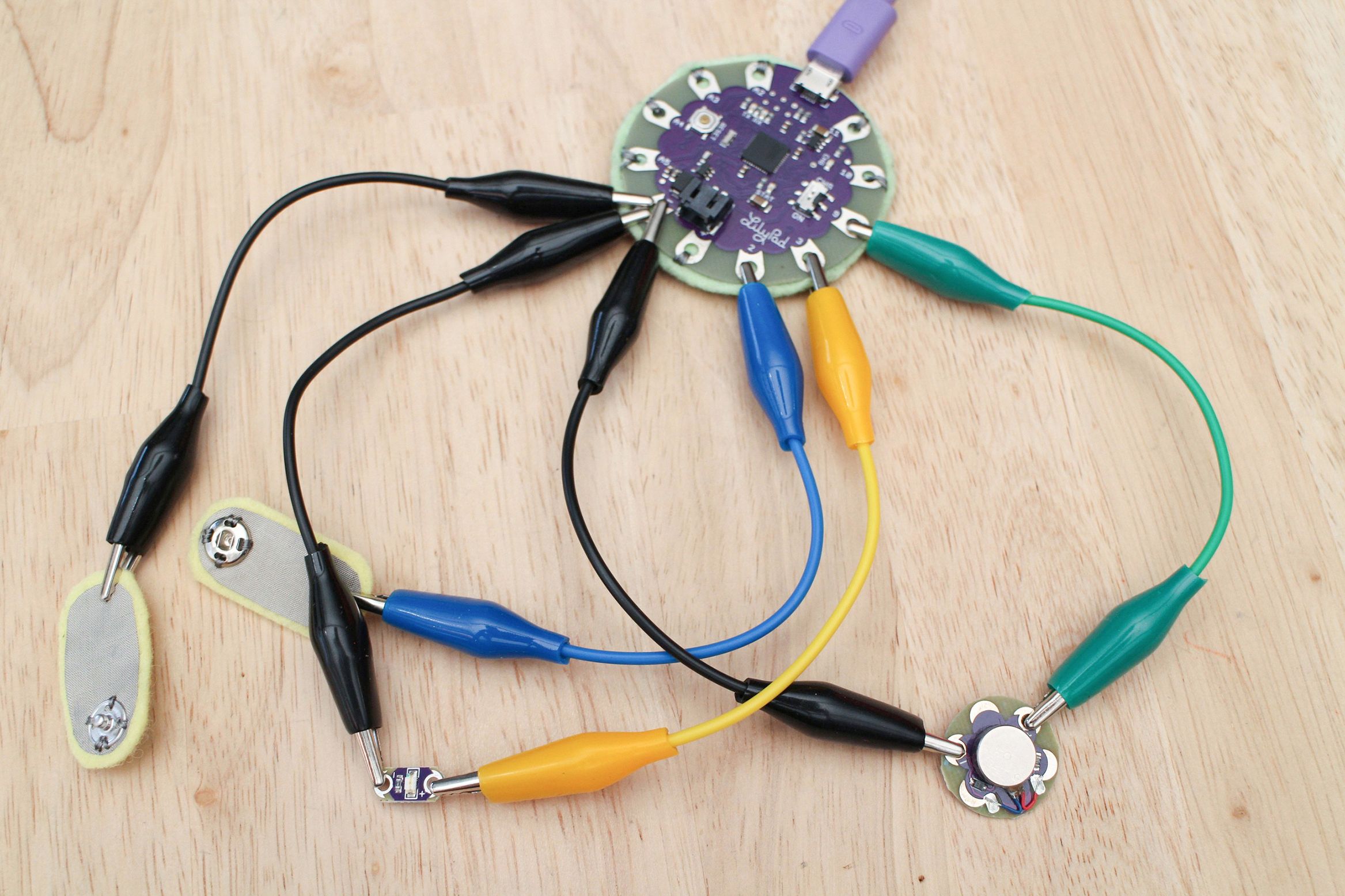

Step 7: Add Digital Input
Keep the LED on pin 3. Grab your snap switch, some alligator leads and make these connections:
switch --> pin 2
switch --> ground (-) LilyPad
Step 8: Upload
Open the FadeInputDemo sketch you downloaded at the beginning of this lesson and upload.

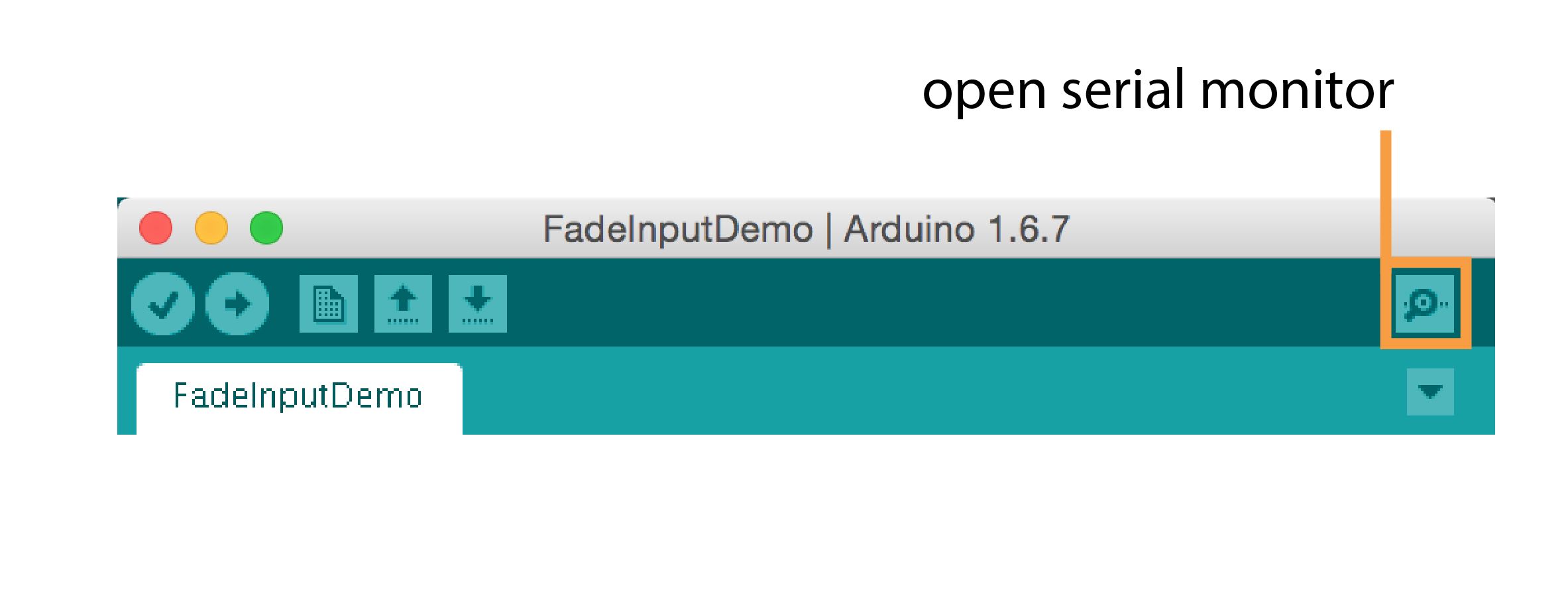

Open the serial monitor to watch the switch state print out. Snap the switch closed and the LED fades on and off. When the switch is open the LED stays off.

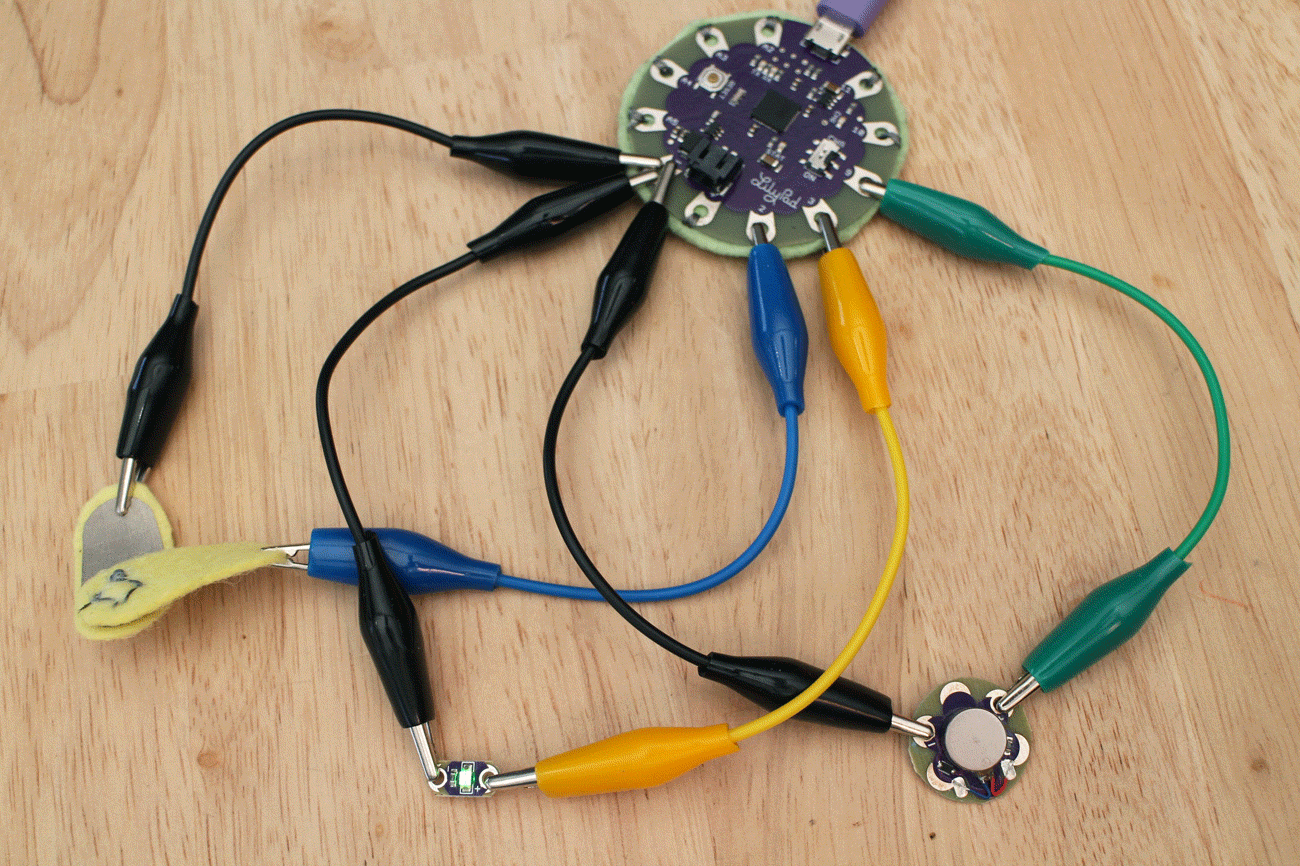

Step 10: Build Circuit
Make these connections:
switch --> pin 2
LED power (+) --> pin 3
LED ground (-) --> ground (-)
vibe board power (+) --> pin 9
vibe board ground (-) --> ground (-)

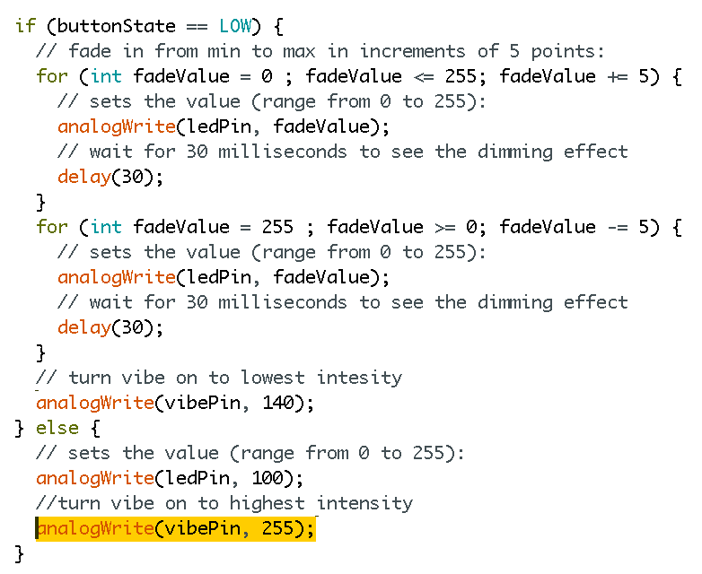

Call analogWrite() in the if/else statementand send the vibe board a value between 0 - 255. The vibe board needs a certain amount of voltage, so make sure the value you send it is 140 or above. Check out the image below to see where to put these two lines. They are highlighted so it's easier to see where they belong in the sketch. Double check to see where the curly brackets are!
analogWrite(vibePin, 140);
analogWrite(vibePin, 255);
Add line in between curly brackets of if portion of if/else statement.
Add line in between curly brackets of else portion of if/else statement.
Step 12: Upload
Upload the sketch. The LED will fade on and off when the switch is closed and the vibe board turns on at its lowest intensity. When the switch is open, the LED is off and the vibe board turns on at its highest intensity.
