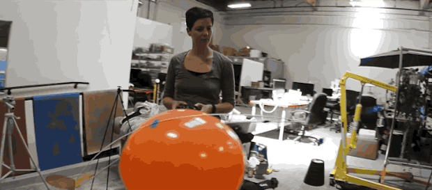

Step 4: Lift Systems
A simple lift system for a Battle Blimp can be nothing more than a latex or mylar balloon filled with helium from your local party store. Fly your blimp around and try to ram your friends.
The next level of destructive fun is to mount needles on your blimps (wear eye protection!) and pop opposing blimps. These indoor blimp battles can be lots of fun!
However, we believe that true blimp battles involve sending your friends down in flames, and for that we've ended up creating our own hydrogen gas envelopes. There are a couple reasons we did this. First, most balloon material is toxic to burn, and we intend to hold several hundred blimp battles. Second, many balloons (e.g. latex) hold gas under too much pressure, and our early tests have shown that igniting these can be dangerously loud (and also shoot flame directly back at the attacking blimp, which is less fun).
The material we settled on is corn-derived PLA bioplastic, which burns cleaner and is fully biodegradable. The photos above show our process: Using nichrome wire (similar to what is in your toaster oven), we created curved patterns taped down to plywood with high-temperature Kapton tape. Compost bags (or other PLA film) is folded and laid on top, and then we run current through the wire to heat it up and create a seal along the seams.
The resulting balloons hold air quite well for balloons that only need to survive for about 15 minutes at a time. The life expectancy of a Battle Blimp will likely be much shorter than this :P
