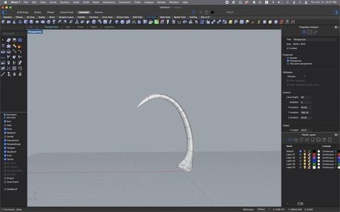

For the design of the skeleton, it's mainly about the ribs and the spines. We use subD for the construction of the spine unit and the first one rib. Then we duplicate the rib piece and alter them into ones with different angels and length.

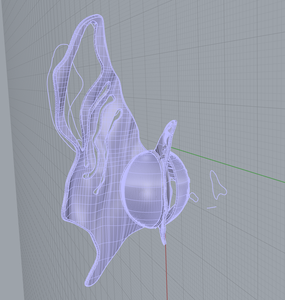

Step 5: Adjust Some Features of the Model With Meshmixer
Then we adjust some features of the heart shell in Meshmixer so that it could be directly attached to the inner machine.
We use the "Sculpt" tool to make the connection part more smooth.
