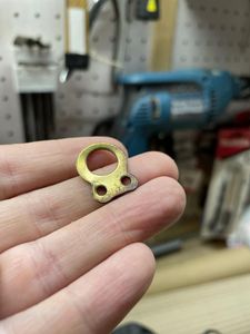

NOTE: To hang the painting on the wall, I have designed a 3d printed heyhole hanger. In that case, the 3d printer is necessary to print the piece and a CNC or a manual milling machine to carve the wood to place the plastic piece. Alternatively you can hang the painting in another way (without printer 3d and CNC). There are a variety of keyhole hangers, most of them metal, that can be obtained and glued to wood with epoxy cement. The traditional cable system can also be used.

To hang the painting on the wall, I have designed a 3d printed a heyhole hanger. In the back it is previously planned made a milling of the MDF to install it (see photo 10 and 11). Alternatively you can hang the painting in another way (without the need for the 3d printer and milling the MDF). There are a variety of keyhole hangers, most of them metal, that can be obtained and glued to wood with epoxy cement. The traditional cable system can also be used (see photo 11).

- Place the plastic hang holder piece (printed in 3d) in the previously milled space, fixing it with screws, or alternatively, place your chosen hanging system.

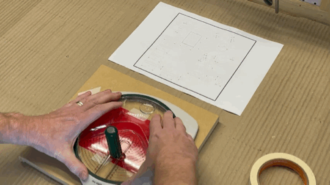

To cut the vinyl you can send to a store for vinyl, but In this instructable I will teach how to do it manually !! :)
For that you must use templates to cut the vinyl.
I have included a big bird CUT TEMPLATE.pdf and small bird CUT TEMPLATE.pdf to print in A4 paper.
There is also a plane with dimensions of the parts that make up the figure, if necessary: figure dimensions.pdf
This plans must be printed in its original size. Don´t set “Reduce to Printer Margins” at “Page Scalling”.
Cut a piece of vinyl and place the paper cutout (template) on top of it. Tape firmly these to a piece of auxiliary MDF, then proceed to cut using a knife pen (cutter) (photo 1,4 y 5) or similar and metal ruler.
To cut, press the line to be cut with a metal ruler and press the assembly with one of your hands, then with the other, firmly press the cutter in order to make correct cuts.
You should always cut to the line so that the black line just barely disappeears.
In the case of circles you can also use cutting tools as in the photo 2.

- With a 3d printer print the keyhole hanger (plastic keyhole hanger.stl) and install with wooden screws Ø2x10 mm in the carving done previously. The latter will not be necessary if you choose a different wall mounting system. (Photo 26)
