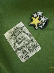

Foam and/or rubber stamps

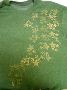

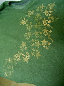

Step 3: Stamping
Stamp the sweatshirt to your liking. Use stamps with larger details, these will stamp better. Stamps with fine details my lose those details when stamping.

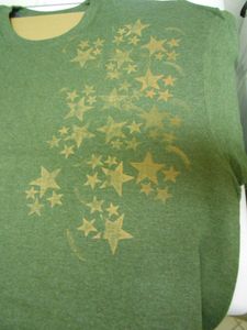

The bleach will not be visible on the stamp or at first on the sweatshirt. The sweatshirt will begin to process the bleach and the design will begin to show. The color that develops will contrast the original color of the sweatshirt. You can do a test dot of bleach on the inside of the sweatshirt, if you wish to see the final color result.
Once you are done stamping, let the garment dry and develop.
Step 4: Finishing Your Garment.
Once bleach has dried, wash the sweatshirt by hand or in a washing machine, to get rid of any excess bleach.
Dry and enjoy!!
