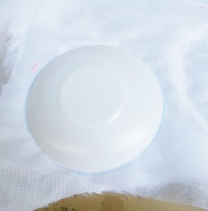

To make the tail, just place a tea saucer on the feathery fabric as template. Draw and cut
Sew the edges so it would not fray. Now do a running stitch around and gather it. Fill it with wadding/ batting.
Pull thread tight and close the opening. Tack it close.
