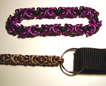

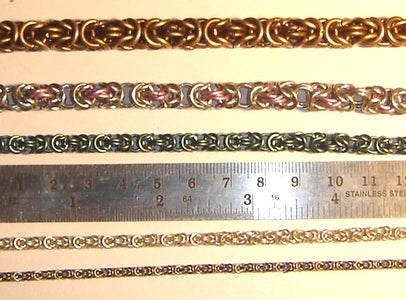

Ring size: I frequently use 18ga aluminum wire with 3/16" interior diameter as a good medium ring size. You can go with larger or smaller rings, though the wire-to-ID ratio needs to be within a certain range to produce aesthetically pleasing results. A small wire size with large ID will result in a rather... anemic looking weave, and a thick wire with small ID will be too tight to work with.
See the photo? The IDs are all the same, but the thicker wire looks better. Be careful not to go too thick, though--the weave will get too tight to construct.

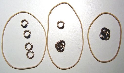

I much prefer to prepare my rings before I start weaving. I figure out how many open rings I need and now many closed rings (I calculate a ratio), and then I start weaving. When I run out, I prepare more rings in the appropriate ratio.
For this method of Byzantine weave, you want 4 open rings per 2 closed rings. These rings will be made into 1 unit of 2x2 for every 2 open rings. Let me explain:
Take one open ring and slip two closed rings on it. Close the open ring.
Take a second open ring, and slip the same two closed rings upon it. Close the open ring.
You should end up with a set of four rings where every ring goes through two other rings, no more and no less.
Once you prepare your 4:2 ratio of rings, you will be left with 2 open rings per 2x2 unit.

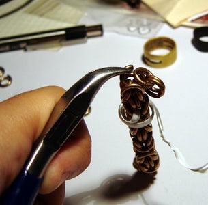

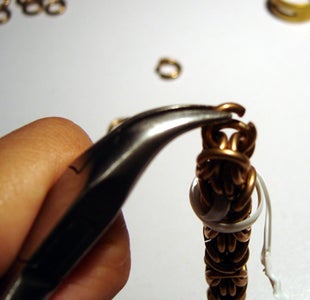

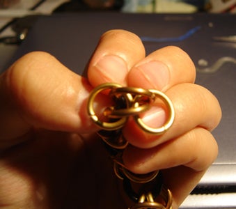

You will attach your two rings to pair C, but pair B will flank your connecting ring: see photo! The open/connecting rings you attach in this step can be called pair D, but you'll see that they're actually a second iteration of pair A.
Before you close this new ring, put on a 2x2 unit! Now you can close the ring.
Now give it a partner ring. Make sure that this newest open ring goes through pair C, and the 2x2 unit as well.
This step sound really difficult and convoluted, but once you actually hook your ring onto pair C (between the legs of pair B), things fall into place. I promise.
But now, all you need to do to continue is to flop the outer most pair of rings on your newest 2x2 unit, use two open rings and attach another unit of 2x2!

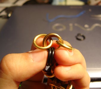

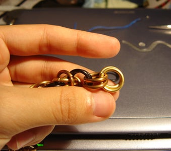

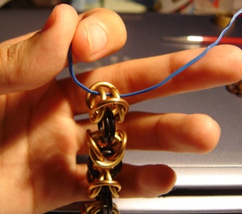

Alright, here's a break down of what's happening in the video clip v.2:
- 2x2 units are constructed 2 copper + 2 gold. (It's hard to tell the color, but I consistently place new 2x2s so that the gold rings are the ones sticking out at the end.)
- Open rings that will be used as connectors are black.
- Black/open rings connect copper to gold.
- I point out where the black ring attaches to the gold rings by use of the bright blue twist-tie.
Whenever I finish adding a 2x2, the rings at the end are gold. My next open (black) ring hooks on to these gold rings, but watch how the rings have to be flipped first and then attached from between the copper rings of the 2x2 unit. (Or refer to photo set.)

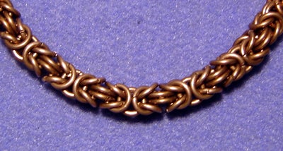

Note! The photos show 16ga bronze 3/16" rings. I really don't advise it--the rings were very stiff to work with in close quarters. The video shows 18ga bronze 3/16".

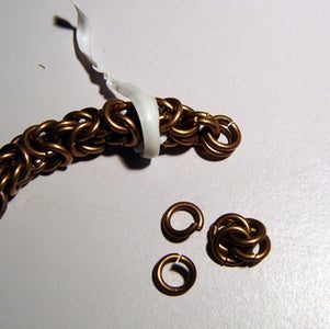

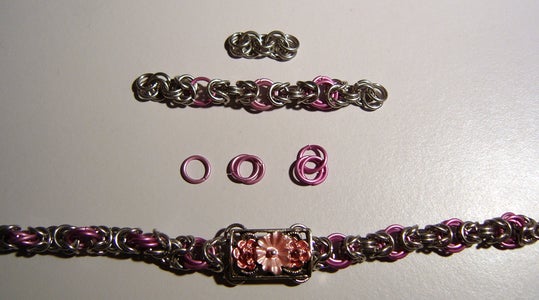

If you use a looser ring, you can actually prepare 2x2x2x2x2 units! (To prepare for those, have opened/closed rings in a 4:6 ratio.)
To attach these you need a pair of open rings, and you need to do the bizarre flopping thing before you hook the open ring onto your 2x2x2x2x2 unit. Close the ring, and give it a partner ring.
Now you grab the final rings on the 2x2x2x2x2 unit, and flop 'em. Grab an open ring, hook it on (just like step 3), toss on a new 2x2x2x2x2 unit. Close the ring, give it a partner and... repeat.
Rosettes (or "mobius balls") are a great embellishment to use with Byzantine.
When you attach open rings, just make sure to cross them.
Thread the second open ring through the first, you'd get a (slightly wimpy) rosette. You'd best add a third ring, making sure that it passes through the previous two. And possibly a fourth, fifth, etc.
I find that 3-4 is the optimal number, and I usually attach rosettes between units of 2x2x2x2x2 (rather than units of 2x2), so that they're not overwhelming the weave.
You can use a different ring size, color, material, etc. with your rosettes!
