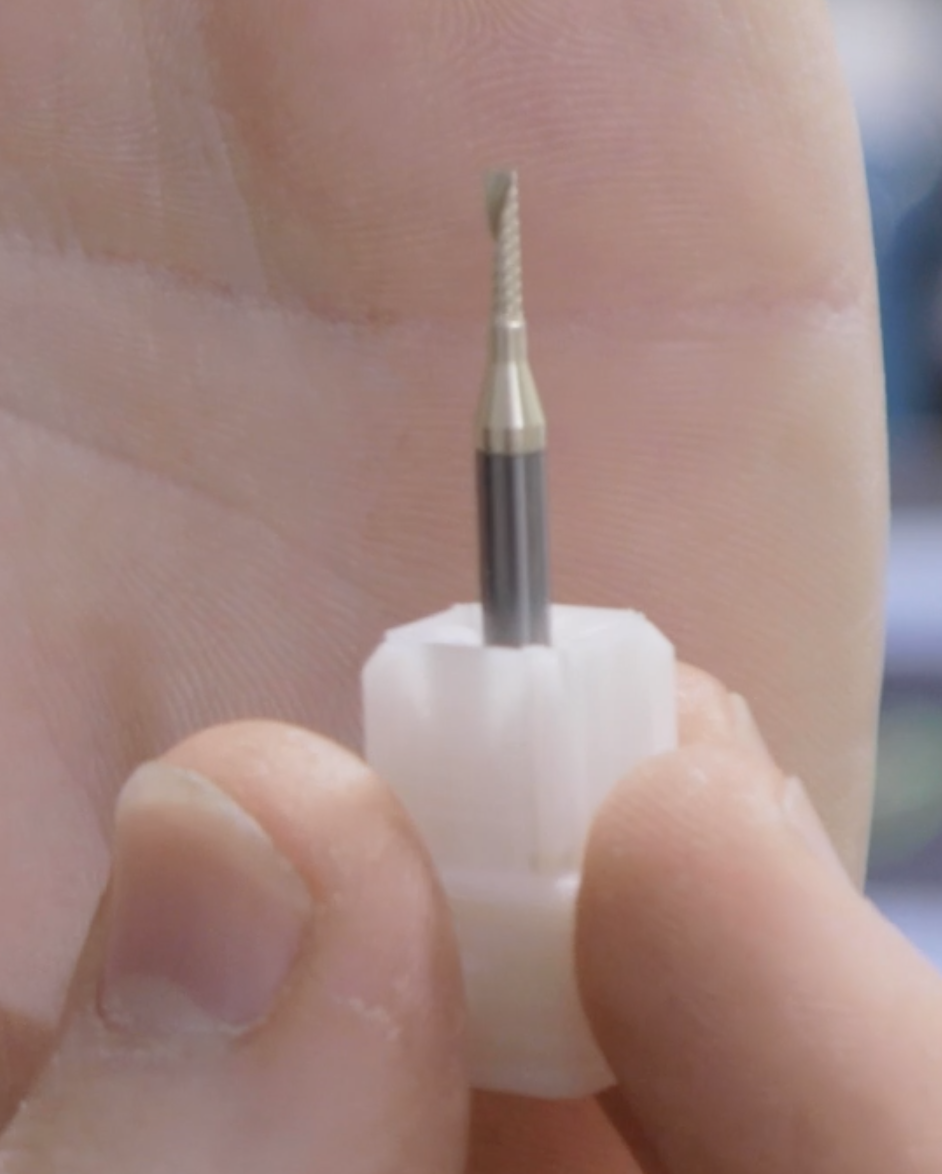

Andrew designed this entirely flat, though Fusion's sheet metal design features may take some of the guess work out of this process. Initially we designed this to use 1/16" end mills, but the machine speed (or lack of) and the fragility of that tooling made this difficult. Andrew adapted his design to allow us to machine with an inexpensive 1/8" o-flute end mill, and that did the trick for us.

Special thanks to our friend Winston Moy, who helped us with our CAM recipe. We found a spindle speed of 22000 RPM, feed rate of 70IPM and a .01" DoC with a 1/8" O-Flute carbide end mill worked great for us. We also used WD-40 and air to help keep the router bit cool and capture some of the aluminum shavings while machining. The aluminum was fixed to a piece of MDF with blue tape and Super 77 adhesive - other workholding solutions will probably be just fine.
