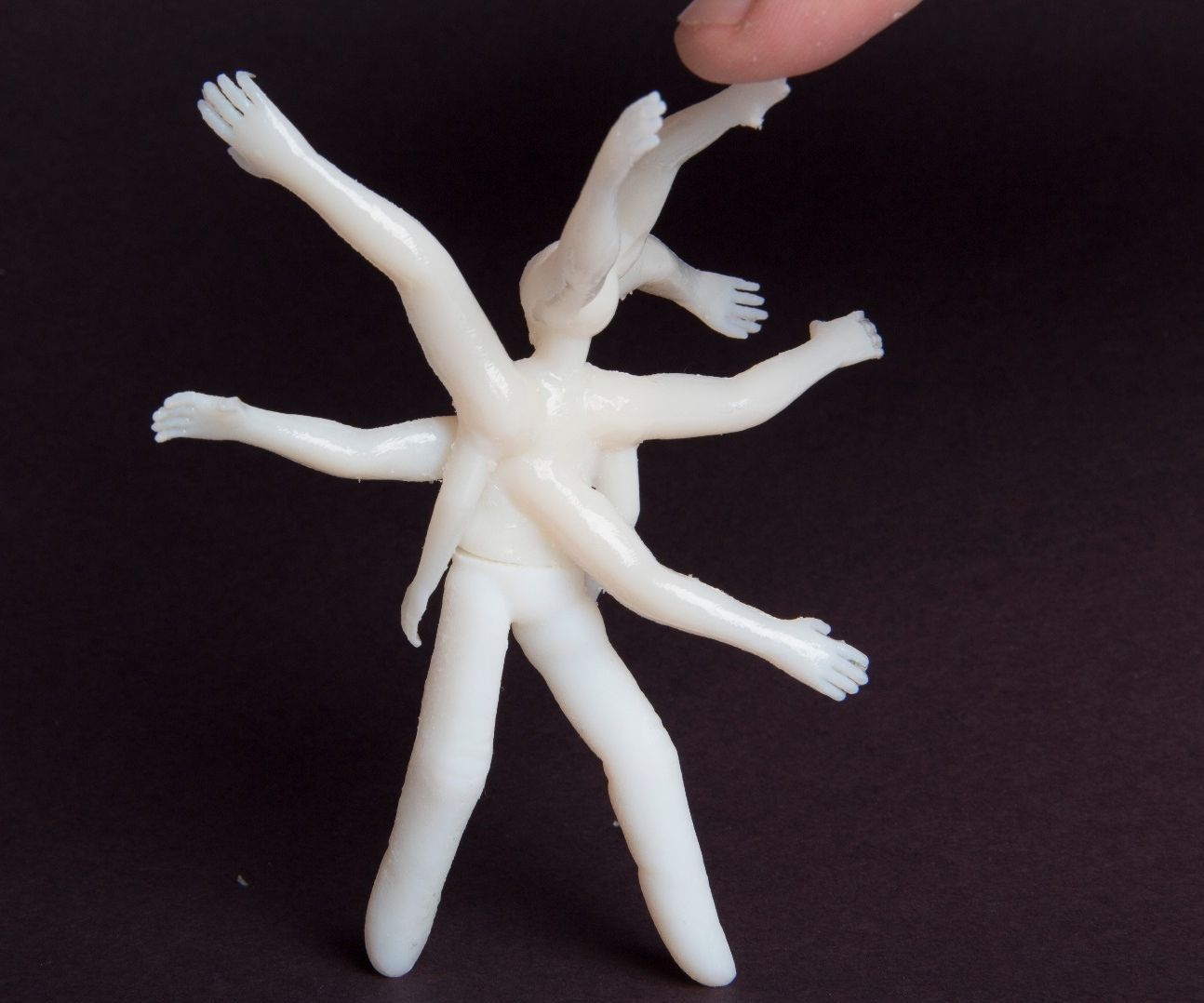

The need for these strategies came about as the result of the culmination of research I was conducting as an artist in residence at the Autodesk Pier 9 workshop. I began looking for new relationships between parts in assemblies and developed a series of prototype joints. Perhaps the most exciting among these studies was a series of entangled shapes sliced by an auger or helical surface, allowing the resulting parts to essentially be unscrewed from each other.
I set out to produce a version of this idea at a larger scale, roughly the size of the human body, in order to face the challenges that fabrication would pose - specifically limits of material and tooling. Images show the parts, essentially overlapping rounded cone shapes, as they were developed in Fusion 360. This assembly tests a hybrid joining system where the two bodies are sliced by the auger shape and also have geometry for a sort of friction fit 2 way ball joint.
For the large scale prototypes I chose a hybrid of CNC milled MDF for the helical surfaces and aluminum ribs and sheet for the more primitive cone shapes. There is also a bit of steel and rubber for the spherical details. In the plus column, MDF is fairly cheap compared to, say, tooling foam, machines well enough, and is rigid enough to hold together as these shapes often taper from thick to narrow sections. On the down side, MDF is quite porous, heavy, and the dust produced while machining is more like a smoke that gently floats in the air...so dust collection is key. Not to mention the potentially hazardous chemicals, namely formaldehyde, used to bond the wood particles into MDF. Here I was sure to use the 'low formaldehyde' edition.
