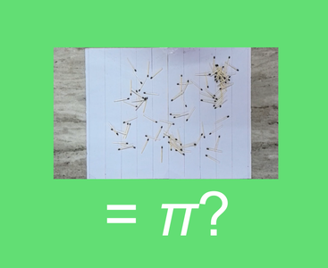

Step 3: Drop and Count
  • Drop the matchsticks from few inches above. Make sure of the following:
  • Try to minimize overlapping of the sticks so counting becomes manageable.
  • Dont throw/roll along paper as it may roll the sticks and give biased results due to alignment.
  • Collect the matchsticks as: crossing the lines at one side vs Not crossing on the other side.
  • Count the matchsticks. In the video, Crossing=55 nos, Not crossing= 33 nos
  • Value of Pi calculated= 2*(total matchsticks)/(Crossing numbers)= 2*88/55=3.2.
  • Actual Value=3.14. (Error= 1.9%)
  • You can do multiple tests, I did and found the values could be varying within +-0.5 (from 2.64 to 3.64) .The more you do the tests, closer your average gets to 3.14.

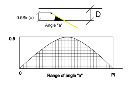

  • Say the matchsticks are of unit length 1. And a matchstick is at an angle "a" from parallel lines.
  • Then we plot the distance in Y axis from 0 to 0.5 and rotation at X axis from 0 to "pi".
  • The portion which shows overlap of matchstick with parallel lines, is shown in chequered area.

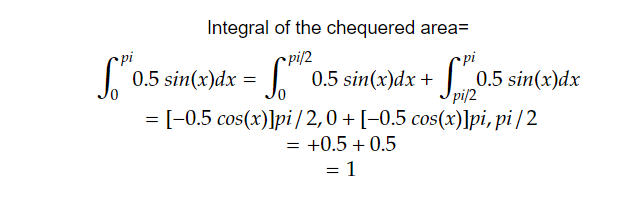

  • Find the integral of the area =1: see image (writing equation courtesy "mathcha.io online editor")
  • Integral of the rectangular area is 0.5Pi
  • Hence, the probability of overlap=1/(0.5*Pi) =2/Pi
  • From this equation, overlap/total=2/Pi.
  • So, Pi = 2*(total matchsticks)/(Overlap)
