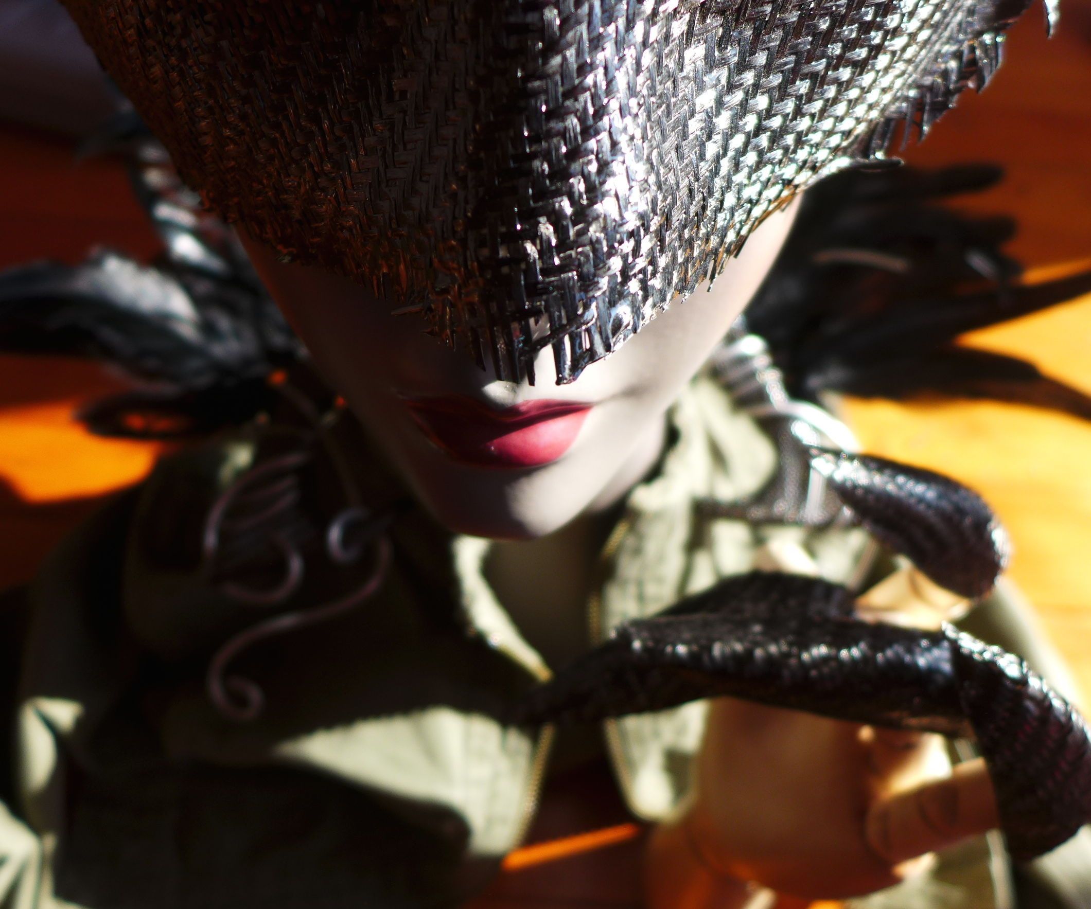

Step 1: Carve It Up
Go to your local woodshop and find some wood scraps. Then, using whatever method you prefer, shape them into spikes – a bit smaller than how you'd like the end product to appear. (The layers on top will add 1-2mm of thickness.)
I chose a piece of 3/4" thick wood, and used a bandsaw to cut it into elongated diamonds.
Then, I used the disc-and-belt combo sander to shape each piece into a nice claw form: one longer, one shorter, one right in the middle.
I left the bottom flat, because these pieces will be sitting on a vacuum table in the next step. The bottom will be open in your end product.
Also, since you're going to be vacuum-forming these, try not to undercut: that is, try to make them completely convex in one direction. This prevents the wood piece from getting stuck in the plastic, and you'll get fewer unsightly issues.
Finally, try to make the slopes gentle wherever possible. Sharp angles are just a little more tricky to vacuum-form. Your edges will end up nice and pointy anyway.

Step 3: Suck It In
Now that you've given up on that fool's errand, arrange your nice new wooden spikes on the vacuum forming table (along with some other small bits and bobs, if you don't want to waste space).
Set them widely enough apart that you won't get "bridges" between them: Picture stretching a piece of fabric over two chairs. If you put the chairs far enough apart, the fabric can touch the floor between them. But if they're close together, the fabric has no room to drape. Although the vacuum table is specifically designed to prevent this problem, creases can form if there isn't enough space.
Since most wood is fairly porous, you shouldn't need to drill holes in the pieces. Still, try to set them in between the holes in the table, as much as possible. You want holes close to the edges, so that you get suction right next to the face of the object, but not underneath.
Then, flex your vacuum-forming skills! Turn on the heat and let the plastic sheet sit up under the heater until it sags down enough to properly seal in your objects. Then, lower the plastic and turn on your vacuum power! This sucks the plastic down onto the table, around your forms.

Step 5: CARBON FIBER!
Okay, I'm sure someone else has done a much better instructable on this than I could, but I'll touch on the process here.
Get some 2-Ton DevCon epoxy resin. Not the 5-minute stuff! You won't have enough work time, unless you're only doing one spike... which is kind of a waste.
You'll also need your carbon fiber fabric (coarser weaves are cheaper), scissors, GLOVES!, a disposable mixing cup, and stirring/spreading sticks.
Cut pieces of the fabric that cover your plastic forms, with enough to drape. Fortunately, this stuff is quite flexible, as long as you don't mind having little holes in some places where the fibers pull apart.
Mix the two parts of epoxy together, a couple of tablespoons each, in your mixing cup. Spread a thin layer over one plastic base, then smoosh the fabric onto/into it, then (if you need to) go over it again with another light layer of epoxy. This will make the surface nice and shiny!
Leave the forms to cure. Be careful: once the carbon fiber fabric dries, any raggedy spikes will actually become super dangerous. They can spike you really easily, and very painfully. Watch your fingers!
