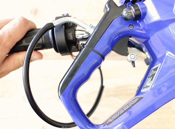

Step 23: Motorcycle Throttle
I chose to have the chainsaw operated mechanically with a motorcycle throttle cable. This throttle assembly is easily assembled: the knuckled end of the throttle cable is inserted through the mounting assembly and into the notched portion of the hand grip. The hand grip with the throttle cable can be installed onto the right-hand side of the handlebar, and then the throttle mount installed around the throttle hand grip.
After, the left-hand side grip can be pushed onto the handlebar.
Step 24: Throttle Cable Trim
The throttle cable is meant for a motorcycle and is about 4 feet long, much too long for our short distance.
The throttle cable is covered inside a flexible steel sheath. The end of the throttle cable was cut using a rotary tool and the throttle cable was removed from the mounting hardware at the other end of the throttle cable assembly.
The new throttle distance was measured to be about 10 inches of cable. To be save I cut the throttle cable longer than this and would trim it down later as needed. The new shorter throttle cable was now fed back into the cable assembly.
Step 25: Throttle to Trigger
A small hope was drilled through the chainsaw handle and through the trigger. The mounting hardware for the end of the throttle was threaded into the chainsaw handle. The throttle cable was carefully fished through the handle and through the trigger, then wound around a small bolt with a nut tightened onto the end securing the throttle cable.
The throttle action was tested and small adjustments were made to tighten the throttle cable to ensure smooth action.
This chainsaw also has a safety that requires your hand to depress a lever with the palm of your hand in order to pull on the trigger. This safety was overcome with a zip tie around the handle that keeps the safety permanently off.
