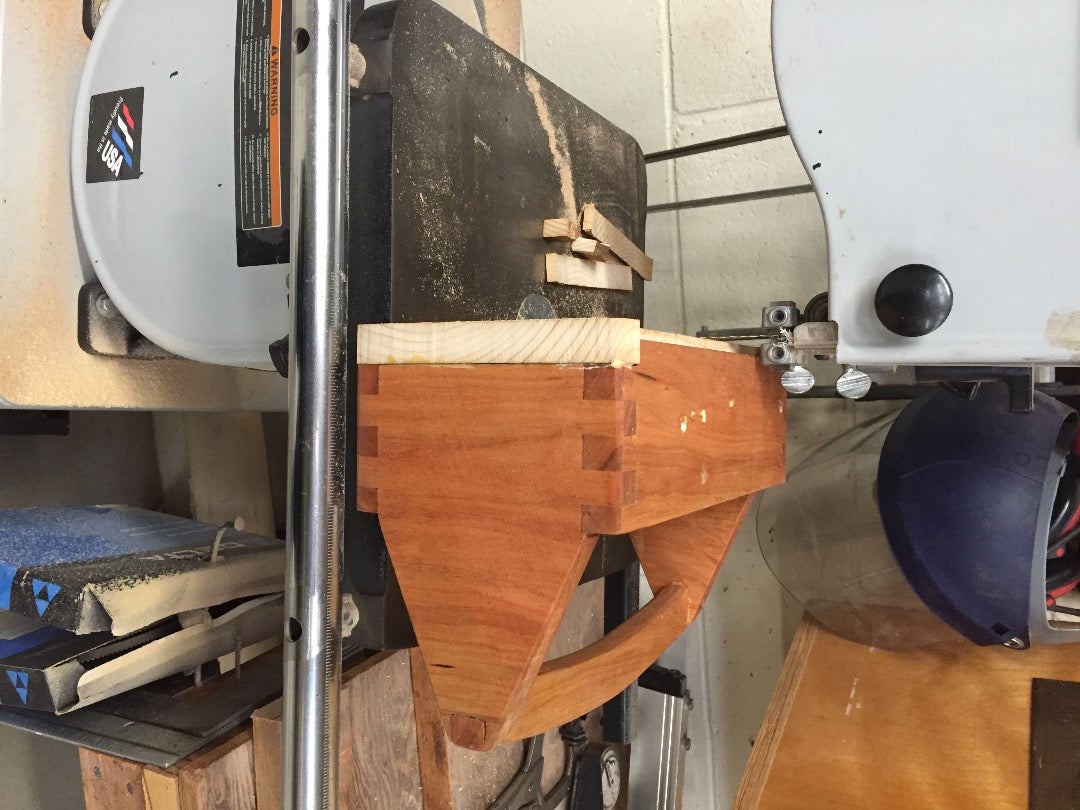

This box was actually a mess in the middle. I set up my jig and checked all of my measurements as always. But the layout didn't get done exactly right. This is why It has a pine bottom that is not box jointed. So, enough about all that. Just lay it out, glue it up, and make lemonade out of a few lemons.
The outside dimensons are 12"X5.5"wideX8"tall(at the Handle). And the width of the wood after planed is 5/8".

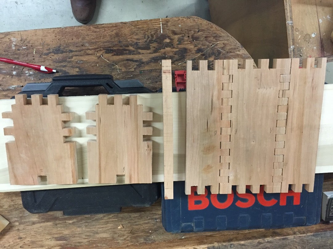

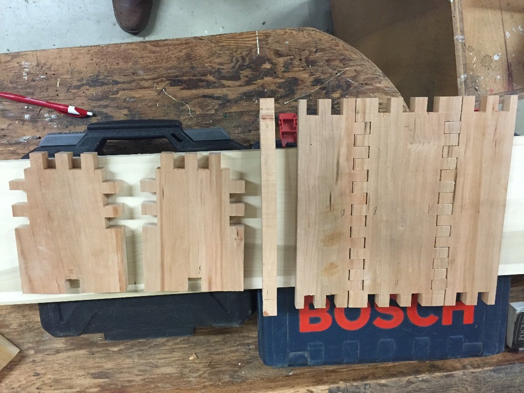

Now this one turned out a lottttt better than the first. I started out with the bottom. Just cut it out all square, then put it on the jig. Start out without the normal wedge block but rather a board clamped beside the wedge. Then take out the wedge. Put your board next to the new board. This will give you a fat corner. Do this all the way around. Whoop Whoop.
Make sure that the sides all conjure up accordingly. Lots of waste but the end product will be worth it.
