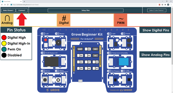

Navigate to Circuit Check's website here and click on the Connect Button in the top left corner. Now select the Serial port your microcontroller is currently connected to and you should see the Connect turn into Disconnect.
Make sure you are using the Google Chrome Web Browser. Circuit Check cannot work with other web browsers.
If all previous steps were done correctly, you are now able to use your microcontroller with Circuit Check!

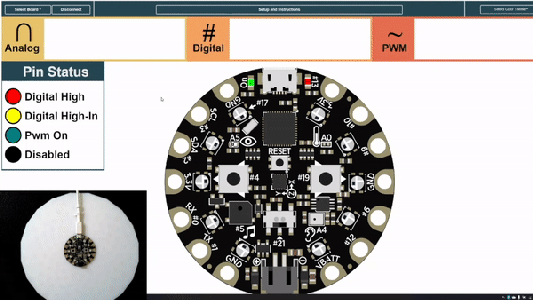

Step 4: Circuit Check Example - Controlling Onboard NeoPixels/LEDs
Circuit Check can be used to turn on, turn off, and set color (when applicable) of onboard NeoPixels/LEDs. To do so, click on the component and set the color on the top middle menu. While Circuit Check has preprogrammed colors, you can set the hex value at the bottom left corner of the menu.

Step 6: Circuit Check Example - Generating Output for Actuation
Circuit Check can control actuators that are either onboard or external (by turning the pin high). To control the actuator, select the actuator’s icon that is located on the board (e.g., the musical note on the Circuit Playground) or the pin the external actuator is connected to. If connecting to a pin, change “PinMode” to output. Certain actuators have a special UI to control the output. For example, the onboard buzzer in the Circuit Playground opens an interactive keyboard where you are able to select what sound you want to play and for how long.
