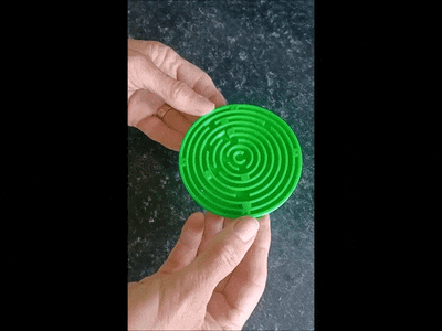

Most of us at some time or the other will have played with ball maze puzzles.
Those small puzzles with the transparent top, encased maze and a ball bearing.
Well this is a generator of said puzzle that uses Tinkercad Codeblocks to generate random mazes.
The generated mazes will be of the circular type complete with barriers and gaps to suit a 3mm ball bearing.

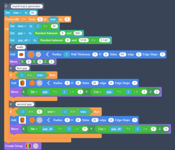

The code is created using TinkerCAD CodeBlocks.
Its broken down into the four main blocks to illustrate the actual process.
A series of 9 circles of increasing radius are generated centred around the same reference point (X0,y0).
The walls of the circles are 1mm thick with a step increment of 5mm creating a 4mm channel width.
Gaps
First: If the current circle is less than the ninth circle in the series randomly[1] create a gap.
[1] Randomly generate an integer number from 0 to 360 degrees.
Secondly: If the current circle is greater than the first and less than the ninth randomly[2] create another gap.
[2] Randomly generate a non integer number from (0 to 1130)/3.142 creating numbers from 0 to 359.6435
Even if the same seed is used to generate the random numbers the gaps will be in different positions, this greatly minimises the likelyhood of dead ends.
E.g. If the first random number is 360, (gap=360) and the second is 360, (gap_alt=(360/3.142)=114.5767), creating gaps in two different locations, increasing the possibility of exits.

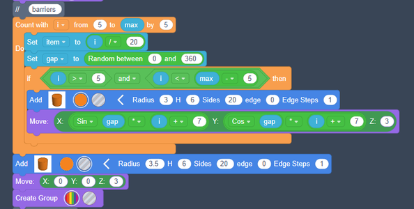

Barriers
A similar methodology is applied to the Gaps as is applied to the Barriers but only one barrier per iteration, which on the whole creates fewer random[3] barriers than gaps, minimising the likelyhood of unsolvable puzzles.
[3] If the current circle is greater than the first and less than the eighth randomly[1] create a barrier.

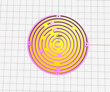

Screw Holes
Place a hollow cylinder at 90 degree intervals around the outer edge of the eighth circle.
Base
Create a flat base that ties all the circular channels, gaps and barriers to a solid object.

An example STL file for a solvable maze is included see (round_maze.stl), below.

Check for aberrations in the channels and clear with fine sandpaper, scalpel or needle files as is appropriate to ensure that the ball bearing runs smoothly.
