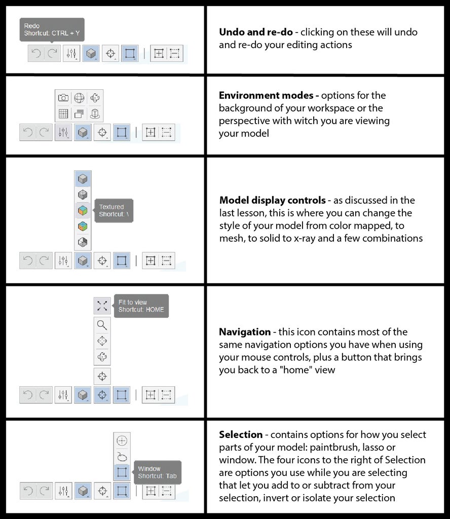

In the ReCap Photo Editor you will find three main toolbars that contain all the functions you need to view and edit your model. Clicking on most of the icons will bring up a menu of further options in that category. I'll give you a basic overview of what's in each toolbar, and in the next section I'll show you which workflows you'll use to most often to clean up your models.
The Navigation Bar is the line of icons at the bottom of the screen.
Here you can access from left to right:

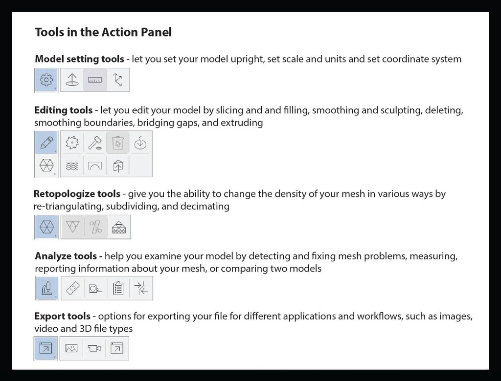

The Action Panel is the vertical menu on the left hand side of the screen. Here you will find from top to bottom:
Clicking on each icon opens a menu of further tools that will let you perform certain types of edits to your model.

If you want to select more than one piece to be deleted at once, you can use the add to selection button on the right of the Navigation Bar. If instead you want to remove something from the selection, use the subtract from selection button.
If you ever want to undo any action, just click on the undo button.

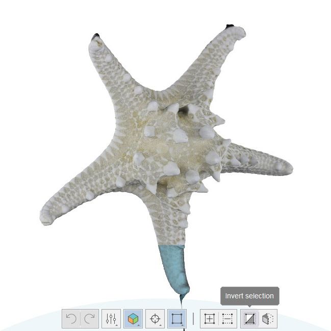

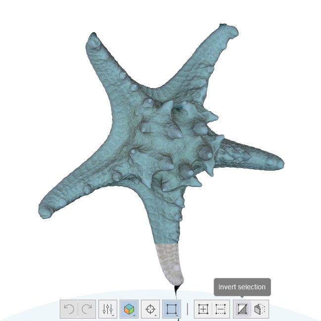

It can sometimes be easier to select what you don't want to delete. In this case, use a selection tool to grab everything but your intended selection, then hit the invert selection button to select the opposite.

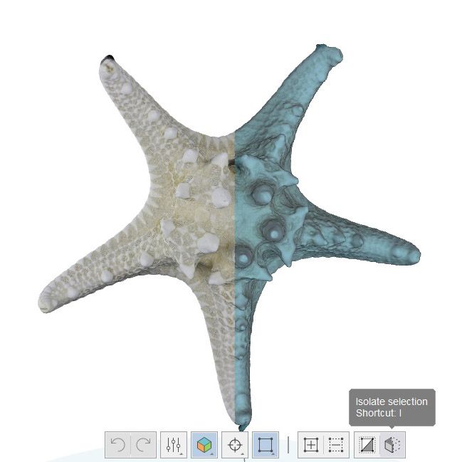

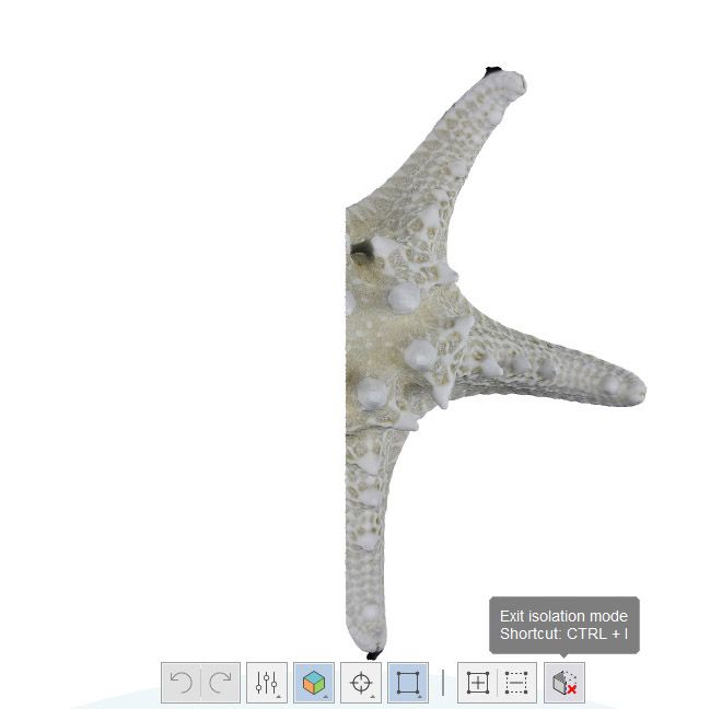

If, instead of deleting part of your model, you would just like to hide it so you can see the rest of the model better, you can use the isolate selection function. Select what you want to keep visible, hit the isolate selection button, and everything else will be temporarily hidden.

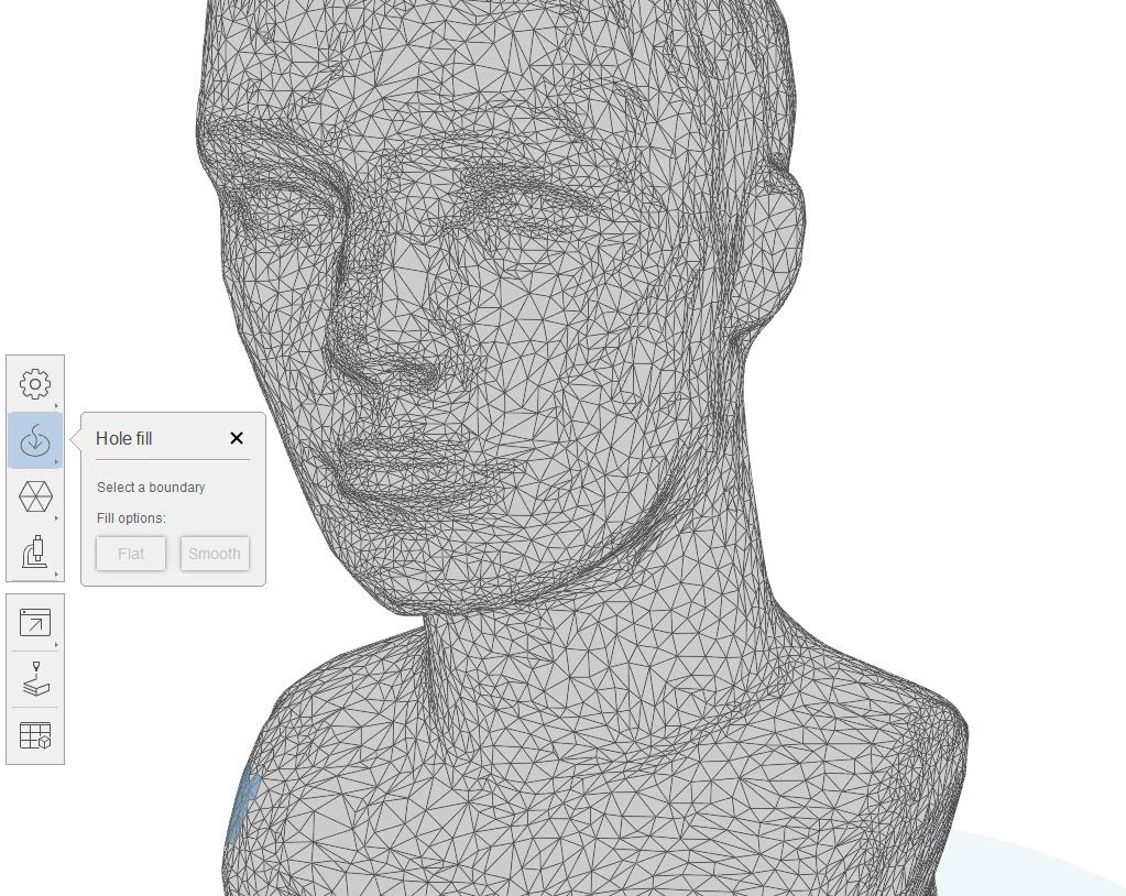

Step 3: Filling Holes
Sometimes your deleting process will create holes in your mesh, and sometimes there will be pre-existing holes that were glitches from the reconstruction process, either way, they often need to be repaired, and there are a few ways to do this.

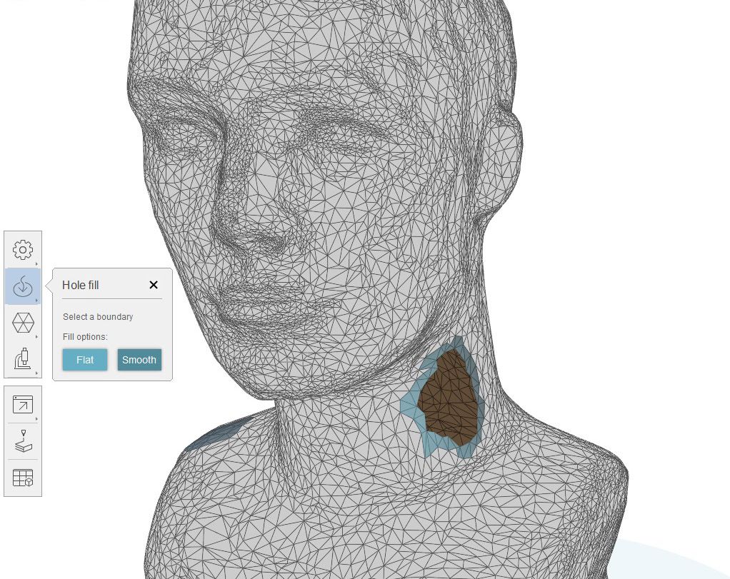

As you saw in the last section, the slice tool will automatically fill in holes created by slicing if you want it to. But if you left your holes unfilled, you can use the fill holes tool to close them easily.
This tool is under the Tools icon and looks like an arrow diving into a hole. When you click on this tool, it will automatically detect all the holes in your mesh and they will be highlighted in brown. The dialog box will ask you to 'select a boundary'. If you hover close to the hole you want to fill, the edge of that hole will be highlighted and you can click to select it. Decide if you want your fill to be 'flat' or 'smooth', and click to apply. If you are filling a hole on a curved surface, 'smooth' is usually a good option. If you are filling something like, say the end of a tube, you probably want 'flat'.

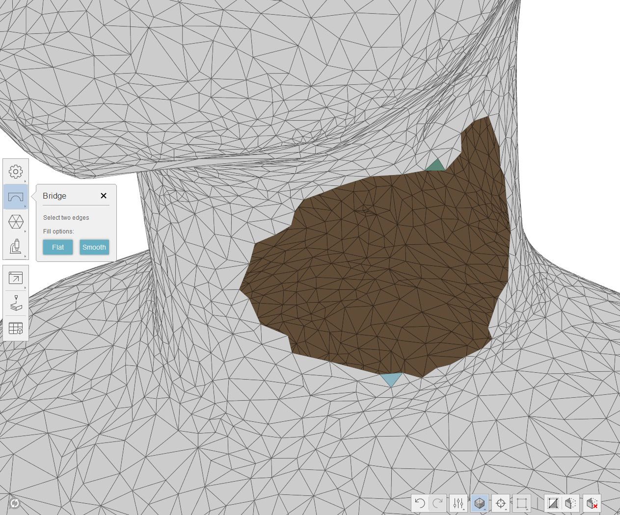

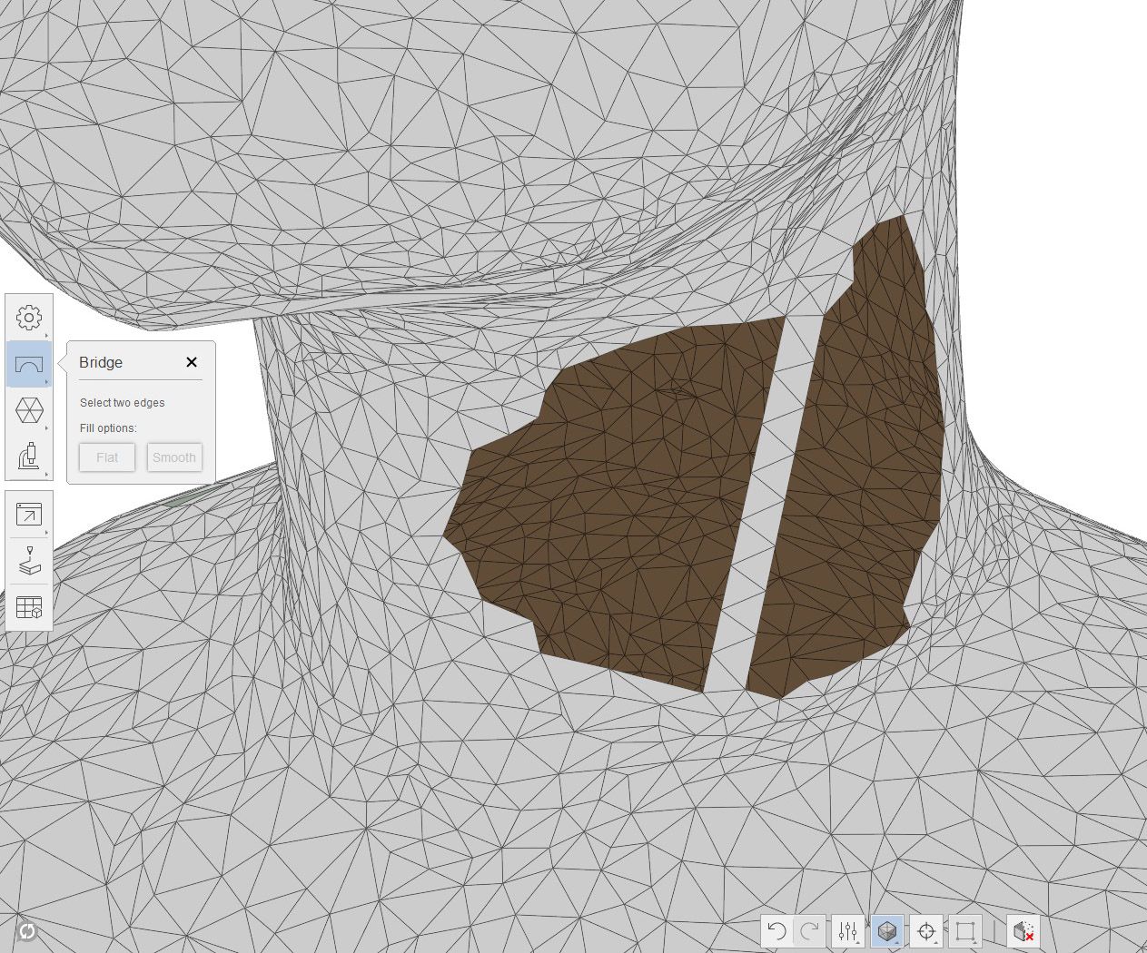

If you need to fill a large hole on a more complex surface, you can use a combination of a few tools to construct a more custom fill. Start by using the bridge gaps tool to divide your hole into smaller holes. When you open this tool, you will be asked to select two polygons on opposite sides of your hole that your want to create a bridge between. Once you select both points a bridge will be created.
Now you have created a separate hole on each side of the bridge, and you can fill those holes in individually with the fill holes tool. As you can see, using these tools in combination could let you construct some more complex features if you needed to.

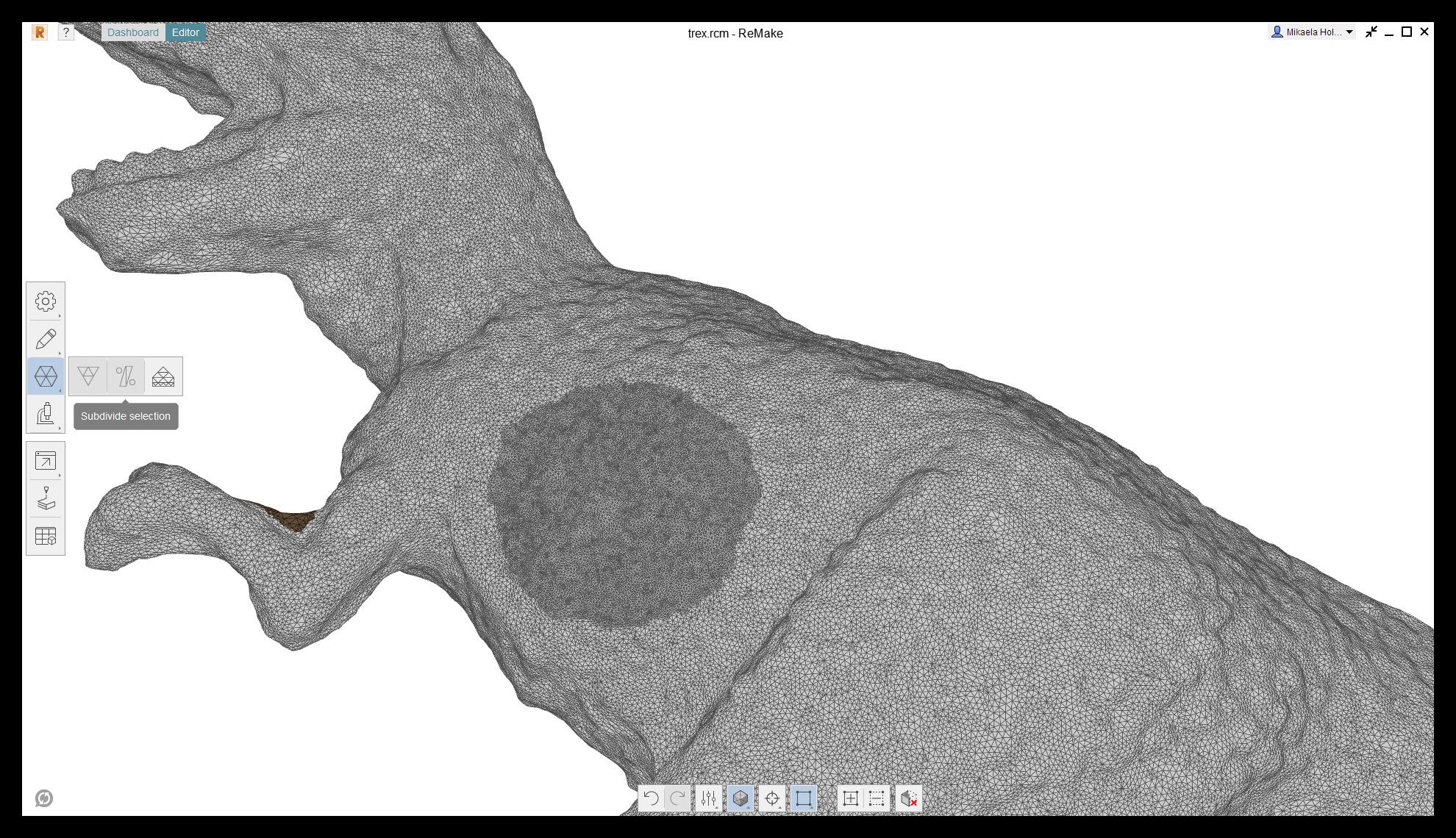

If you are trying to do some very delicate sculpting and you can't get the detail you want, you can try subdividing your mesh in the area you are trying to edit.
Because the geometry of your model is defined by the polygons in the mesh surface, more polygons means the ability to define more detail. To get more polygons, put your model in mesh mode, select the area you want to edit with the brush selection tool, then click on subdivide mesh under Retopologize. You will see that the area you selected has been subdivided into twice as many polygons. Now try making the edits you wanted with the sculpt tool and see if you get better results.

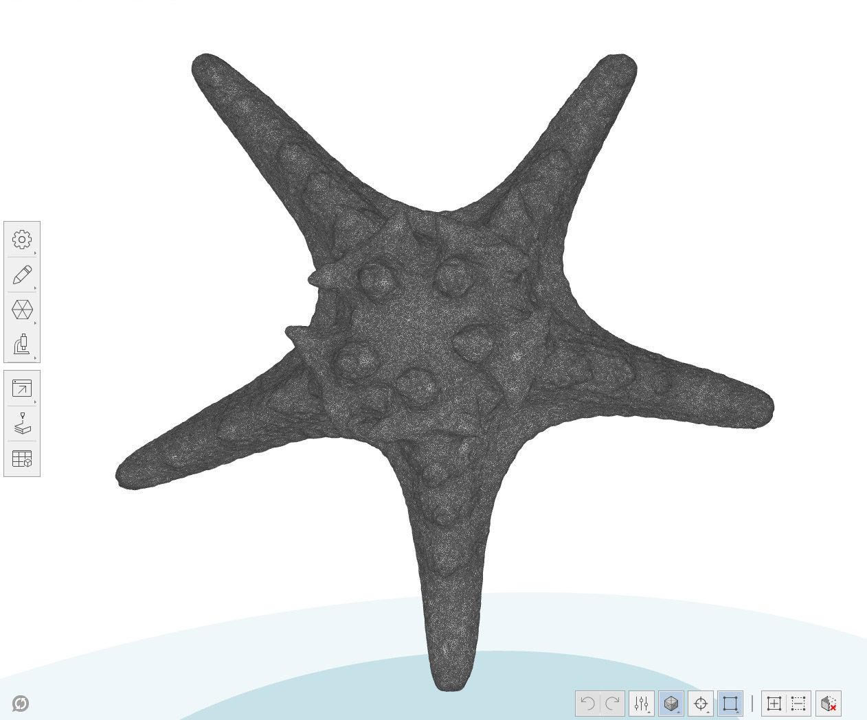

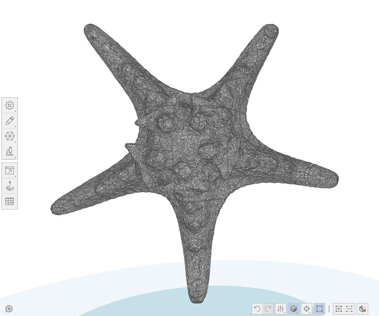

As we discussed in Lesson 2, 3D models created from photogrammetry are polygon mesh models, which means the geometry of their surfaces is represented by a large number of polygons arranged in a dense “mesh”. Meshes that come from photogrammetry and other reality capture methods sometimes have a much higher number of polygons or “polycount” than 3D models that were created in a 3D modeling program. Sometimes thousands of times more.
Models like this are often too complex for other 3D modeling programs or applications to handle, so you need to simplify them. To do this, click on the Retopologize icon and select the decimate model tool.
Original model
75% decimated
This tool lets you reduce the polygon count of your mesh without affecting the overall geometry too much. Toggle the slider to choose how much you want to decimate your mesh, then click 'decimate all'. If your mesh changes too much and you lose a lot of detail, you may want to decimate it less. If there is still plenty of detail, you can try decimating it more.
For models that are going to be used in something like gaming or VR with the color texture turned on, you can decimate them to a very low polycount because the decimation won’t affect the textured color layer and the model will still look good even when the actual geometry lacks detail.
