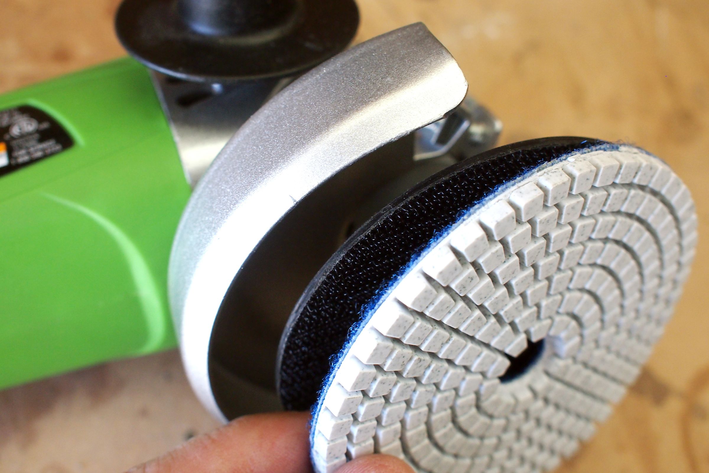

Since concrete is very hard we'll need an even harder material to grind and polish. Like sandpaper, diamond polishing pads come in different levels coarseness, from rough to smooth. This kit has doubles of the coarse grades of polishing discs, then steps up to very fine grade for a mirror finish.
These pads are interchangeable, so moving up a grade is really simple. Just like sanding wood, start with the coarsest grit and work your way up to the finer grits.

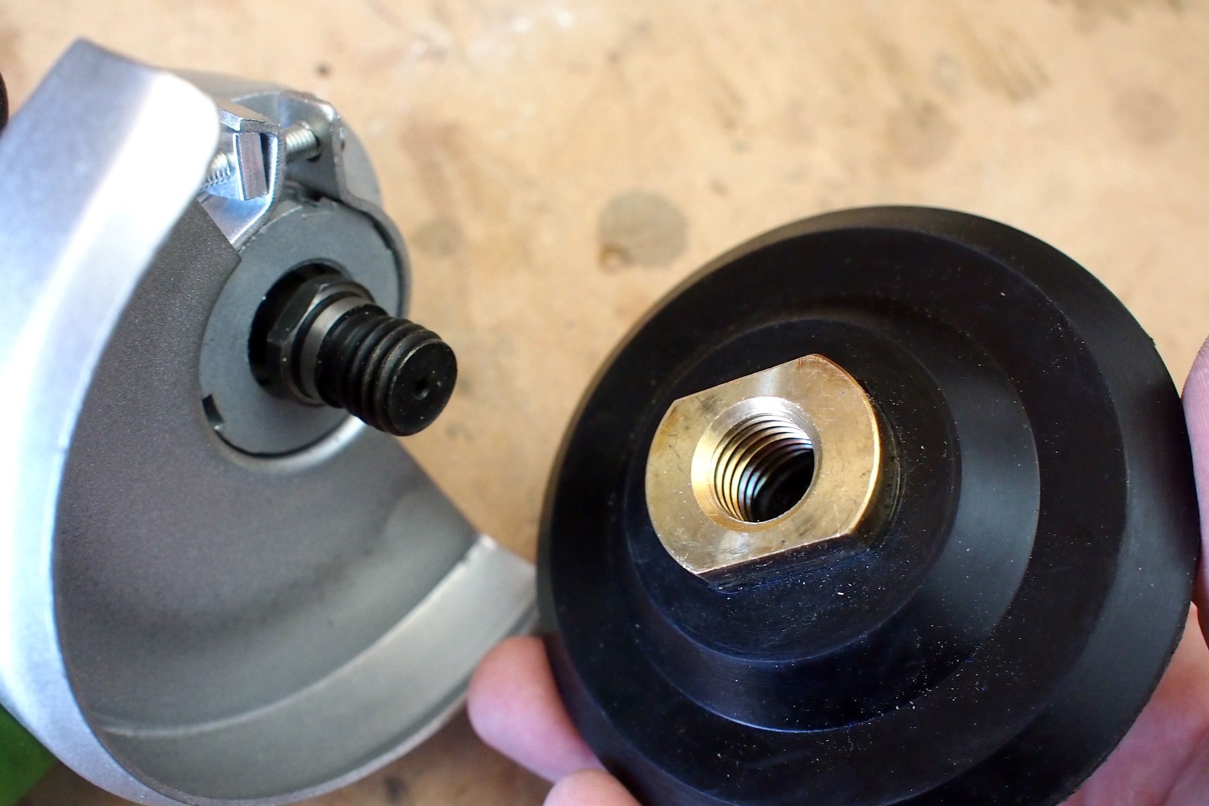

To fit the concrete heads to the angle grinder the grinding wheel will need to be removed and replaced with the concrete head.
All angle grinders are a little different, but most will have a special nut that holds on the grinding wheel. This grinding wheel is meant to be interchangeable and sits on the rotating threaded shaft.
The special nut will have a corresponding tool that allows the nut to be removed. To take the nut off you'll need to engage the wheel brake on the grinder, typically a button on the top of the grinder. Press the brake and rotate the grinding wheel by hand until you feel the brake hold the grinding wheel in place, then attach the nut removal tool on the nut and remove the nut. The grinding wheel can then be pulled from the threaded shaft.
The concrete head will have a matching threaded insert that is just screwed onto the threaded shaft. Using the brake as before, thread the concrete head onto the grinder until it is fully seated.

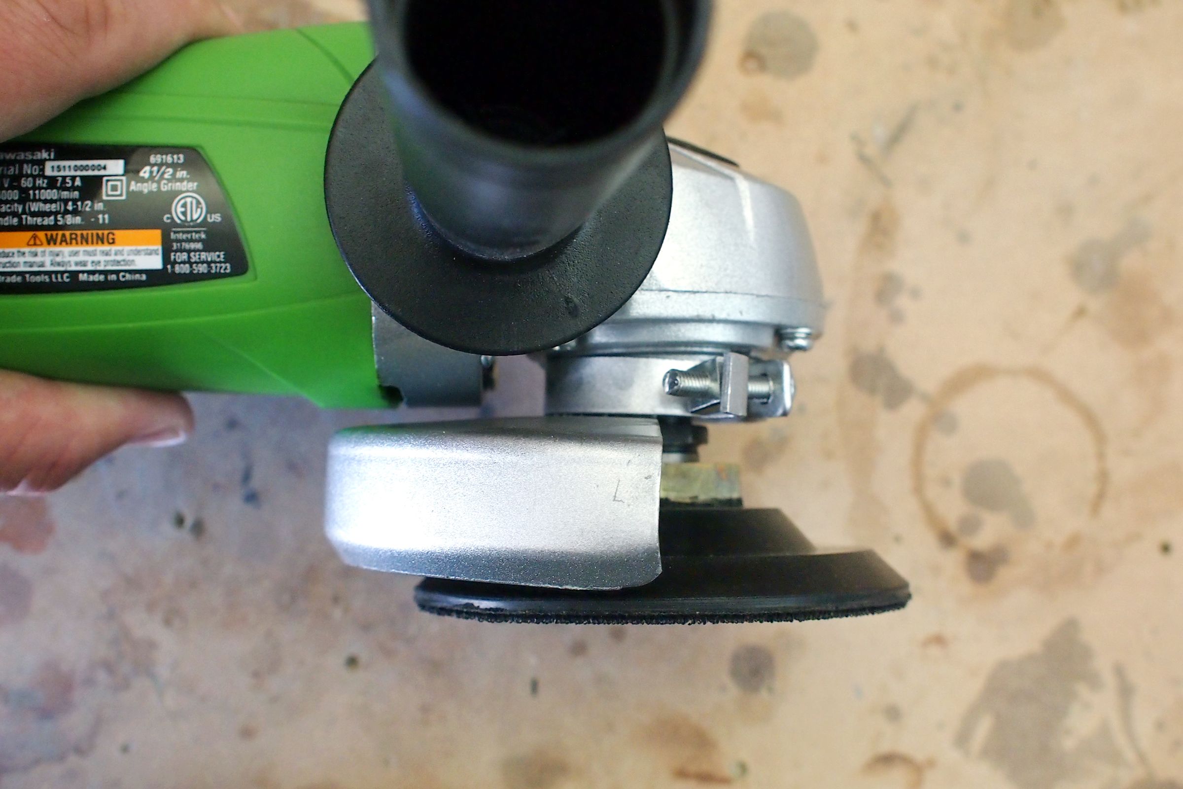

You want the concrete head to sit parallel to the body of the grinder, and it should not interfere with the grinding guard at all.

The concrete grinder pads are interchangeable, so you can start at a coarse grit and work up the grits to very fine.
The pads for this grinder head are hook and loop (Velcro) and can just be stuck on. I found that while this style is very handy the pads can sometimes slip off center, when attaching them I usually give them a little twist to ensure they were fully seated on the grinder head.
Check to make sure the pads sit flat on the grinder head, this will ensure a flat and uniform grinding surface.

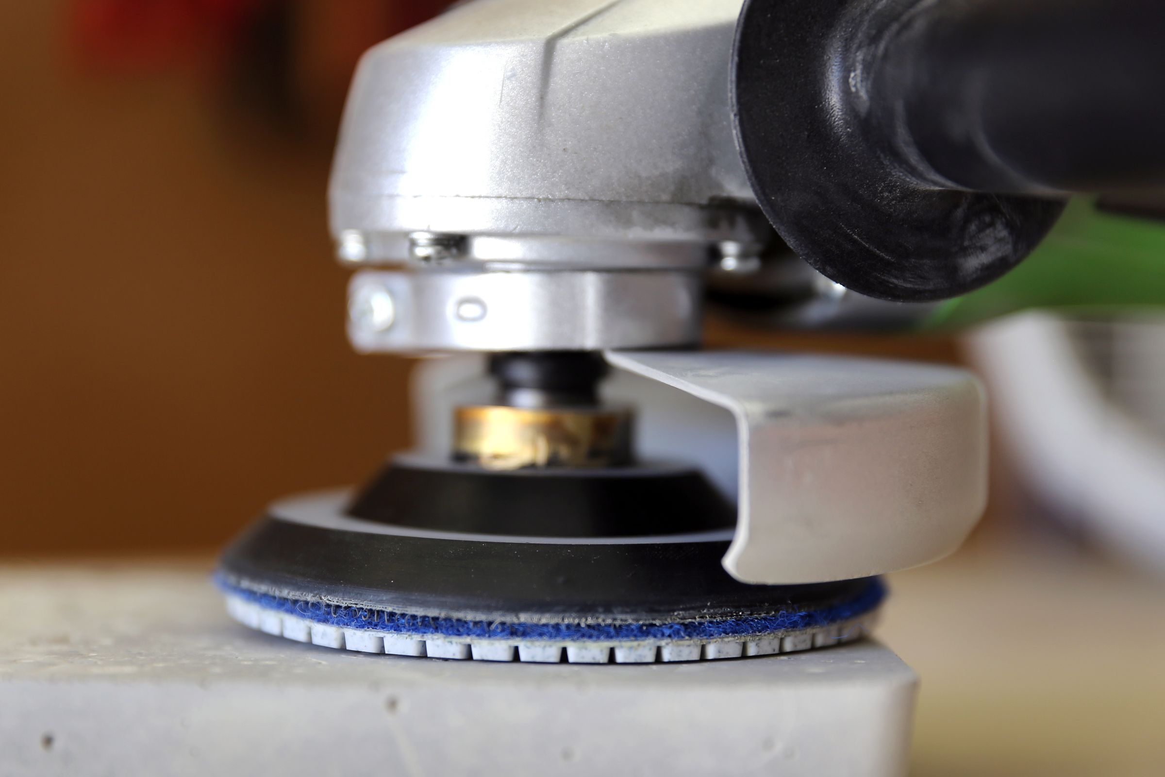

Wearing full PPE (sealed eye protection, cartridge respirator, face shield), and having your large fan blowing any dust and debris away from you and your work area (or using a wet grinding method), start grinding at one edge.
Ensure that you heep the grinding face flat on the work surface and gently move the grinder in small circular motions, working your way along the surface.
Grinding and polishing is not quick work. Taking the time to start with coarse grinding disks (lower numbers) and working up through to the fine disks (higher numbers) you can achieve a consistent and beautiful finish. This is very similar to how sanding works in woodworking.
