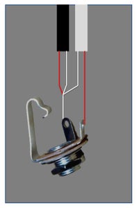

Step 5: Wiring
Steps:
1. You will need to solder on some longer wires to the ones from the head. There are 4 wires that are attached to the head and you will need to solder wire onto each one.
2. Solder the wire extension and add some heat-shrink top the solder points.. The wires from the head are in lots of 2. One lot has grey heat shrink and the other black. The wires coming out are red and white. I soldered on red wires to the red ones and black wires to the grey ones.
Step 6: Attaching the Jack
After some experimenting I worked out the best way to attach the wires to the jack
Steps:
1. Attach the 2 wires which have the black heat shrink on it together and also the black wire from the grey heat shrink. So you should have 3 wires soldered together and one wire (red) by itself.
2. Next you need to solder the jack onto the wires. There are 2 solder points on the jack. The 3 wires need to be soldered to the that is on the side of the jack,. The other 3 wires should be soldered to the other solder point.
