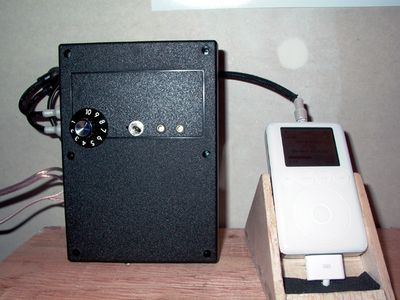

My friend has been carrying around this empty shell of a Micro Muzak Model 1008 for years with the intention of converting it in to something... someday. Apparently this was used in a university to pump the college station through all the buildings and had long since been left to fall in to ruins.
Using parts you can easily get and very little modifications to the actual case it came out looking preatty good. We reused the original knobs where they were still available for that original look. The tubes were left on the case to look cool, they do nothing.

Step 2: The Case
Lets just admire tis case for a minute. It is definitely built to be uer serviceable, unfortunately too much of the amp was missing, but just check out the markings on the case.

Step 5: Insert
The existing holes in the case were perfect for putting in the RCA Jacks, switches and volume knob, we the extra knobs on for looks... Although the holes were all too big, so I used two washers (one on the inside, one on the outside) to make the parts all fit.
The rear of the case had a spot for hooking up speakers, although we drilled through that and used our own speaker jacks t modernize it a bit.
Our kit fit right inside the case with no problems, I just drilled some holes to mount the transformer and standoffs for the amp kit.
Step 6: Wire It Up
I wired the volume knob, on/off with and used an alloy RadioShack LED holder(#276-080)to keep with the look.
It worked out great, sounds good and looks cool too.
