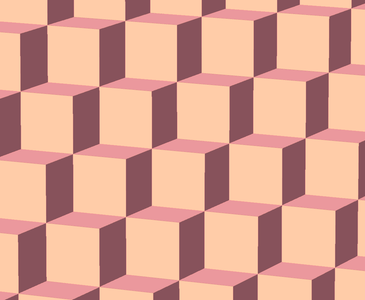

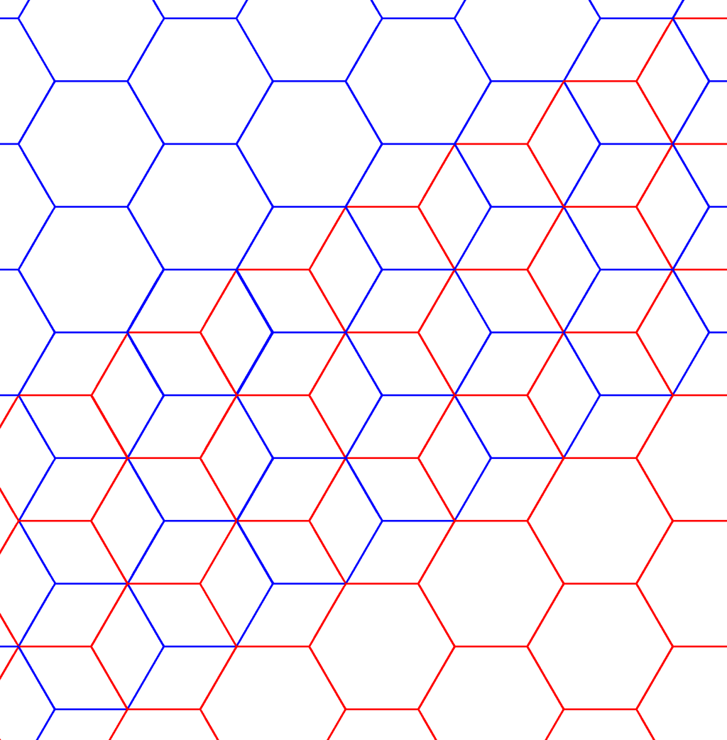

In geometry, the rhombille tiling, also known as tumbling blocks, reversible cubes, or the dice lattice, is a tessellation of identical 60° rhombi on the Euclidean plane. Each rhombus has two 60° and two 120° angles; rhombi with this shape are sometimes also called diamonds. Sets of three rhombi meet at their 120° angles, and sets of six rhombi meet at their 60° angles.
The rhombille tiling can be interpreted as an isometric projection view of a set of cubes in two different ways, forming a reversible figure related to the Necker Cube. In this context it is known as the "reversible cubes" illusion.
A tessellation or tiling of a flat surface is the covering of a plane using one or more geometric shapes, called tiles, with no overlaps and no gaps. In mathematics, tessellations can be generalized to higher dimensions and a variety of geometries.
A periodic tiling has a repeating pattern. Some special kinds include regular tilings with regular polygonal tiles all of the same shape, and semiregular tilings with regular tiles of more than one shape and with every corner identically arranged.
A real physical tessellation is a tiling made of materials such as cemented ceramic squares or hexagons. Such tilings may be decorative patterns, or may have functions such as providing durable and water-resistant pavement, floor or wall coverings. Historically, tessellations were used in Ancient Rome and in Islamic art such as in the Moroccan architecture and decorative geometric tiling of the Alhambra palace.
Tessellations are sometimes employed for decorative effect in quilting. Tessellations form a class of patterns in nature, for example in the arrays of hexagonal cells found in honeycombs.
You will also see that there are hundreds of variations of this optical illusion (photo 3).

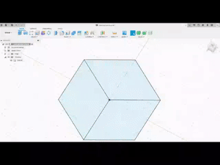

I used Autodesk fusion360 and Adobe Illustrator for design.
On a plane I drew a hexagon 15 mm per side that I divided into three equal diamonds. Then, when they were extruded 7 mm, they became thick: white on the top, black on the left and red on the right.

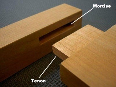

I decided that the three diamonds join each other and with others through the joint system used in wood carpentry called "mortise and tenon joint".
For the joints I took as a premise that the mosaics were growing as they fit from left to right and from bottom to top.
In this way, two types of diamonds "A" and "B" were formed by the configuration of their joints.
With the final design of the type "A" diamond, the black and white diamonds can be printed on a 3D printer, while with the type "B" the red diamond can be printed.
The type “A” diamond has two “tenon” type (male) connections on two side walls of the diamond that form a 120 degree angle between them and two “mortise” type (female) connections on the other two remaining side walls of the diamond. .
The "B" type diamond has two "tenon" (male) type joints on two side walls of the diamond that form a 60 degree angle to each other and two "mortise" type (female) joints on the other two remaining side walls.
The dimensions of each “tenon” (male) joint is 9mm x 2mm x 3mm.
The dimensions of each “mortise” (female) joint is 9.2mm x 2.30mm x 3.05mm.
To build a hexagon, start with the three diamonds placed as indicated in the figure (black on the left, white in the center, and red on the right).
The white rhombus is taken and turned 90 degrees counterclockwise and placed on top, while the red rhombus is taken and brought closer to the black one.

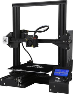

The print was made with PLA filament on a 3d printer.
The main parameters that I used were:
  • Layer Height = 0.12 mm.
  • Infill = 15%
  • Bed temperature = 65/70 degrees.
  • Nozzle temperature = 195/200 degrees.
  • Printing speed = 35/40 mm / min.
  • Generate support = no

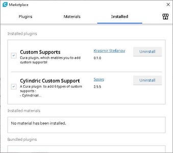

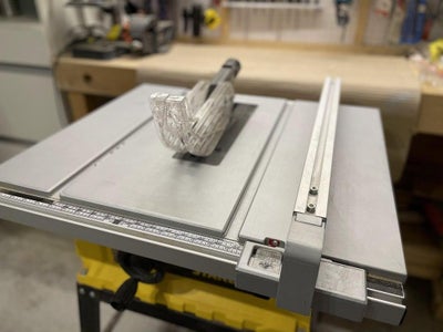

TIP1: for “tenon” parts, I used support "cones" (see the photo) to ensure that the support adheres better to the base. Download "Custom Support" plugin by Krasimir Stefanov. You can download in the Cura MarketPlace.
