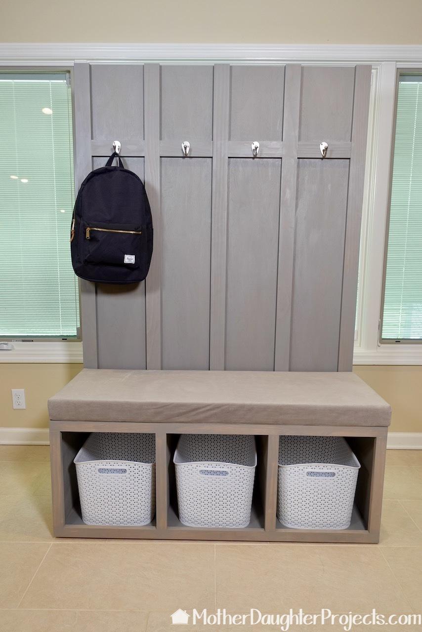

My daughter-in-law needed a place for all the things the grandkids bring into the house after school. She needed some kind of landing zone for backpacks, shoes, school supplies and more!
This is what we came up with. Since she is in an apartment and plans to move in the future, we built it with that in mind. It can easily be taken apart and moved to a new location.

Once the unit was finished and dry it was time to transport it to its new home.
It breaks into five pieces: the two back pieces, the bench, and two back support pieces. It fits easily into a Honda CRV for transport.
Once in its new home the backs were screwed into place, the supports were added to the back and the entire unit was put into place. Adding the cushion was the finishing touch.
The piece fits exactly in the space for which it was designed.
