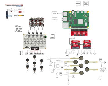

Hardware Wiring Diagram
Step 3: Hardware Wiring Diagram
Reference the above diagram as you're wiring your VTTV together.
*Note that the Octo Sound Card is not shown in the image, only the output side RCA block. It is connected to the raspberry pi via the 40 pin connector. VTTV does not make use of the input side RCA block.
Step 4: Hardware Setup
- Insert the imaged SD card into the Raspberry Pi and connect a mouse, keyboard, monitor, and power supply.
- Connect the Raspberry Pi 4 to the Octo Audio Injector Sound Card
- Connect the Sparkfun QWIIC I2C Breakout on top of the Octo Audio Injector Sound Card as shown in the WHCSIC Guide
- Change the I2C Address of each ADC from the default address of 0x48 to 0x4B and 0x49 (Figure 2). Follow along with the tutorial for trace cutting and solder jumper settings.
- Connect the RCA to 3.5mm cables from the Octo Sound Card OUTPUT RCA block to the Syntacts board. See the hardware diagram above for further details. Where you connect the cables matters.
- Connect a 5V power supply to the syntax board.
- When your VTTV hardware is connected, you can connect each motor to the output of the syntax board.

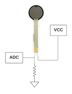

Step 5: Wire and Connect the Seven Pressure Sensors
- Solder a 3.3K resistor to the (-) terminal of each of the force-sensitive resistors. Then solder a wire for 3.3V and a wire for GND (Figure 1)
- Connect each of the 7 ADC wires to the screw terminal on the QWIIC ADC breakouts. One will have four wires and one will have three.
- Solder all 3.3V wires to the 3.3V rails of the QWIIC ADC breakouts
- Solder all GND wires to the GND rails of the QWIIC ADC Breakouts
- Daisy chain the QWIIC ADC Breakouts

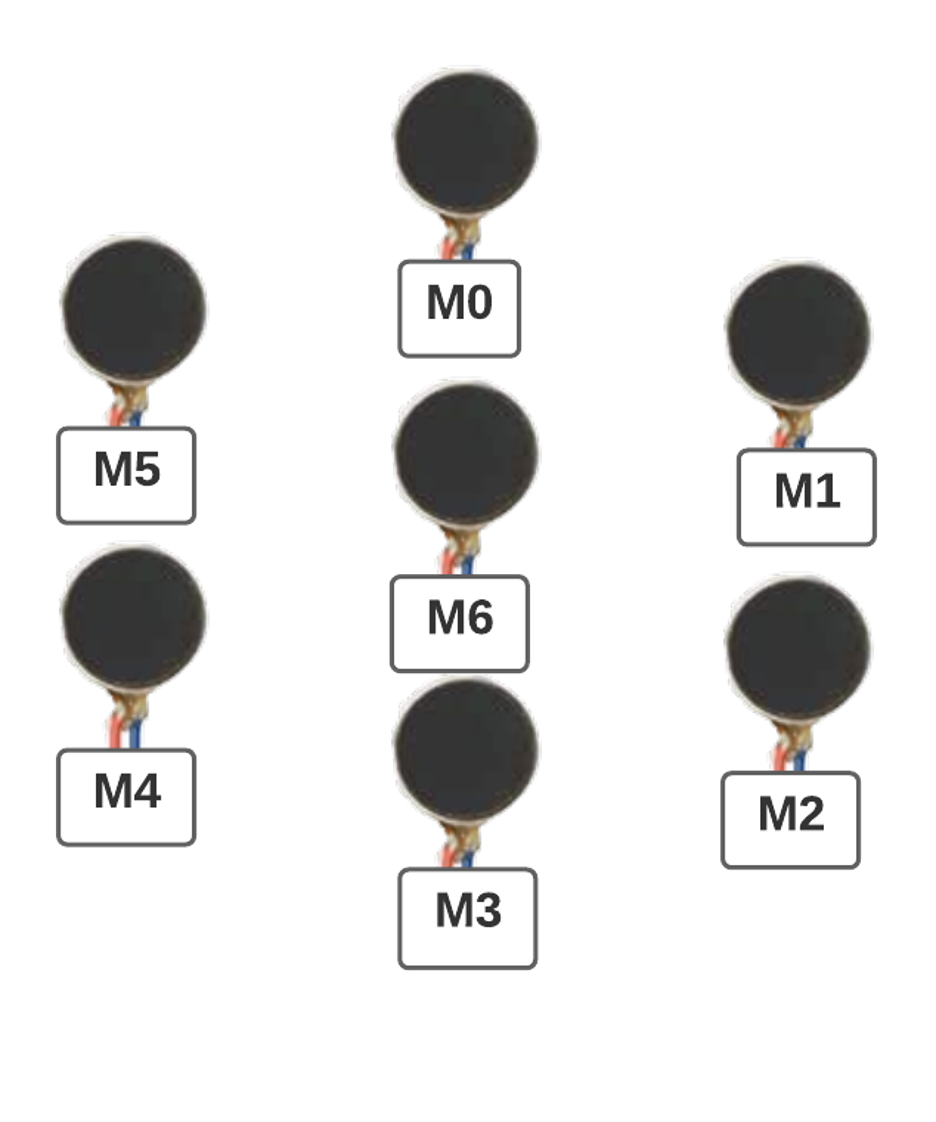

- Arrange the motors so that they are in the correct orientation for a seven-segment display and place them into a vacuum seal bag. If you are having difficulties with keeping the motors in place, use the sticky back of the motors to arrange them while in the bag. At this step, the motors should look like Figure 1. The distance between each motor can vary depending on the user’s preference but we’ve found that around 1mm in distance to be sufficient (Figure 1).
