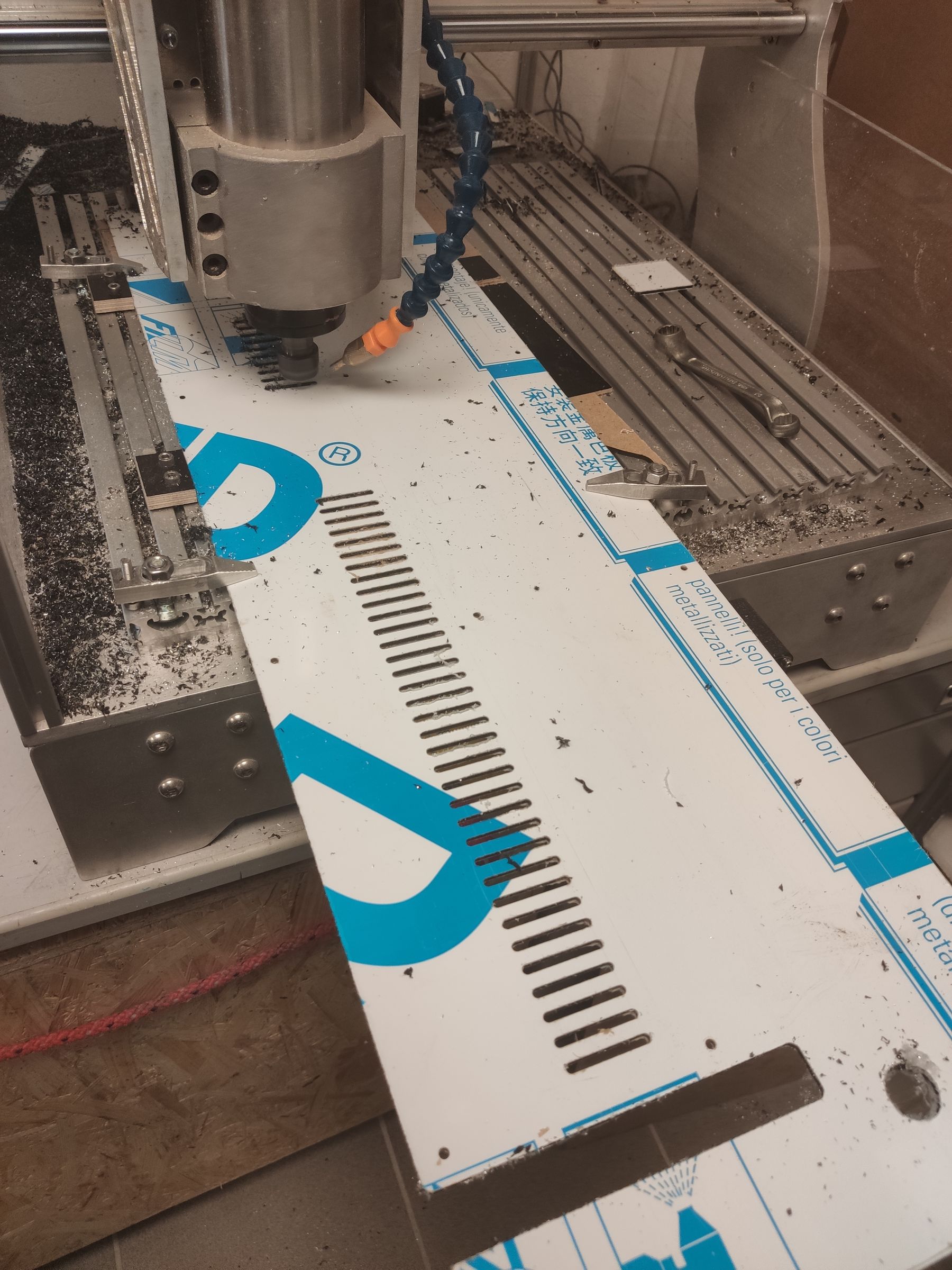

As you can see you will need a lot of custom cnc-machined parts. You will need CNC-Milled plates out of Aluminium Dibond and some functional parts out of aluminium. I produced these parts on my DIY-CNC-Mill and often I need to use multiple setups, because my mill was not large enough to mill them in one setup. All the parts were milled by me at my workshop:
Photos of production:
Here are all custom parts for the Lasercutter:

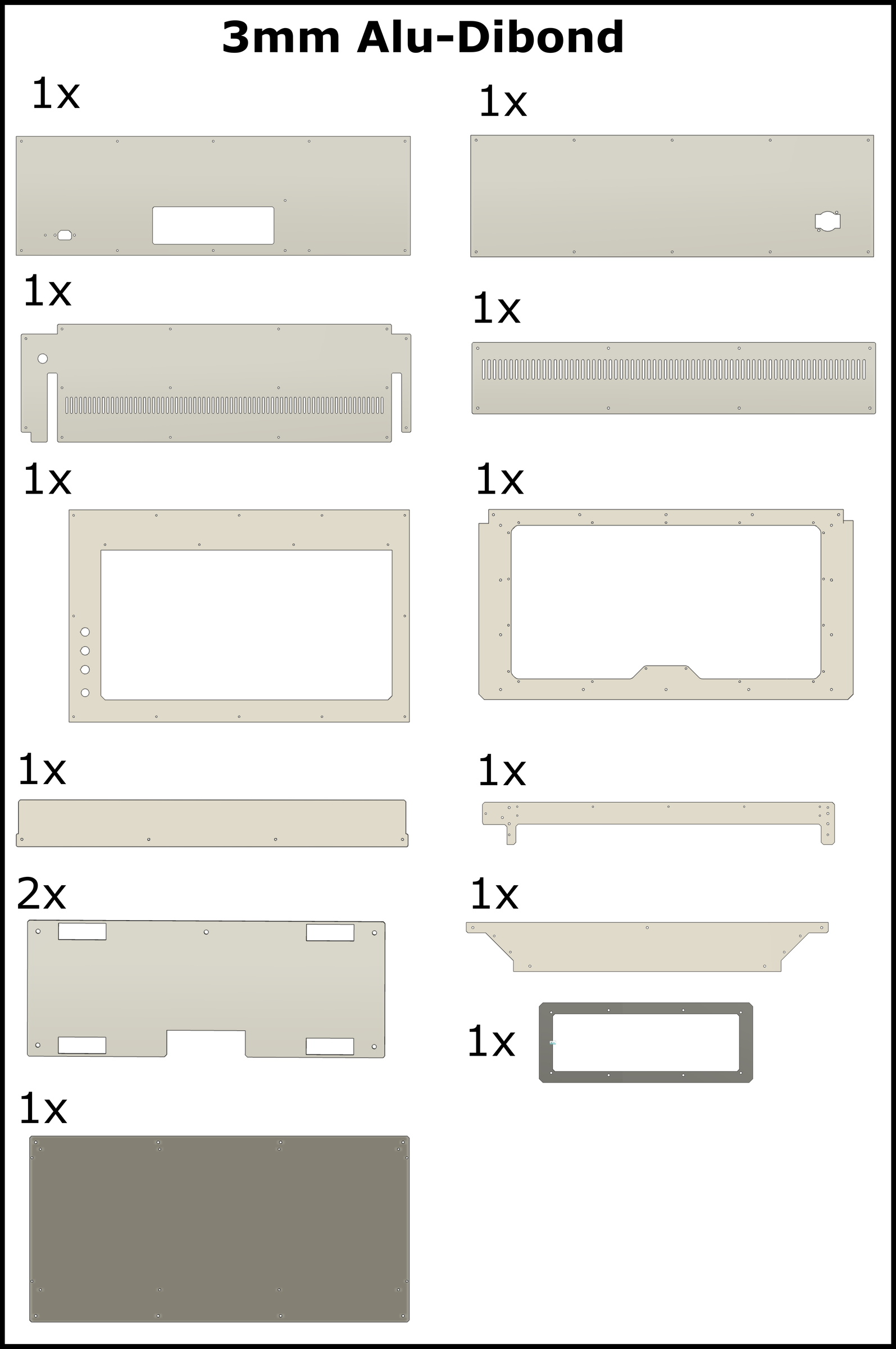

All criticals Parts like the X/Y-Gantry and the allignment of the Laser were made out of Aluminium. The parts are milled out of 4mm / 6mm sheet metal.

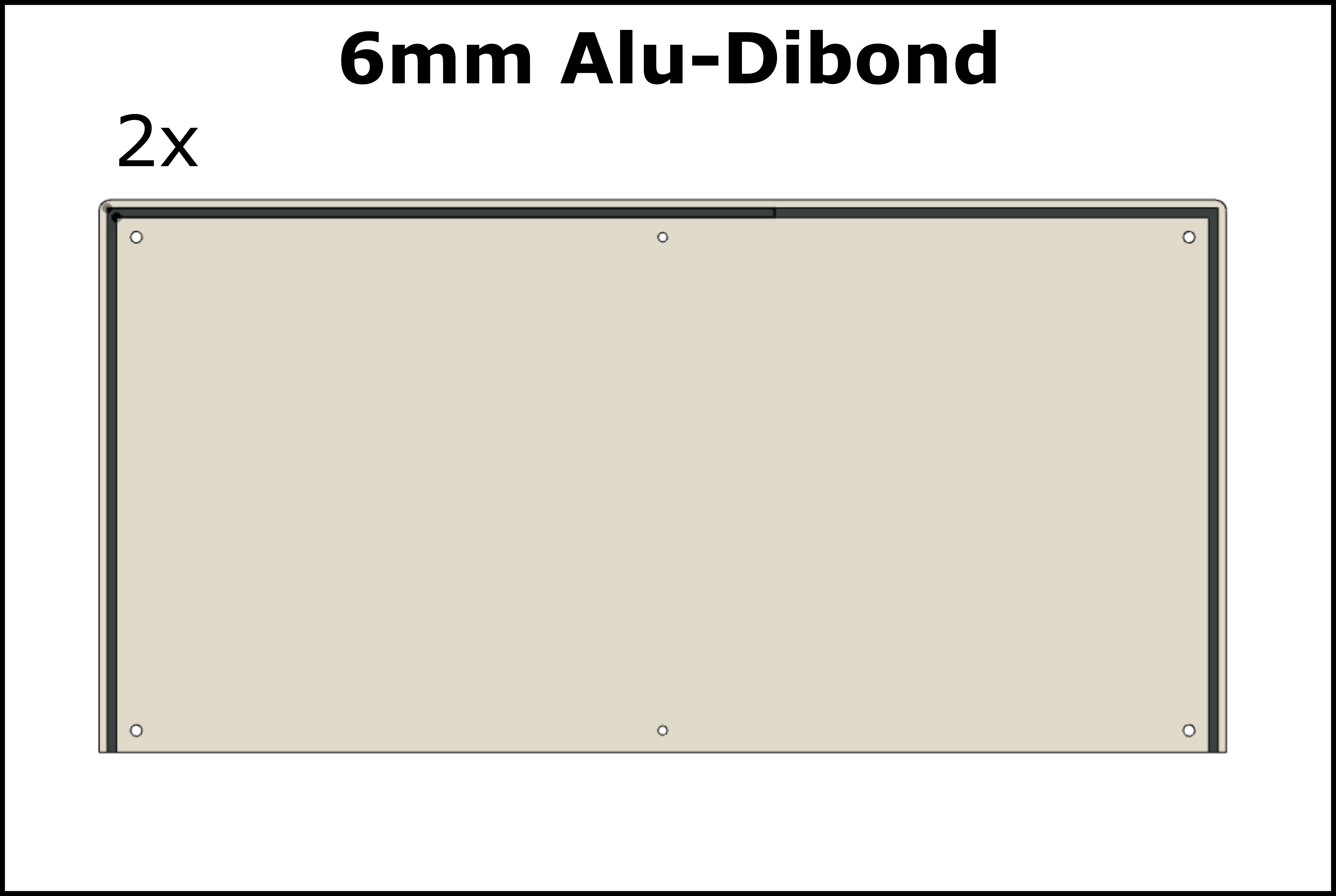

And here in 6mm:
For the enclosure I desided to use Aluminium-Dibond, because it will totaly block the CO2 Laser. Even a focused beam can not cut trough this material. Also it is prepainted in white, which is ideal for my application.
Most Parts were milled out off 3mm Aluminium-Dibond.
Only the two side Panles were mill out off 6mm Dibond
The window of the top door is made out of 6mm Plexiglas.
I tried to minimize the usage of 3D-Printed parts in this machine. I have used PLA for these Parts
I have also exported all the parts as a seperate .stl or .step/.f3d file, so you can easily start the production of the requierd parts. The complete CAD-File of the Laser is also attached below:

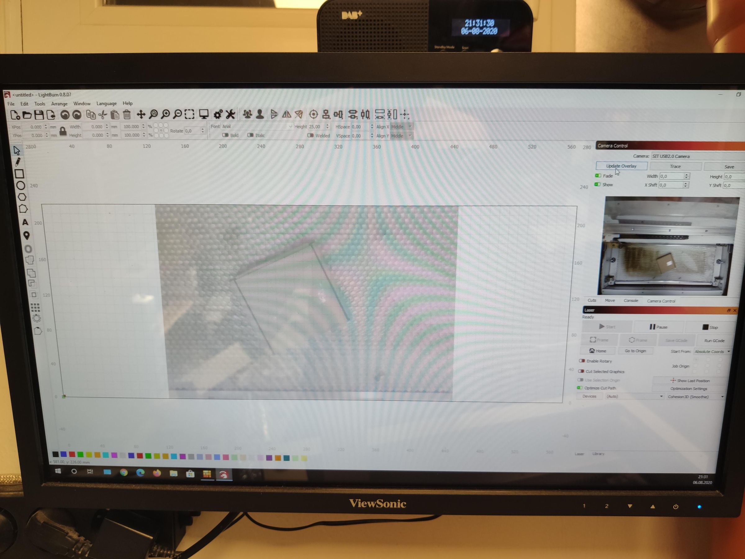

Software
For the Software I am using Lightburn, which will support the Cohension3D Mini Board and many others too ! This Software has all the features you will need to get productive with the Laser Cutter. The Software costs 30$.

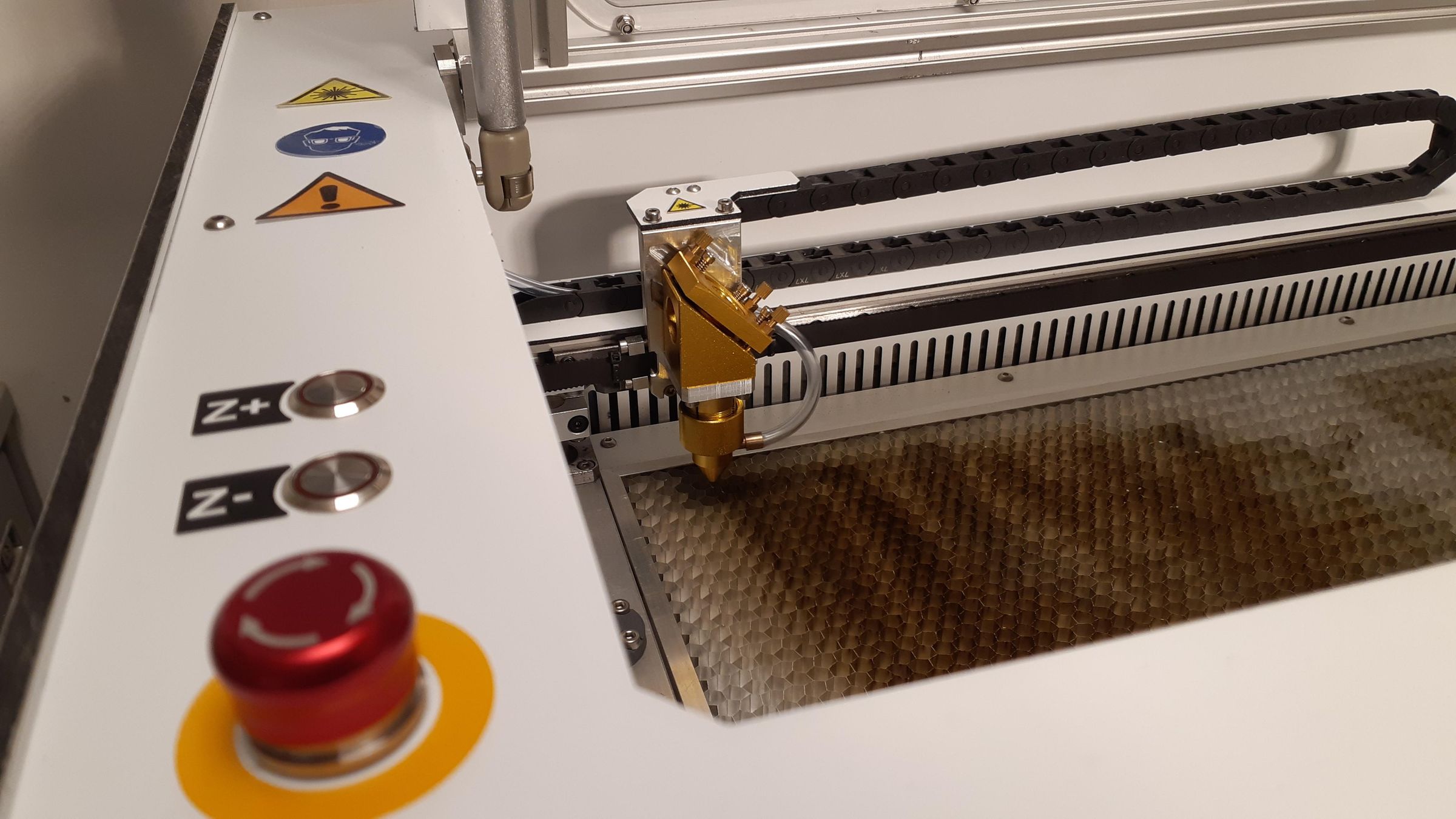

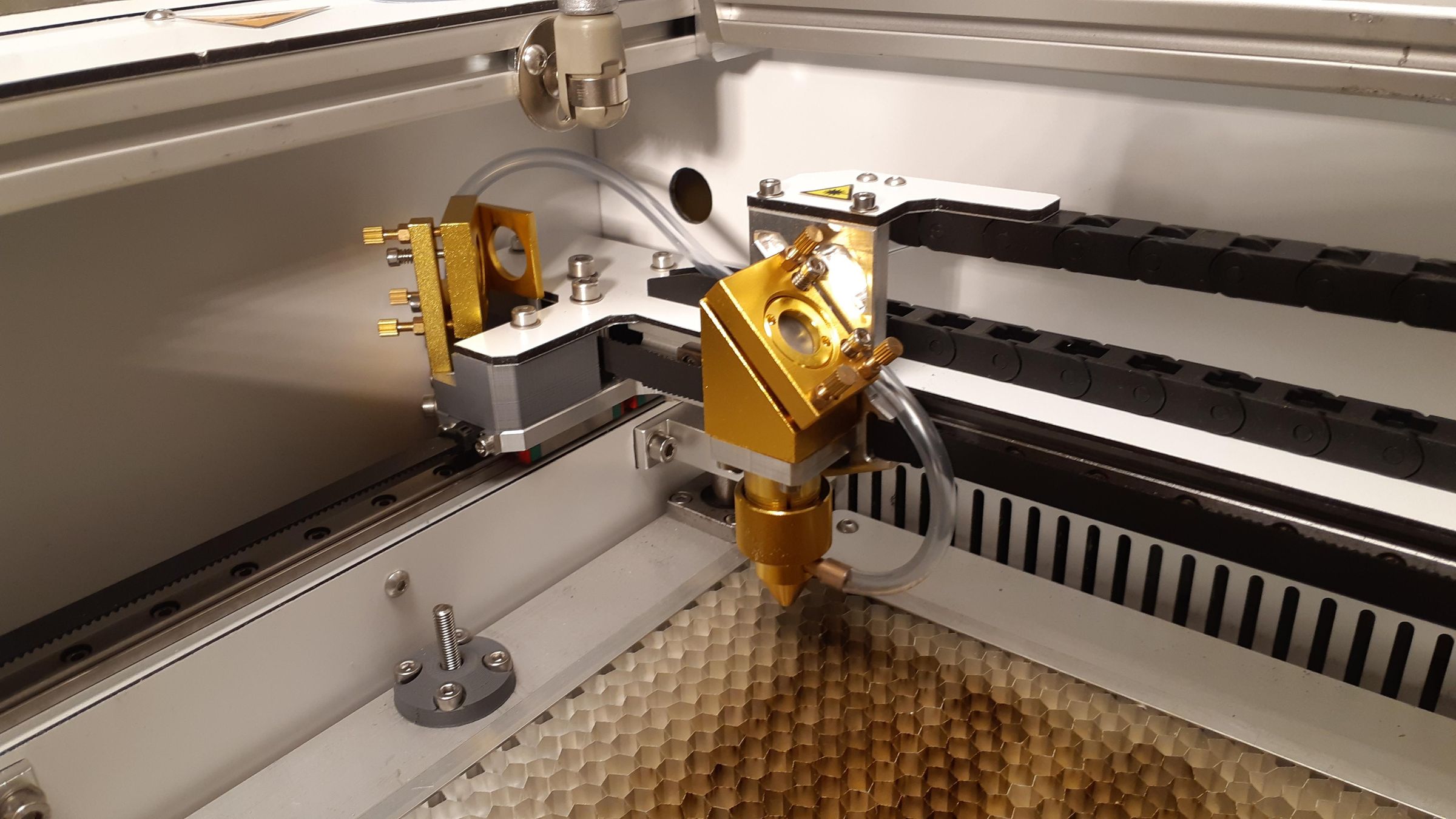

Step 13: X-Carriage
The X-Carriage is the Key-Component for a fast engraving!
I have tried to build the Carriage as light and rigid as possible. The Carriage is made out of 6mm Aluminium with heavy cut-outs.
Step 14: Finish X/Y-Gantry and Install Cable-Chains
Now you can install the X-Carriage to the Mainframe. Attach the Beld to the X-Axis. Install the Spacers for the left and right side of the X-Axis.
Finally install the Cable-Chains, and you are done with the X/Y-Gantry

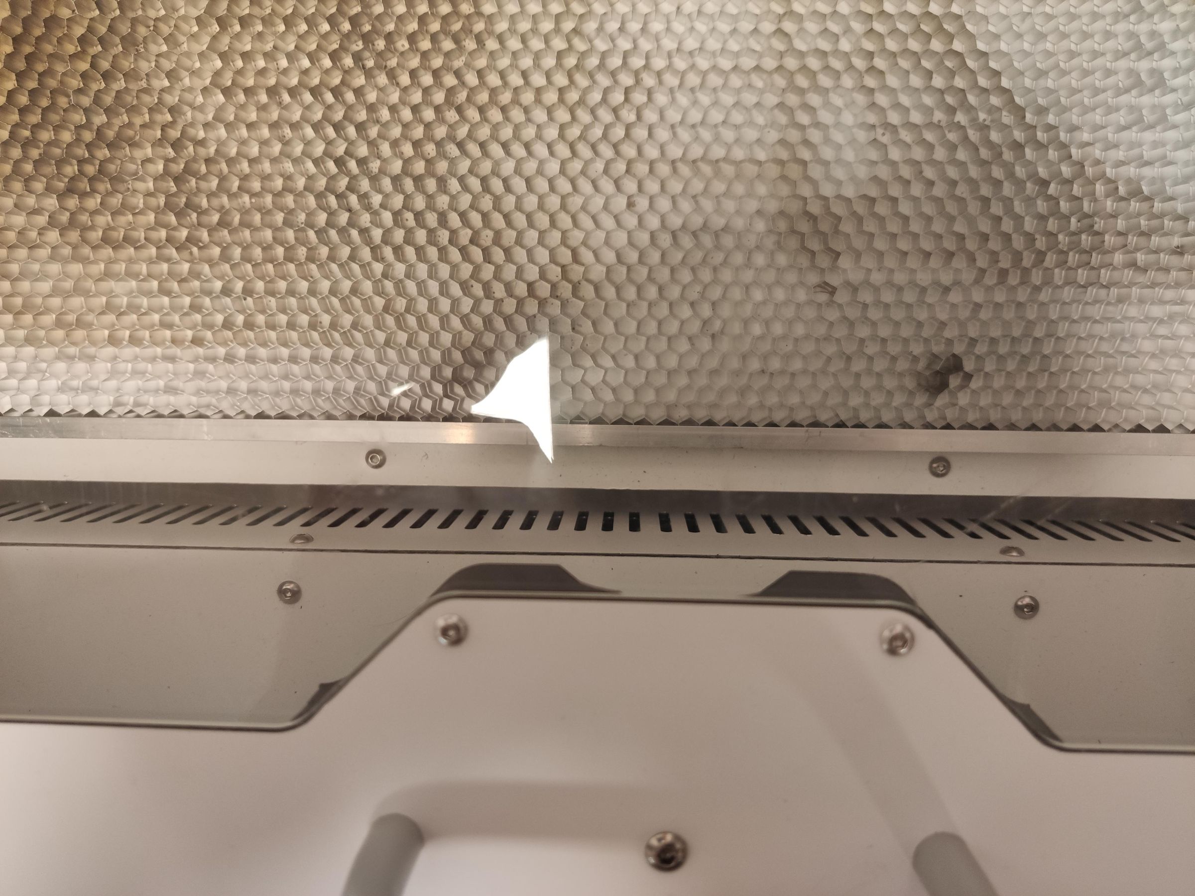

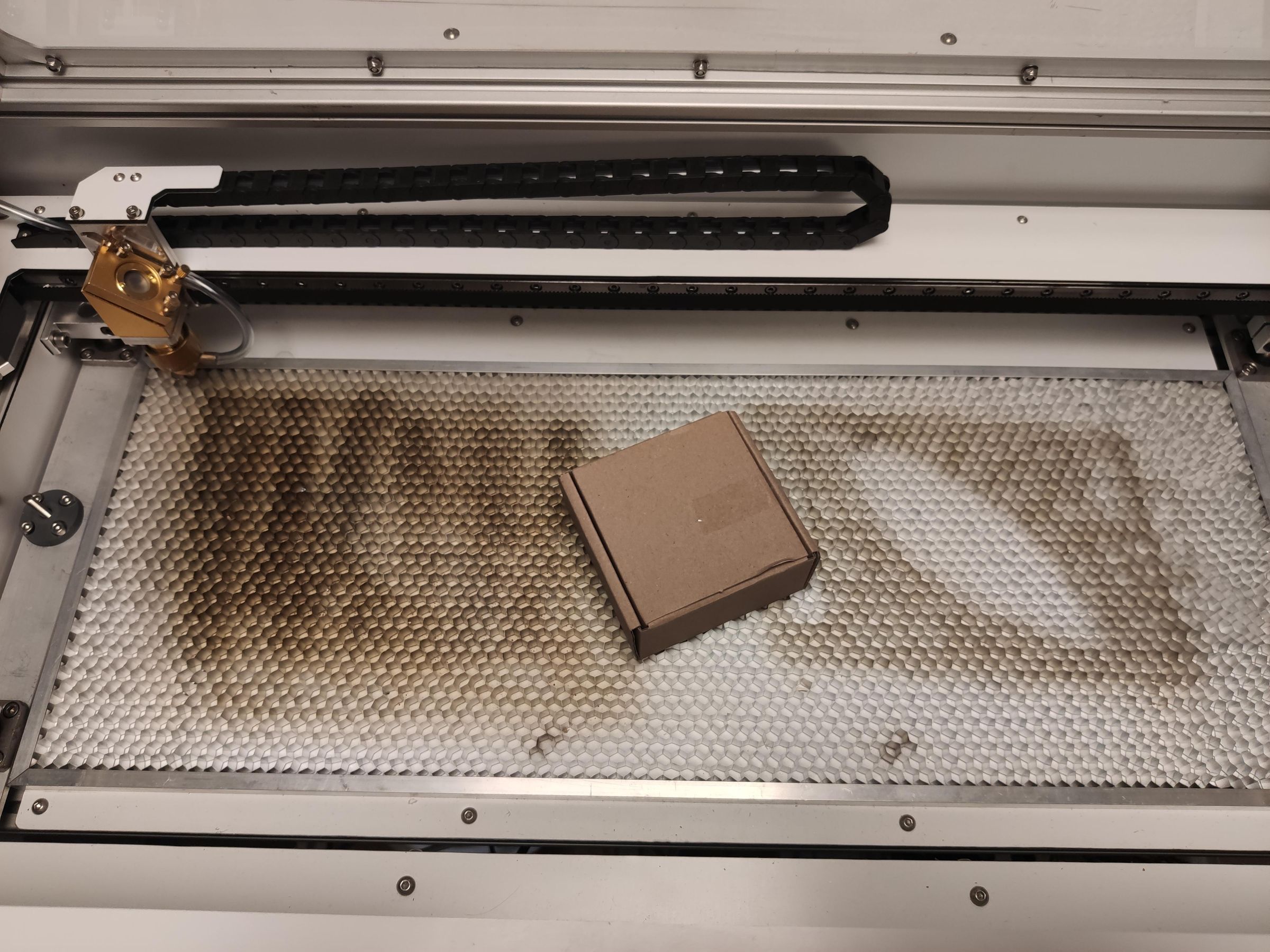

Step 15: Z-Table
For the engraving table I am using a 10mm Aluminium Honeycomp-Plate. The Plate is installed on a 4mm Dibond Plate.
The LMK12UU Linear bearings are attached to a 4mm Aluminium Plate.
This table is just a prototype, it worked okay, but there is potential for a better one... I have plans for an modular table, where I can make a tool-less change of different cutting tables... Maybe I will update this step in some days

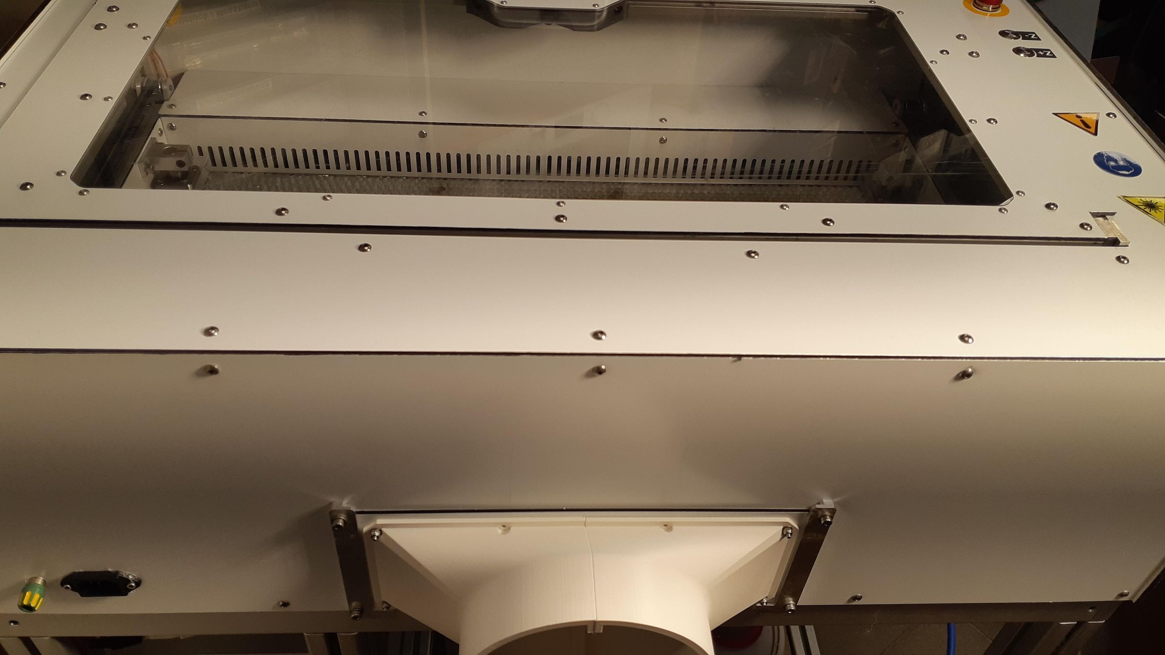

Step 17: Exhaust Funnel
To guide the fumes, which where created while cutting/engraving I have installed a funnel. The Funnel is build out of Dibond-Plates.

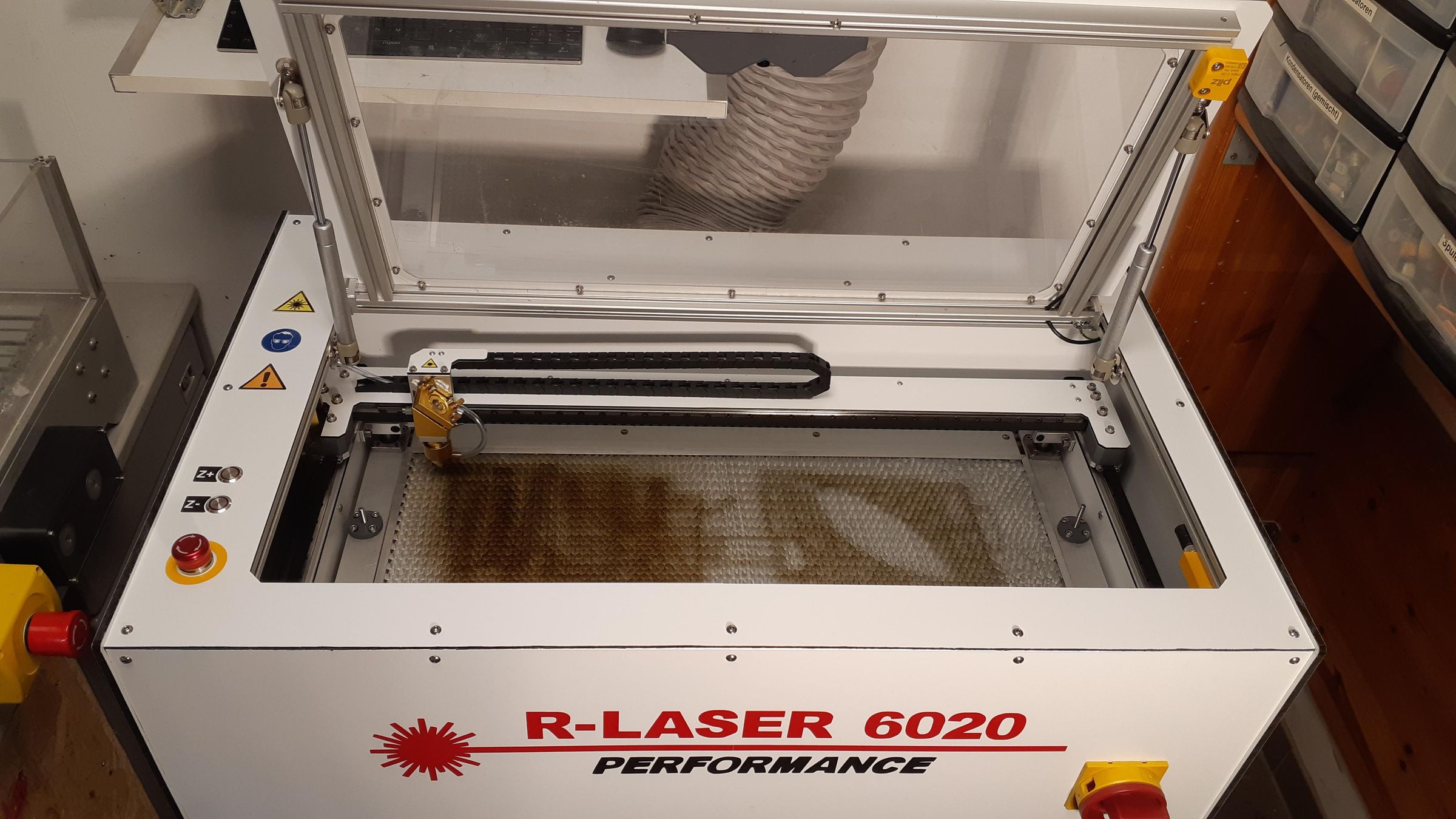

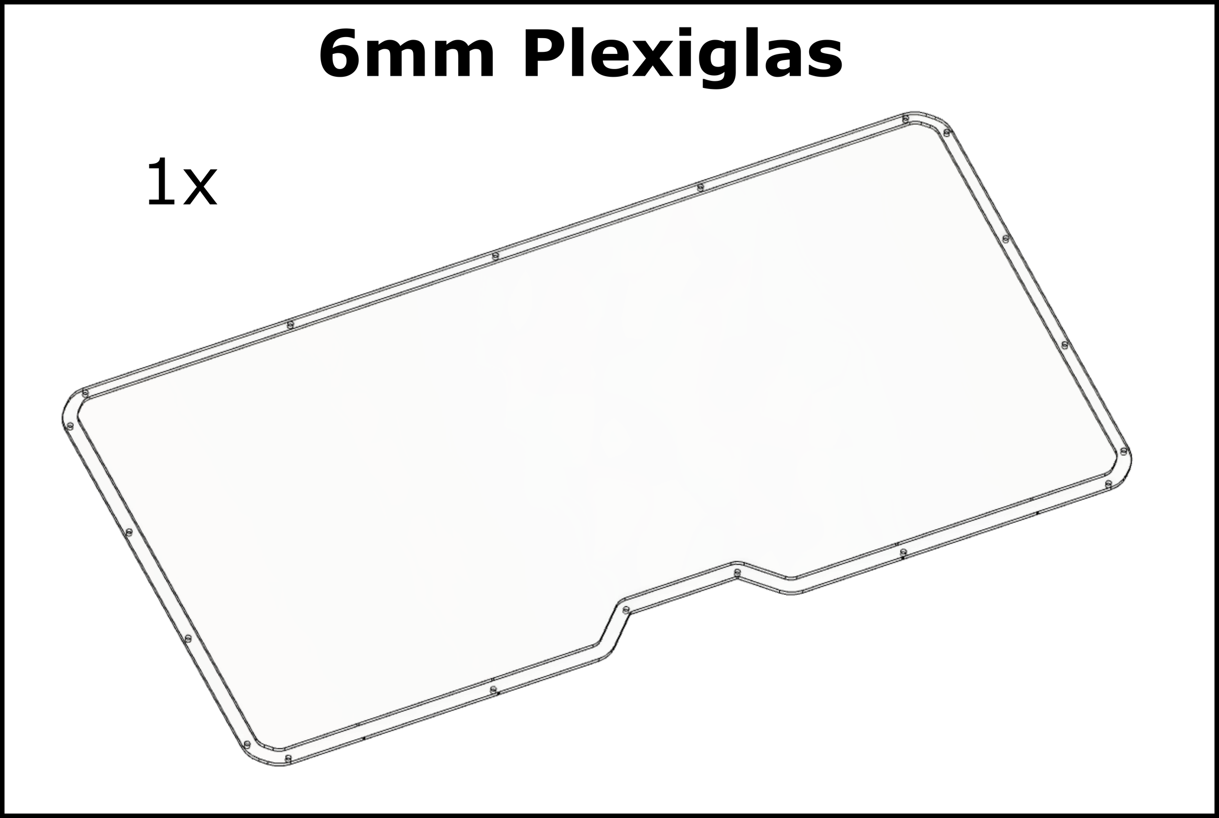

Step 18: Mill the Safety-Window
The Safety-Window is made out of 6mm Plexiglas. It is milled with an offset, so it will fit edge-less to the upper dibond plate.

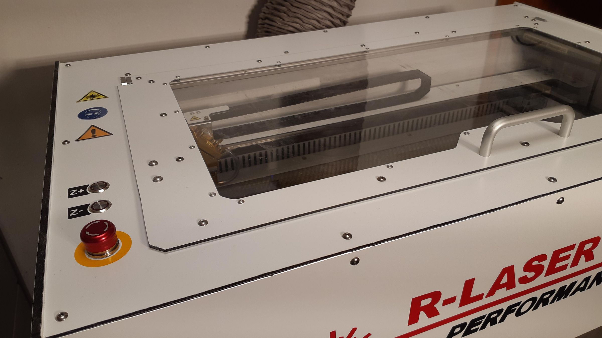

Step 19: Top-Door
The Top-Door is milled out of 3mm Dibond. The Safety-Window will fit perfetly inside it. To make the Top-Door more rigid, I have used 2020 Extrusions. The required hinge is also selfmade out of 6mm Aluminium.

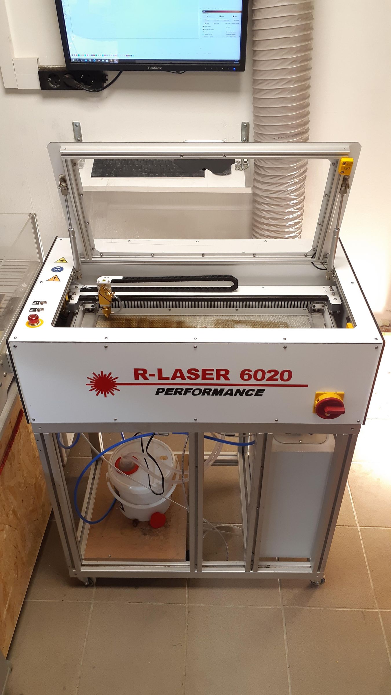

Step 20: Closet for the Laser
The closet for the Laser will lift the Laser in an optimal work hight.
In addition, it will contain all the additional parts which are requierd to get the Laser Working:
- Power Cabinet
- Air Valve
- Water Cooling
- Drawers for accesoirs

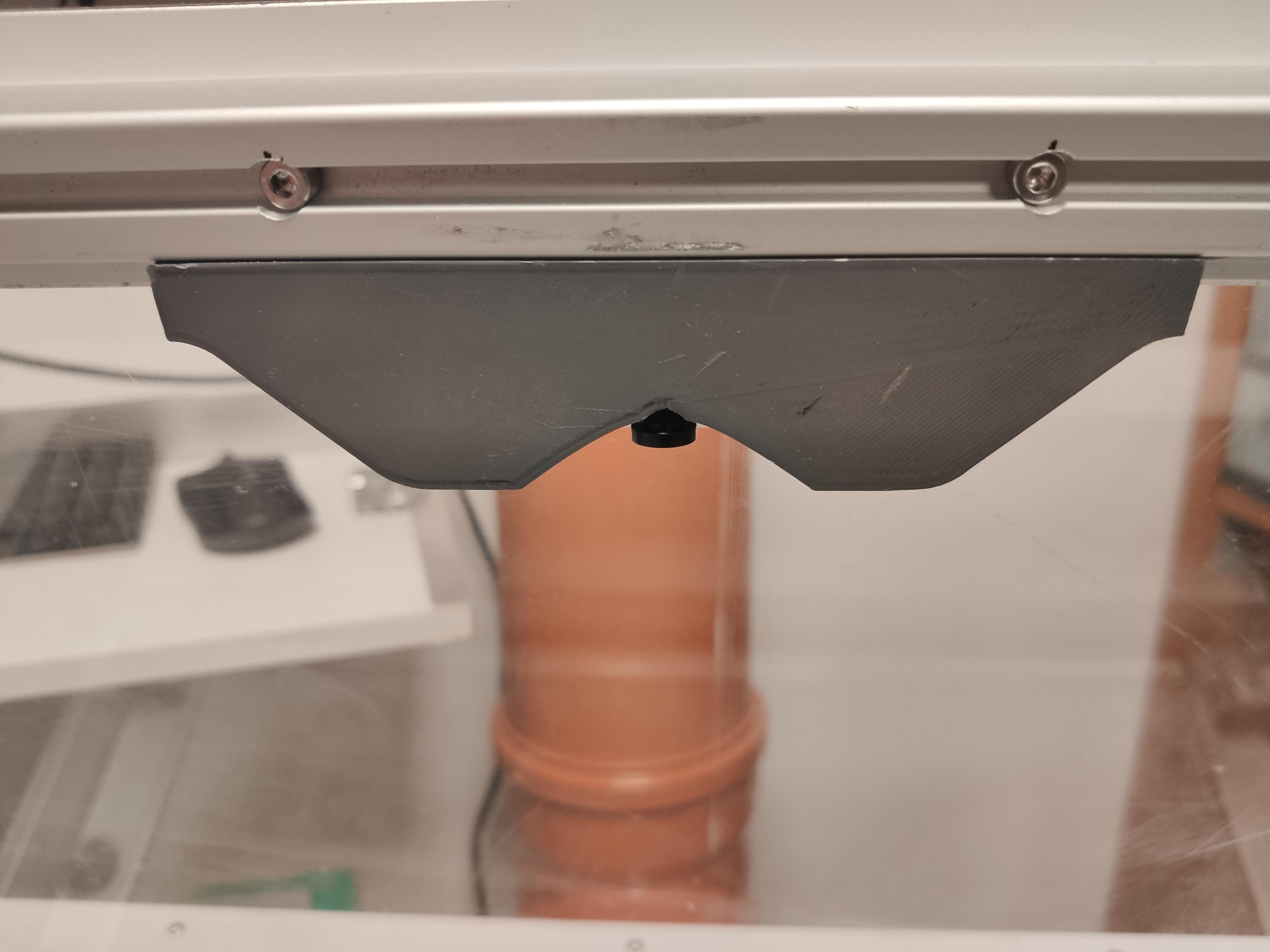

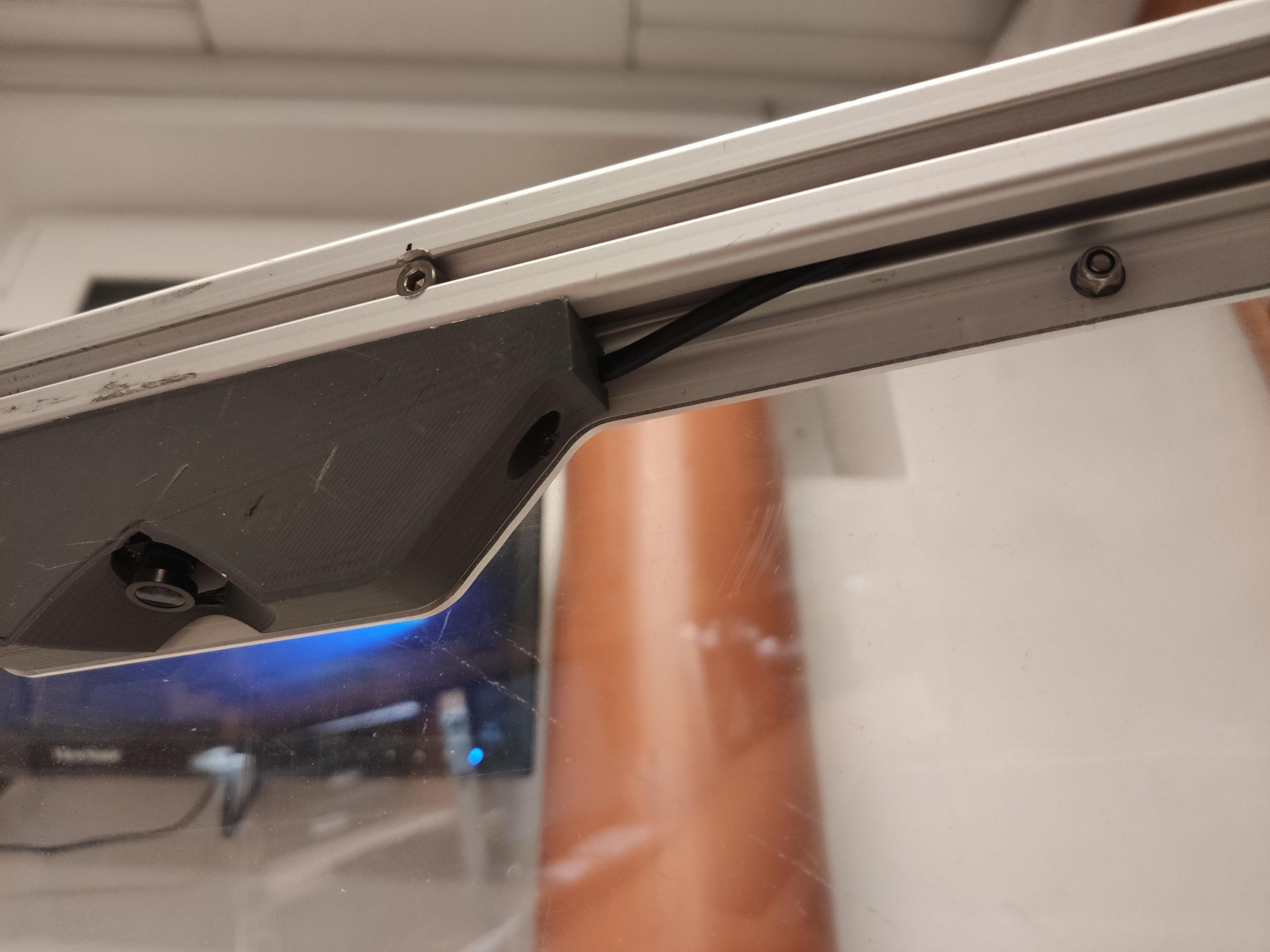

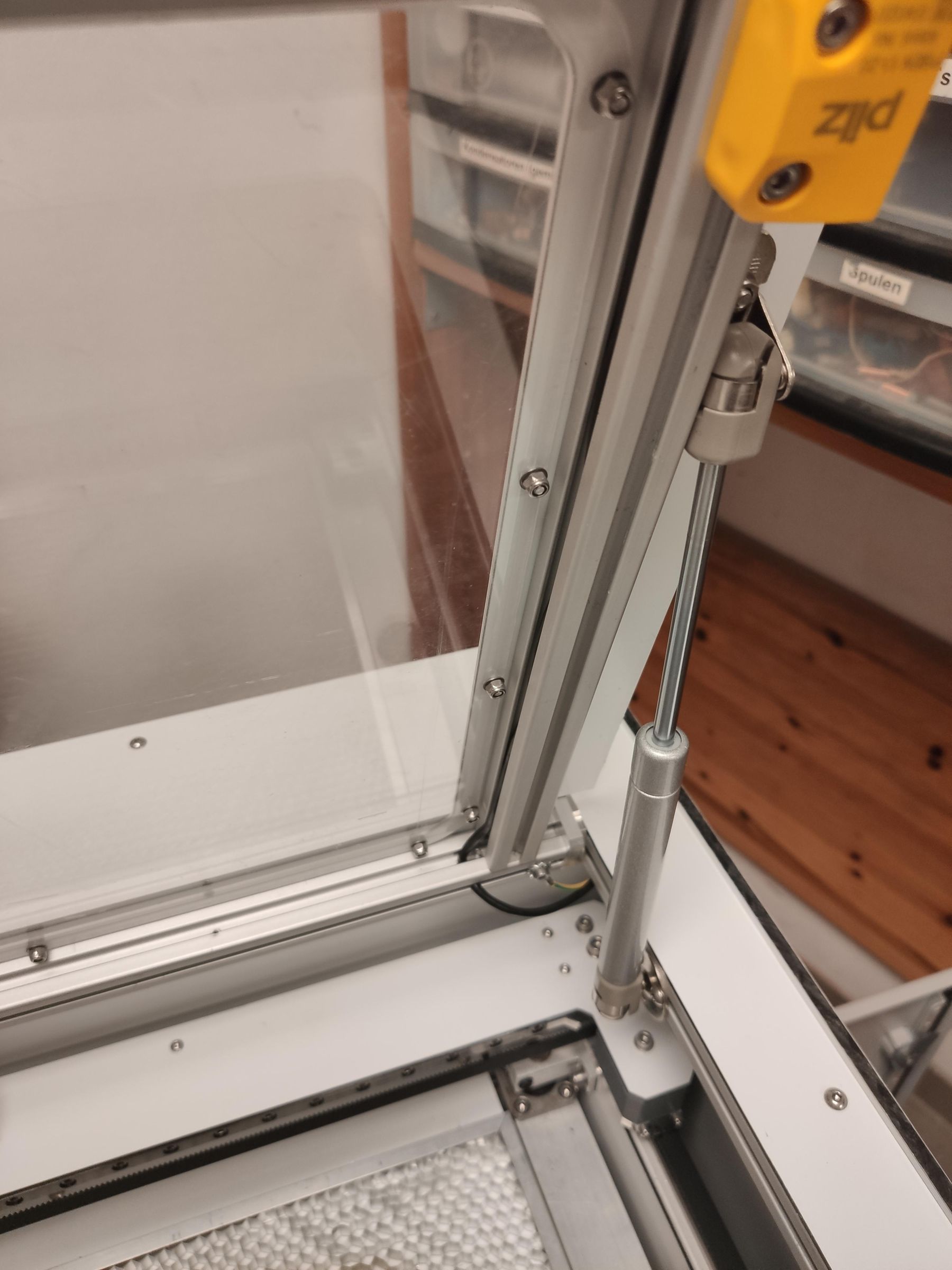

Step 22: Install the Door-Switch
The Door-Switch is one of the key components of the safety concept of this Laser! The switch will directly shut of the Laser, when the door is open.
For this I have used a certified Limit switch from Pilz. A PSEN 1.1-20

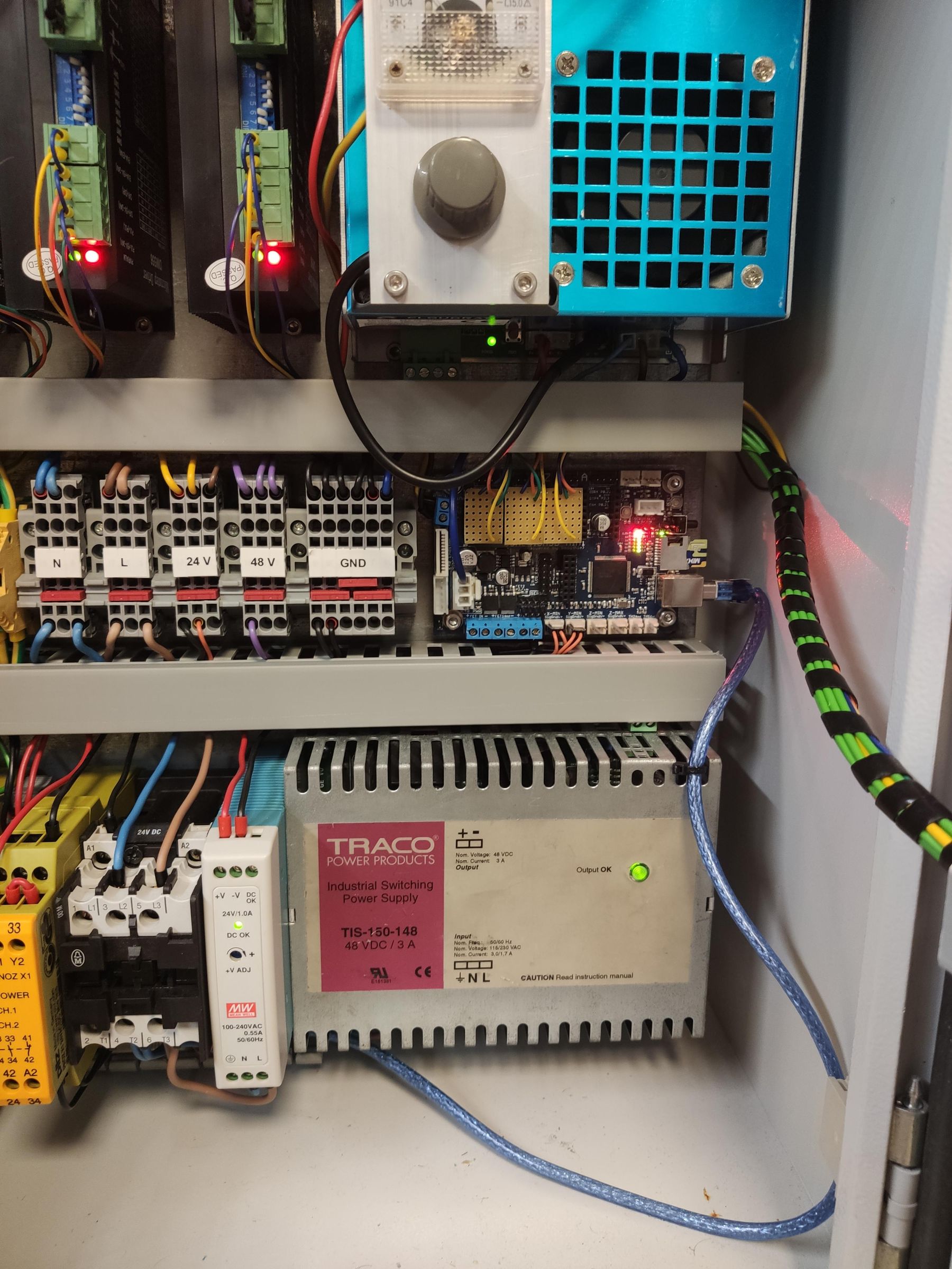

Step 29: The Power Cabinet
The Power Cabinet of the Laser is integrated to the Closet. For the Power Cabinet I have used a RITAL AE1045.500 .

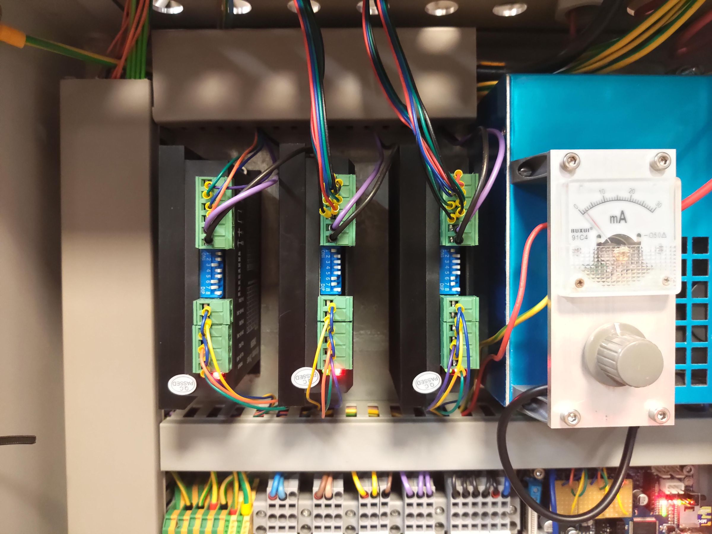

The electronics of the laser can be seperated in different groups:

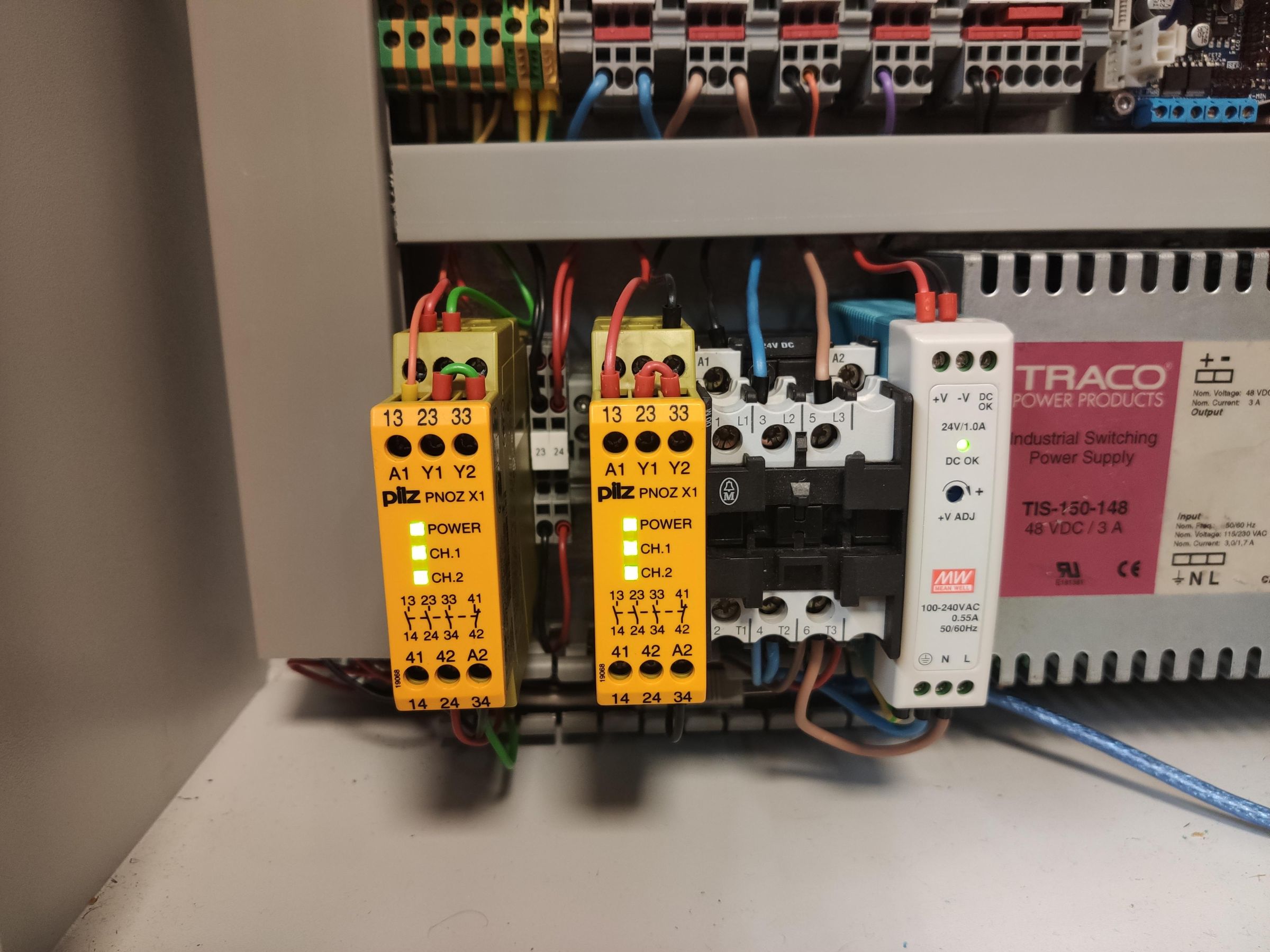

1. Safety Circuits:
The laser has two PILZ X1 Safety-Relays. One Safety-Relay is used for the emergency switch. If the emergency switch is pressed, the power contactor will cut of the main voltage. The other Safety-Relay is used for the Door-Switch and will disable the laser wenn the door is open. In addition to that, it will also switch an logic signal for my custom Z-Controller.

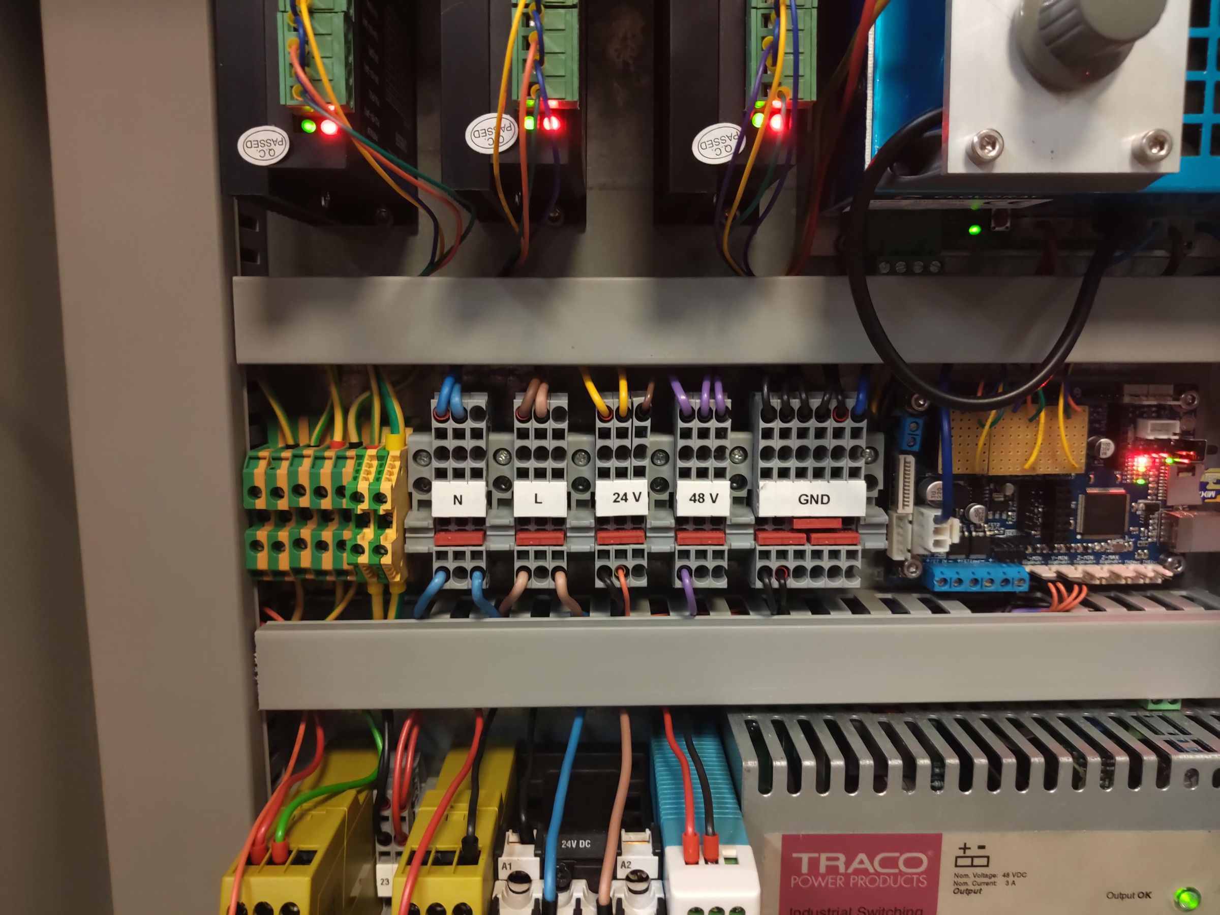

2. Power Distribution:
For the Power Distrubution of the requierd voltages for the Laser (230 VAC, 24 VDC, 48VDC), I have used DIN Terminal blocks. With these Terminals it is also easy to create a proper ground Management which is strongly requierd for this application.
3. Motordriver:
For the NEMA17 Steppermotors I have used DM556 5,6A 48V Motordrivers. Because of the high voltage of 48V, I could achieve high feedrates up to 1000mm/s, which is fantastic for my Laser.
Powersupplies:
For the Powersupplys I have used a 48V 250W for the NEMA17 Motors and a standart 40W Powersupply for the CO2 Laser Tube. The 24V Volts for the Cohension3D Board is also generated by the CO2 Laser Powersupply.

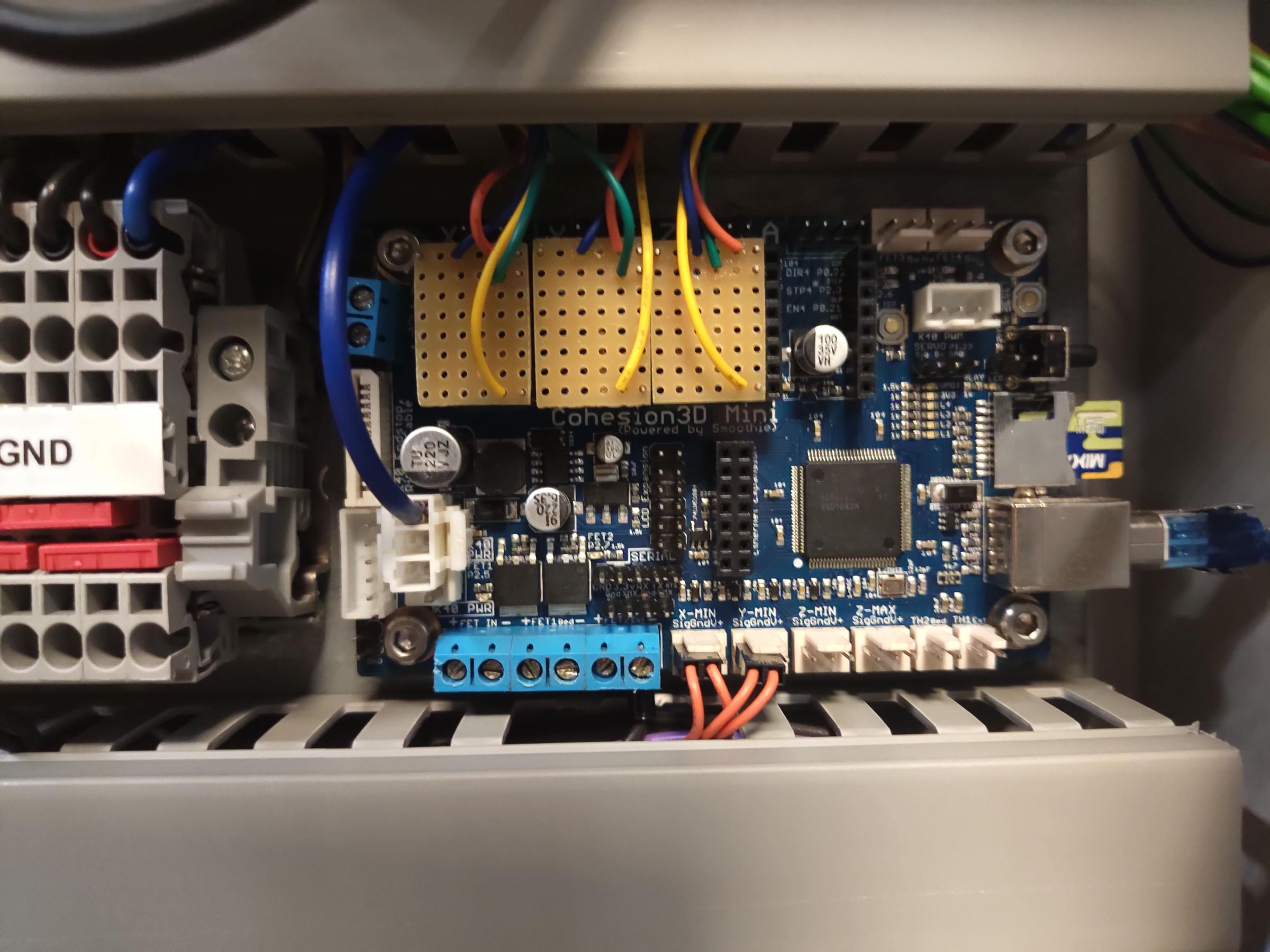

Cohension3D Mini:
As the Main Controller I have used a Cohension3D Mini Board from my old K40 Laser. This Board supports Smoothieware as Firmware and all the features which come from Lightburn. In addition to the Main Controller I have also created a dedicated Controller for the Z-Axis.

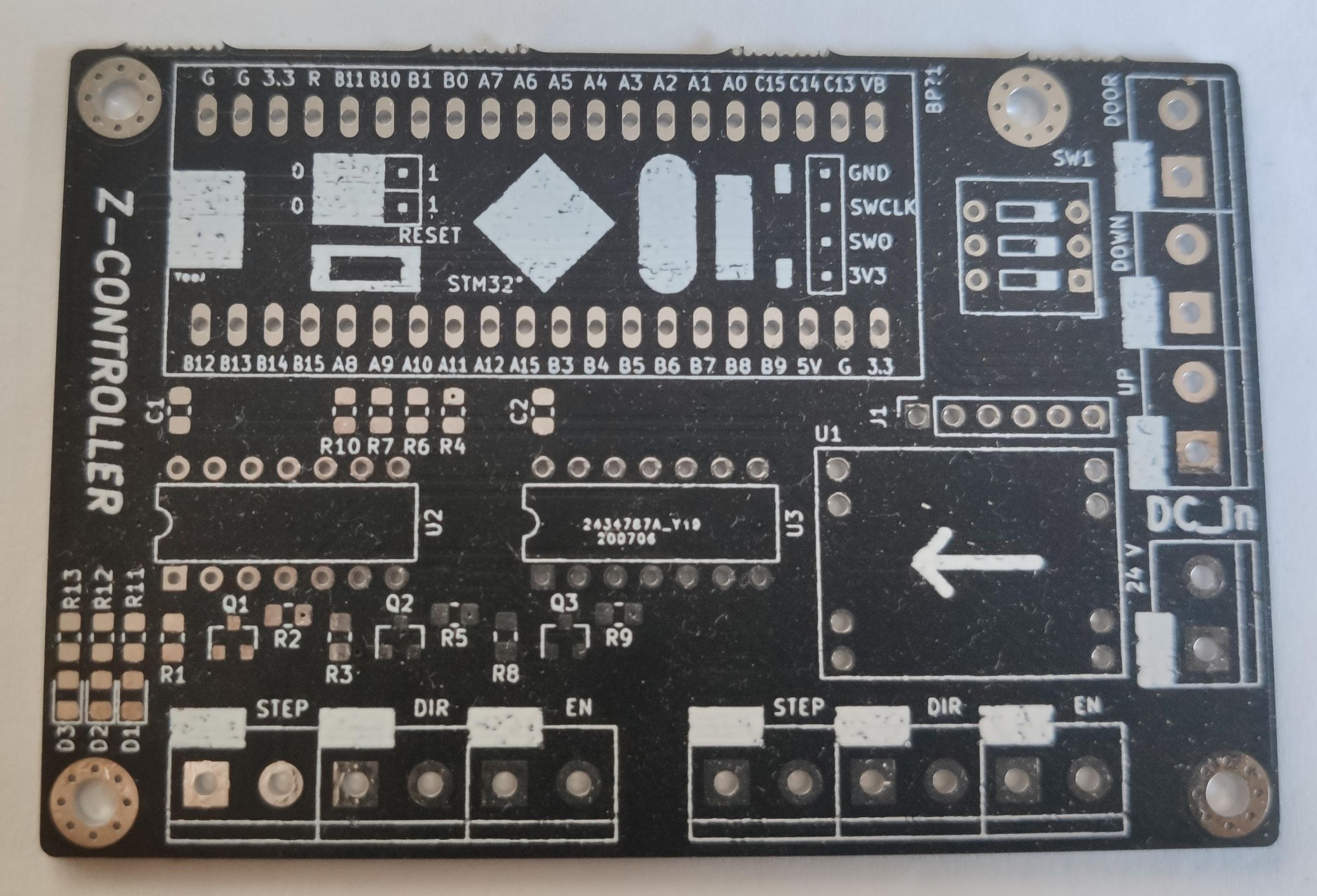

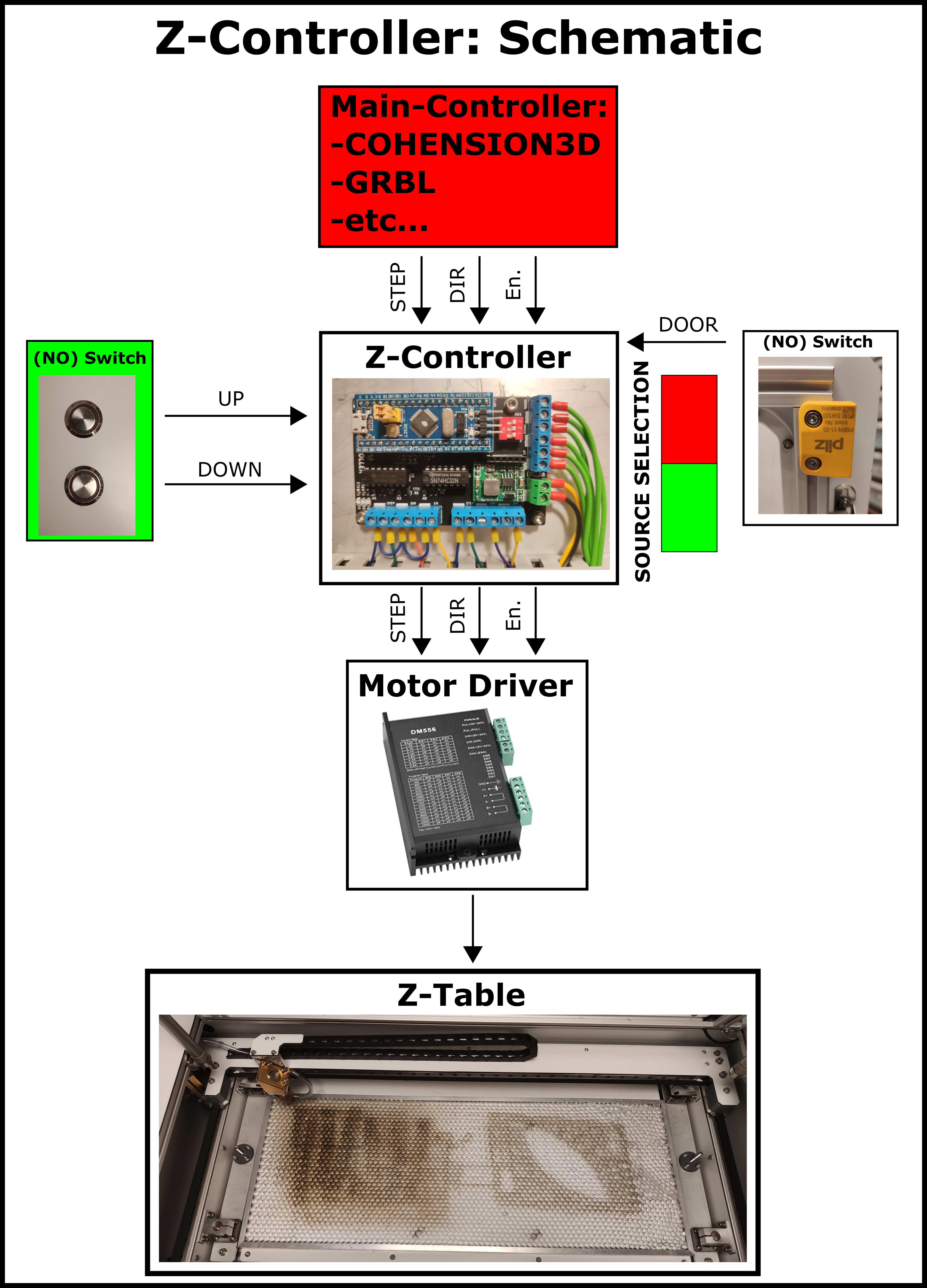

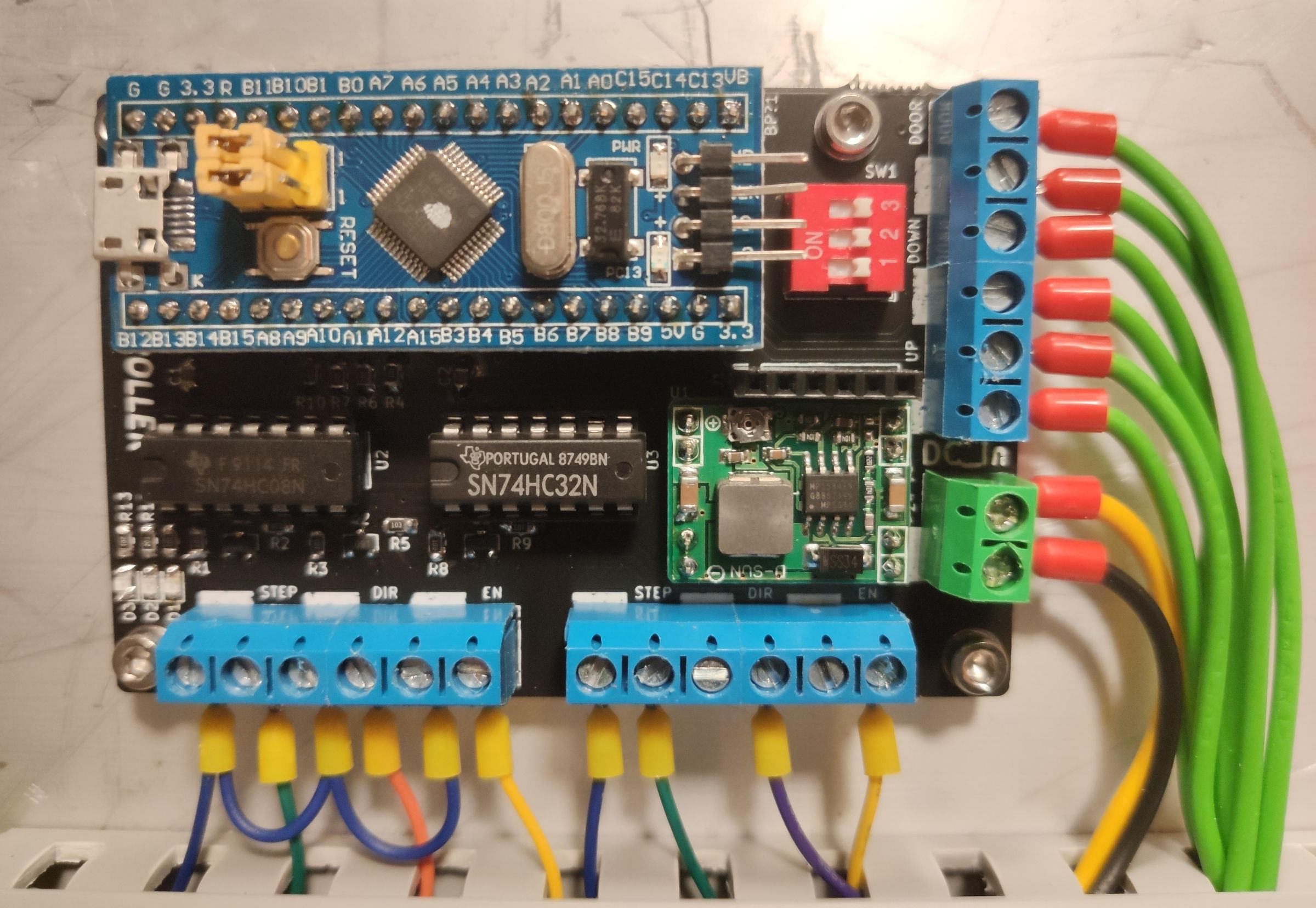

Step 30: Z-Controller

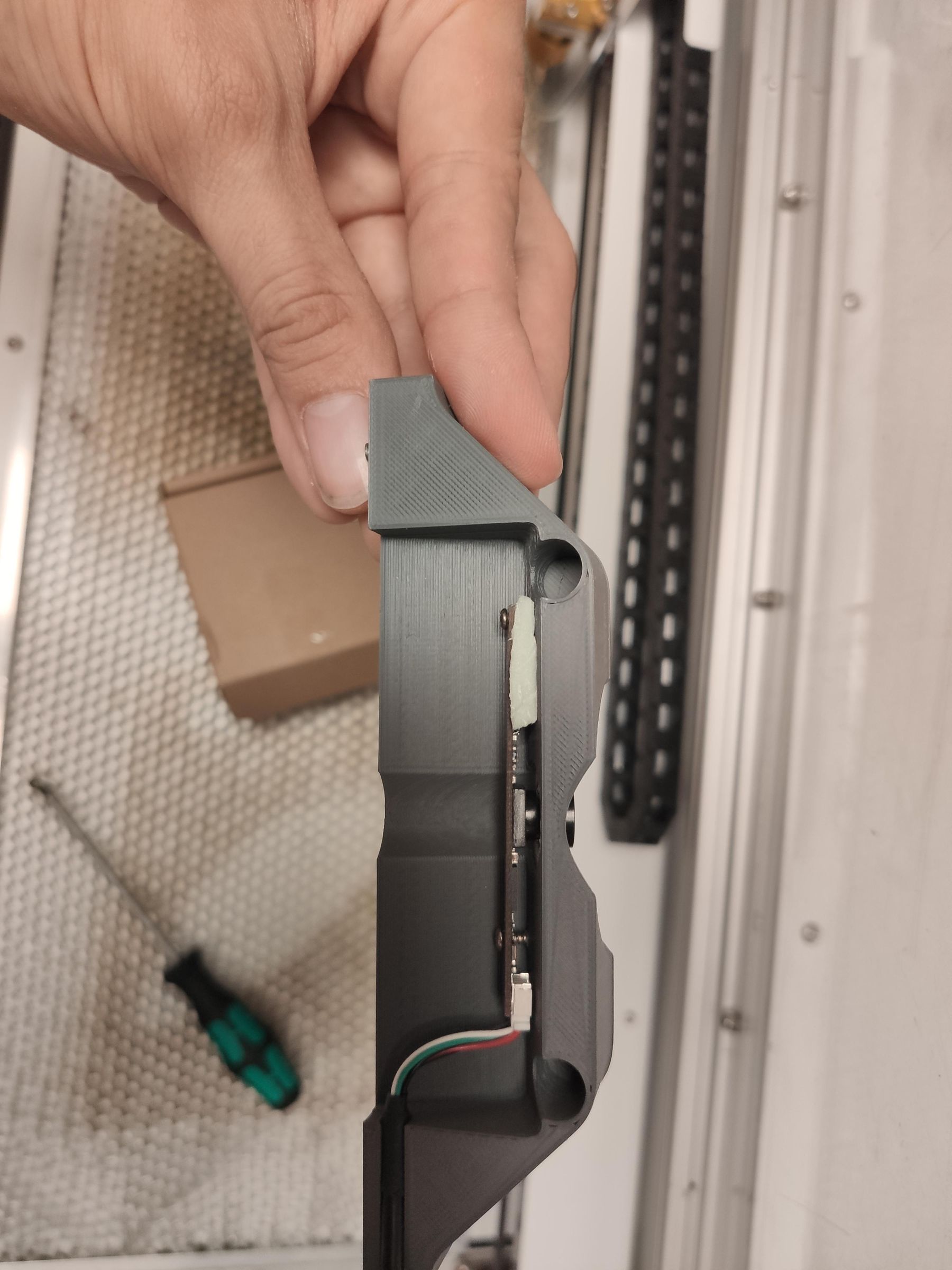

Manually focusing the Lens is really a Pain... ;) ,but I didn't found an allready exiting controller, which will support external Buttons to move the Z-Table, but will also enable Z-Movement by the Main Controller (in my case the cohension3d mini)
So I decided to build a small controller, which will enable both. Manual Movement of the Z-Table by two Normaly Open (NO) Buttons and automaticly movement for multiple Passes from the Main Controller. The decision, which source should power up the Z-Stepper-Driver, is made by the Door Switch. The following Schematic shows up the finished controller:
The finished Z-Controller has the following features:
- 24 V Input Voltage
-3,3 V - 5 V Logic compatible due Levelshifters
- adjustable step-frequency by DIP-Switches from 2,5-25 kHz
-Status LEDs
-STM32-Microcontroller
The controller is completely designed in KiCad. You can download all requierd files at the buttom of this step.
BOM:
Quantity | Description | Name on PCB | Link |
10x | 1k Resistor 0805 | R1-R10 | |
3x | 150 Ohm Resistor 0805 | R11-,R12,R13 | |
3x | LED Red 0805 | D1,D2,D3 | |
3x | AO3400 N-Channel MOSFET | Q1,Q2,Q3 | Aliexpress |
2x | 100nF Capacitor 0805 | C1,C2 | |
1x | SN74HC08 DIP-14 | U2 | |
1x | SN74HC32 DIP-14 | U3 | |
1x | Step-Down-Module (adjusted to 5V) | U1 | Aliexpress |
1x | Blue-Pill STM32F103C8T6 | BP1 | Aliexpress |
10x | 2P Terminal-Block 5.08mm | J2-J11 | Aliexpress |
1x | 3-way DIP Switch | SW1 | Aliexpress |
The PCB
To make it easy to rebuild the Z-Controller for your own Laser-Cutter, I have attached all the necessary Gerber-Files. If you want to buy the PCB, please take a look at my online-shop :-)
Programming
For the programming you will need an ST-Link Programmer
1. Download "STM32 ST-LINK Utility":
You can download the Software here
2.Install and open "STM32 ST-LINK Utility":
3. Now open the Z-Controller.hex file in the ST-Link Utility: After that you need to connect the STM32 "BluePill" to the ST-Link-V2. Once connected click on the "Connect to traget Button":
Finally click on "Download". Now your STM32 should be flashed correctly.
I have attached all the source files for the Z-Controller in STM32CubeIDE
You can download all the Files from:
https://drive.google.com/drive/folders/1YH9y8L95i7aFf3WLhmoabTCOOZTjS4DI?usp=sharing

Step 31: Install the Camera for Lightburn:
To enable one of the coolest features of Lightburn, you will need to install a camera and set it up like here. Then you will be able, to map your engraving field with an picture of it and you can easily allign your laser job.
Because I don't wanted to see the camera in the middle of my safety window, the camera is installed in the notch of the window.
The USB-Cable from the camera is attached to the alumnium extrusions of the top door:
Example usage of the camera
Here I will show you how the mapping of the engraving field in Lightburn and the camera works.

Allready Planed Upgrades (but waiting for Parts):
- Integrated Stainless Steel Water Tank + Radiator
- Full enclosure of the closet in white Dibond
- Rotary-Axis
- Better Z-Table + Axis
- Additional controller to display the current of the Tube digitally
Current State of the Machine
Judges Prize in the
CNC Contest 2020
