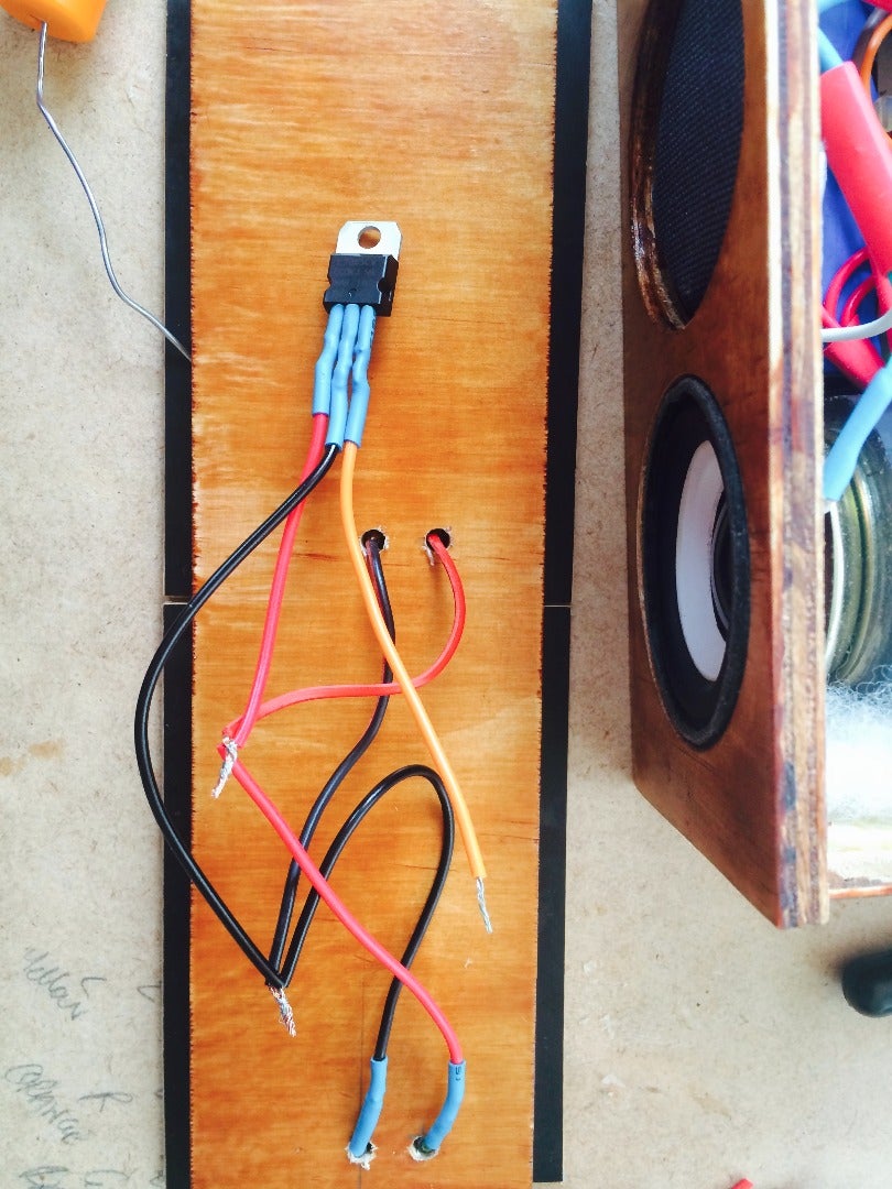

Solar Panel:
The wiring for the Solar Panels and the 5V regulator has not been included in this diagram, please refer to the solar panel wiring step later in the instructable.

Step 22: Wiring the Solar Panels
1) Wire the solar panels in Parallel
If you are using multiple solar panels, they will need to be wired in Parallel – this way the amperage of the solar panels will double rather than the voltage. This means the positive wire (Red +), will need to be connected to the positive wire of the other solar panel, the Ground wires (Black -) will also need to be connected to each other as well.
2) Wire the 7805 Regulator
Input: Connect the positive parallel wires from the solar panels to the input pin.
Ground: Connect the Ground Pin to the Ground Parallel wires from the solar panel - These three wires will then be connected to the Input (-) terminal wire from the Micro USB Battery Charging Module, which was soldered in step 12.
Output: Connect the Output Pin to the Positive Cable from the Input (+) on the Micro USB Battery Charging Module
3) Test Solar Panels w/ Battery Charging Module
If the solar panels are charging the battery, you should be able to see the red LED Light turn on the Battery Charging Module.
