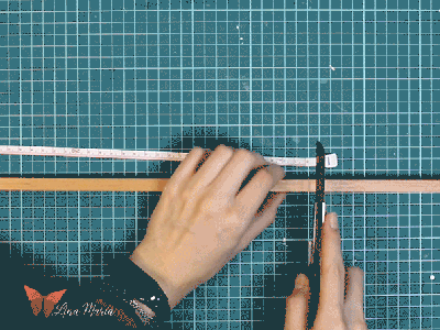

Cut the stick in half. And one of those halves cut it in half too.
Step 3:
The other will also be cut in half but slanted. For this, mark a point in the middle, and with the ruler mark an inclined line that passes through that point, then cut.
