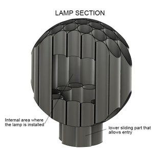

I started from a hexagon made up of 37 tubes of Ø50 x 1.8 mm thick.
Then I made a sphere with a diameter of 360 mm whose intersection cuts out the 37 pipes, configuring the rough design of the lamp.
The design provides for an area inside the sphere to place the lamp and allow the light to spread sideways and up and down.
To access the interior through the bottom of the sphere, a group of 7 joined pipes later called "Bottom Pole" can slide smoothly down to allow the hand to reach in and add or change a bulb.

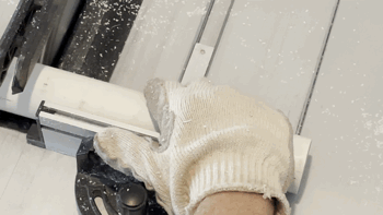

Step 3: Straight Cut Pipes
PVC is a very easy material to cut. In plumbing works, the use of manual cutting tools is very common.
In my case I chose my table saw.

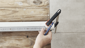

Before cutting, it is necessary to mark with a pencil the dimension of the different pipes (according to the plans) and also indicate the type of pipe (0,1,2,3,4 and 5), information that will be useful when assembling the sphere.
To mark the measurements of the pieces, fix the pipe to a table or workbench with carpenter's press.
When measuring keep in mind the size of the saw to avoid that the size of the pipes is less than what is indicated in the plans.
when cutting it is convenientt use personal protection elements such as glasses, headphones and gloves.
Step 4: Angled Cut Pipes

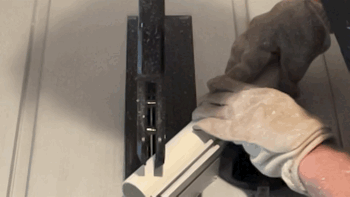

With the table saw (or other appropriate cutting method), being very careful, you can apply the angled cuts of the pipes type 1,2,3,4 and 5 either by varying the cutting angle of the table saw or also with the rulers with angle guide that bring this type of tools.
Be very careful with the sharp edge of the PVC.
You can avoid injuries by always wearing gloves.

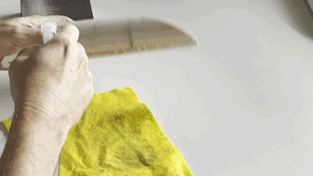

Step 5: Cleaning and Sanding Pipes
This step is rather boring.
But believe me, it is very important for your work to look neat and correct.
It is also an essential condition for the correct gluing of the pipes.
PVC pipes usually come with inscriptions of ink and dirt.
First, spray on ethyl alcohol and wipe each pipe with a clean rag.
Then sand with the help of sanding sponges. First "fine" and then "semi fine".
Apply coarse sandpaper to the edges of the pipes, taking special care with the edge of the PVC.
After sanding, spray ethyl alcohol again and do final cleaning.

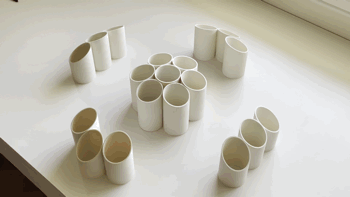

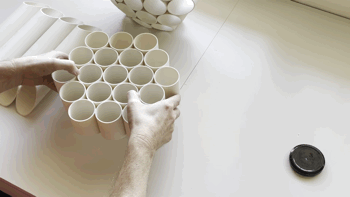

First, we will assemble the two poles of the sphere: 2 hexagons with 7 pipes, with a type “0” pipe in the center and 6 type “1” pipes on the perimeter. We will mount the "top pole" and the "bottom pole".
Before gluing, position all the pipes, adjusting their position so that the upper surface is left with a uniform curve of the sphere.

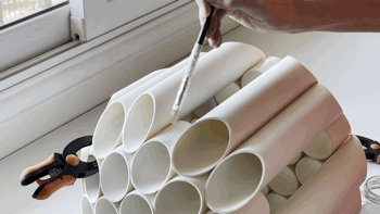

Apply glue for PVC pipes on the area of the pipes where there is contact with the others, with the help of a brush.
Even though the PVC can be glued with any type of adhesive, I suggest doing it with PVC glue used in plumbing to join the pipes with their accessories.
This type of glue is quick drying, so be sure to apply the glue and quickly press the pipes together with joinery clamps to create immediate bond.
In order for the set to stick firmly, it may help to fasten the set with string or a ribbon or an elastic as well.

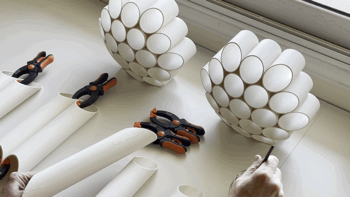

Type “5” pipe gluing:
Position six pair of type “5” pipes and glue them together as seen in the photos. You can use joinery clamps to perfect gluing.
Assembly of the total set:
Place the two half spheres supported as indicated in the figure, separated at a distance of approximately 156 mm.
Position a pair of type “5” pipes and glue them as indicated in the photos.
Use joinery clamps for perfect gluing.
Go turning the assembly through the axis of the sphere that crosses the two semi-spheres and glue other pairs of pipes type "5" until completing the six.
Finally position the pipes type "4" in the places and glue them as indicated in the photos.
Also rotate the set and paste until you complete the sphere.

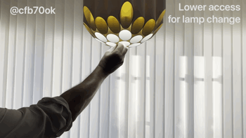

Place the lamp inside the sphere, inserting it through the lower part of the lamp, removing the sliding "bottom pole". Once the lamp is in place, put the sliding bottom pole back in place.
