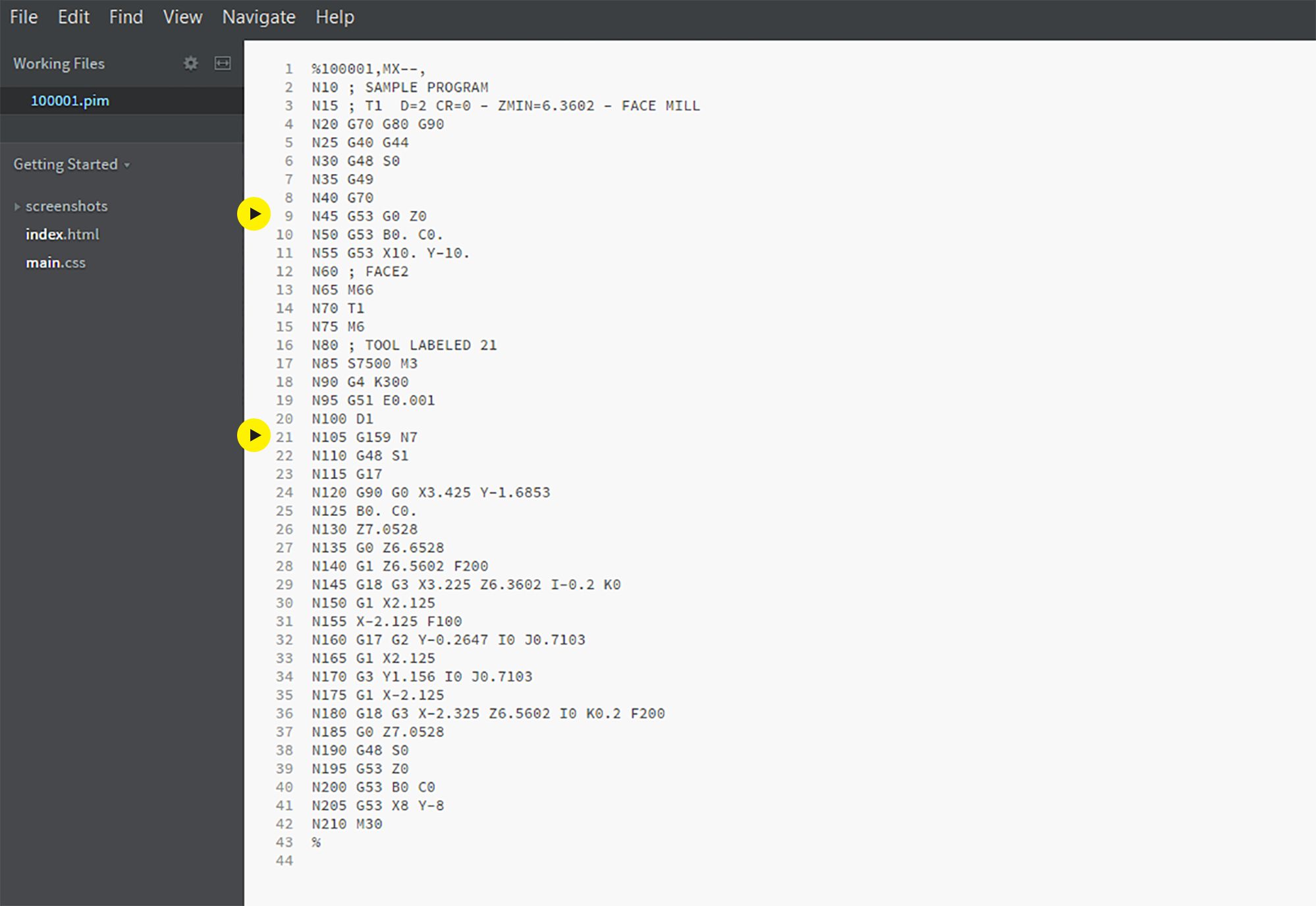

5) Write a description comment, and then post your code to a USB drive.
6) In the editor, verify that after the first tool change, your code calls out G159 N7.
Using Ctrl + F, the Find command, can be useful when searching through G-code.
Remember that G53, in the code header, specifies the Machine Coordinate System. G159 N7 is the Work Coordinate System.

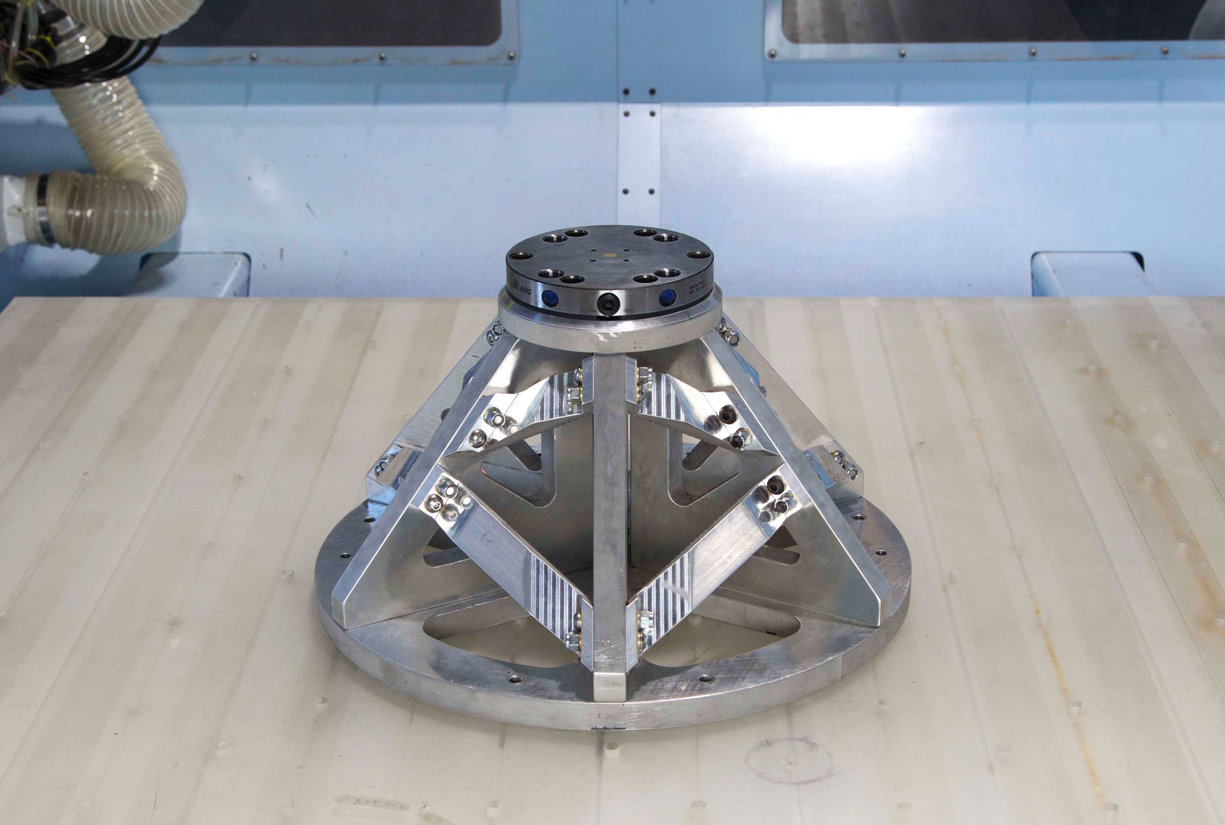

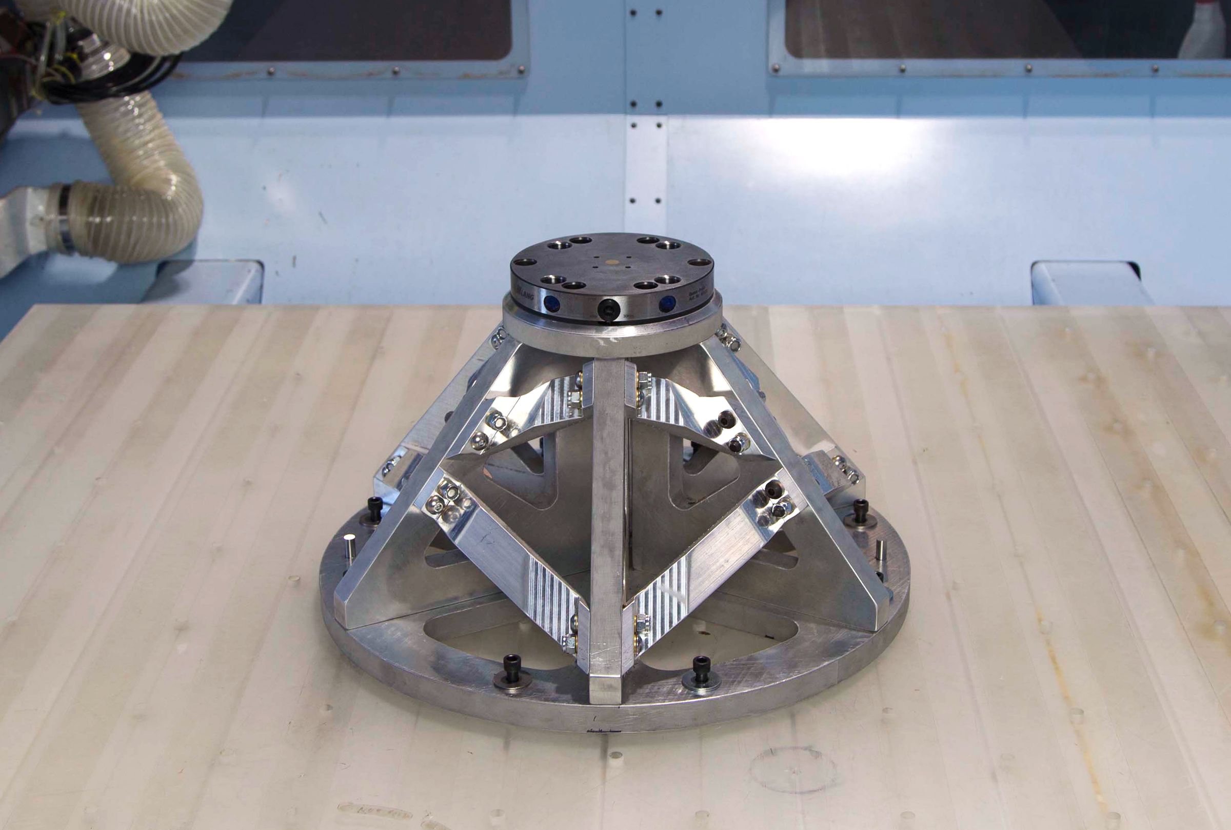

Step 4: Setting Up Stand

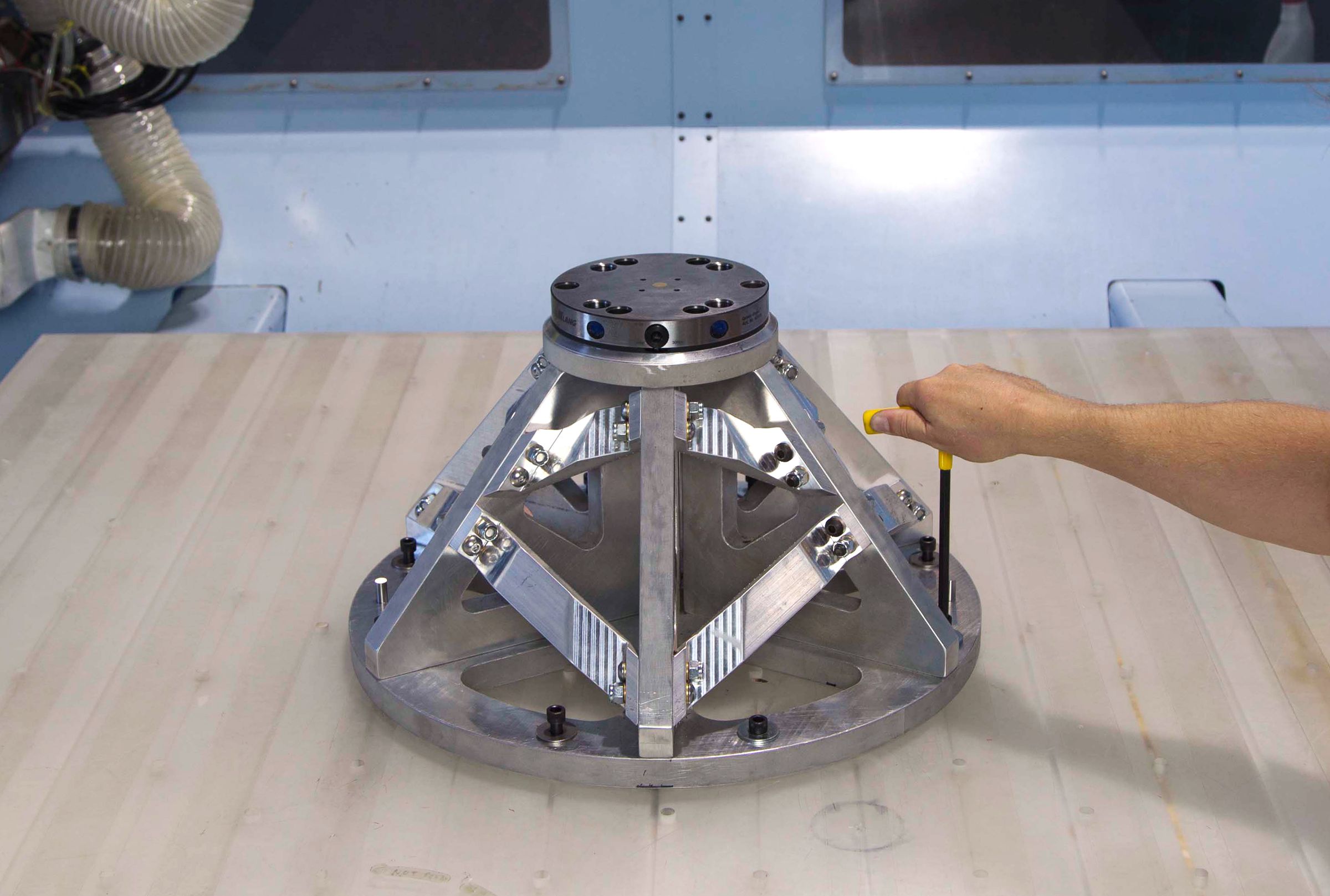

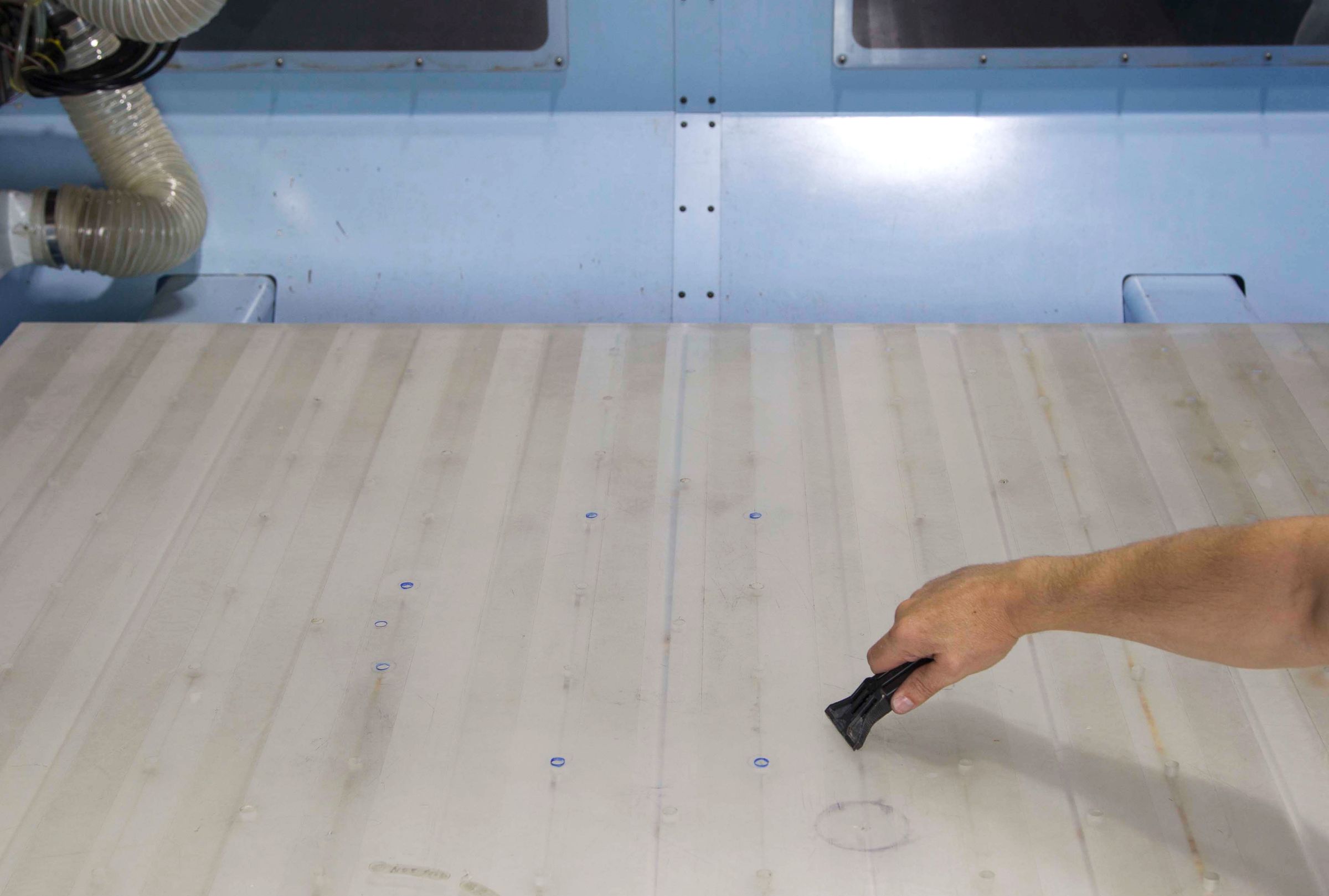

1) Find the 3/8"-16 holes on the acrylic bed of the DMS that have been marked in blue. Use compressed air (on a hose behind the back right corner of the machine) to blow out chips. Use a scraper to remove any irregularities on the surface of the acrylic.

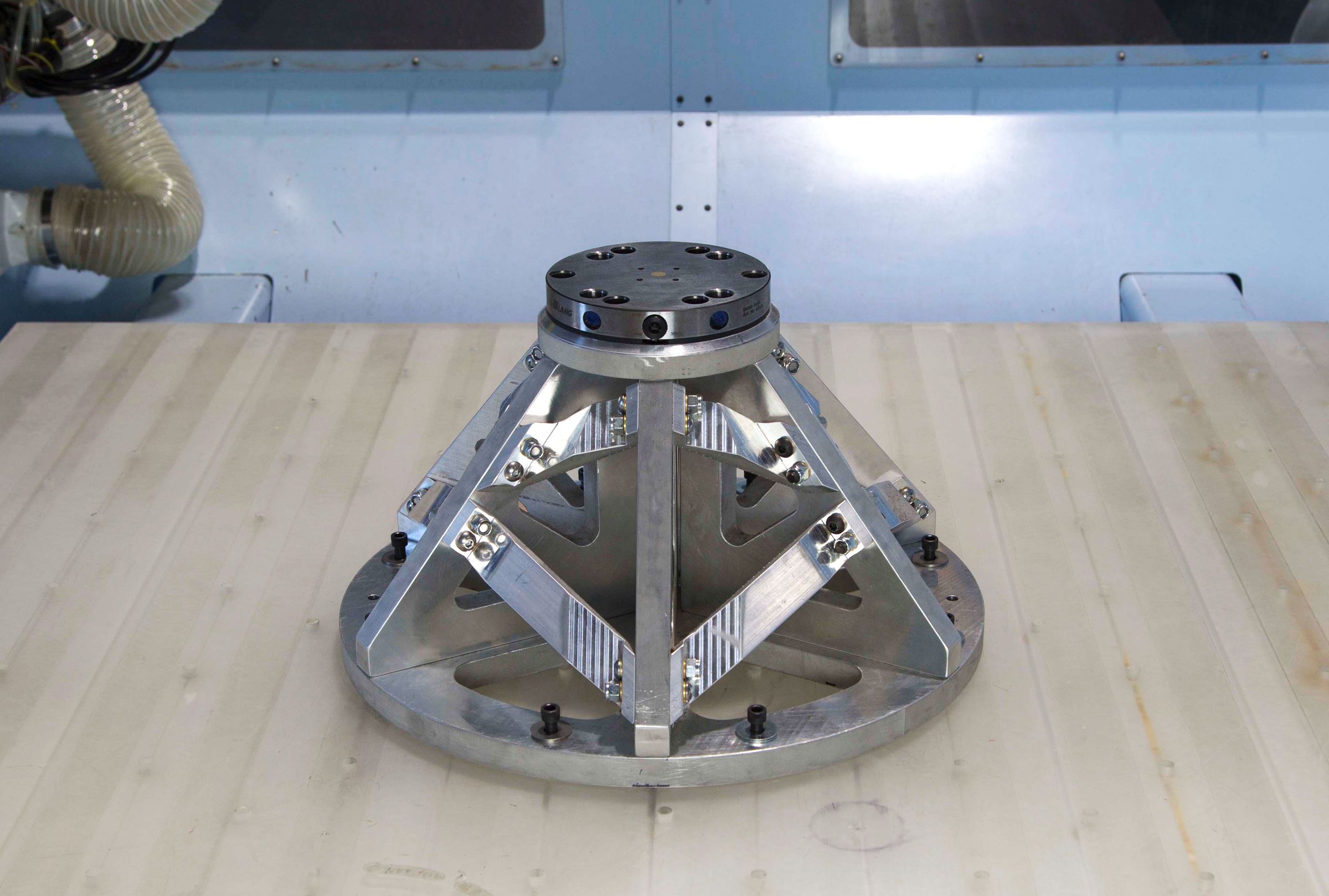

2) Place the DMS stand on the machine bed. Line up the stand's through-holes with 3/8"-16 holes in the acrylic.
3) Hand-tighten eight 3/8"-16 screws and washers to align the stand and machine bed.

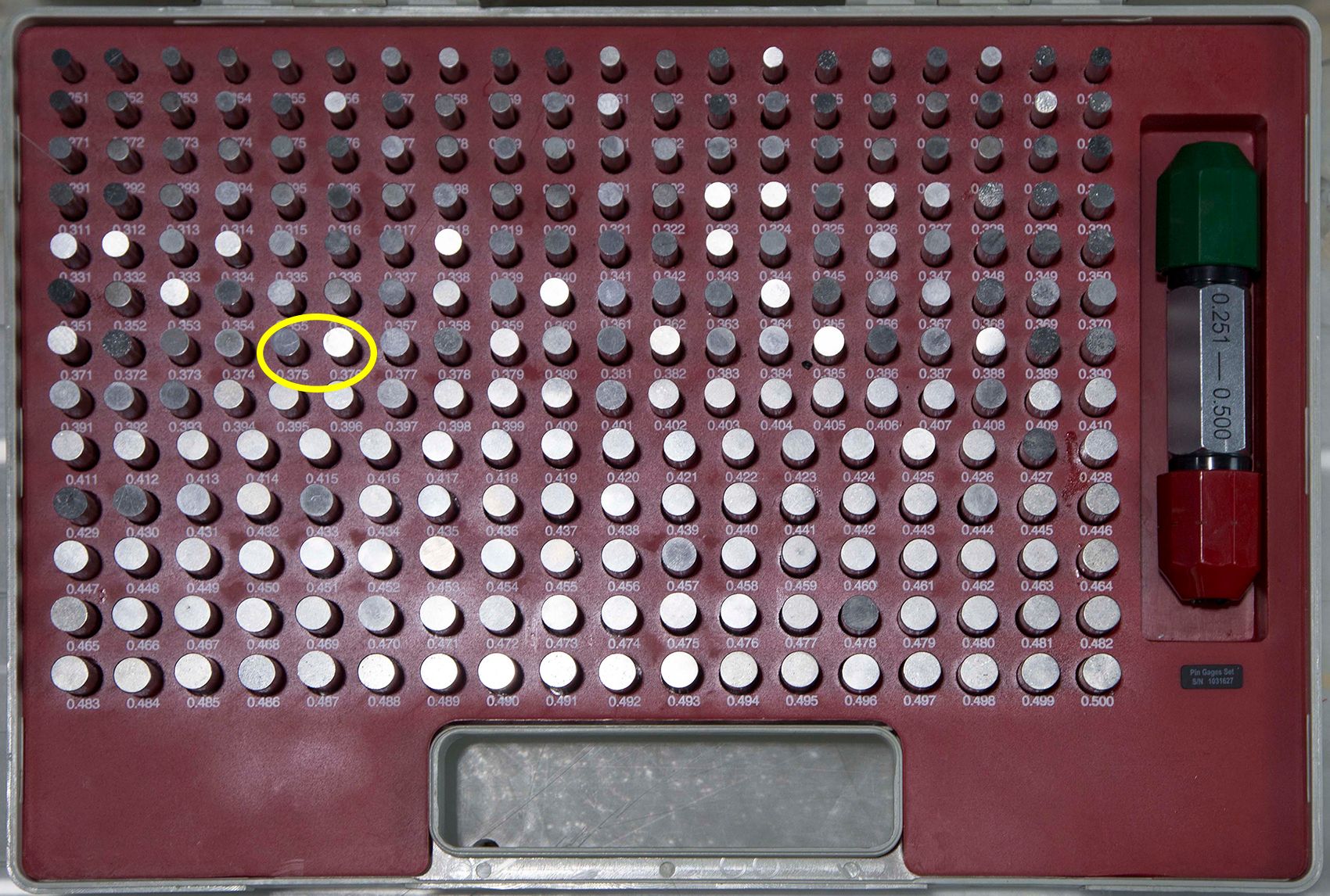

4) In the Workholding drawer of the DMS Lista cabinet, select pin gauges 0.375" and 0.376".
5) On the right and left side of the DMS stand, place the registration pins through the stand and into the acrylic bed.
These pins precisely locate the stand to ensure that the Work Coordinate System G159 N7 is accurate and repeatable.
If you have trouble aligning the pins, try inserting pins 0.372" and 0.373", and then build up the final sizes.
6) Tighten screws with a 5/16" allen wrench.
8) Remove pin gauges and return to the correct location in the Workholding drawer.

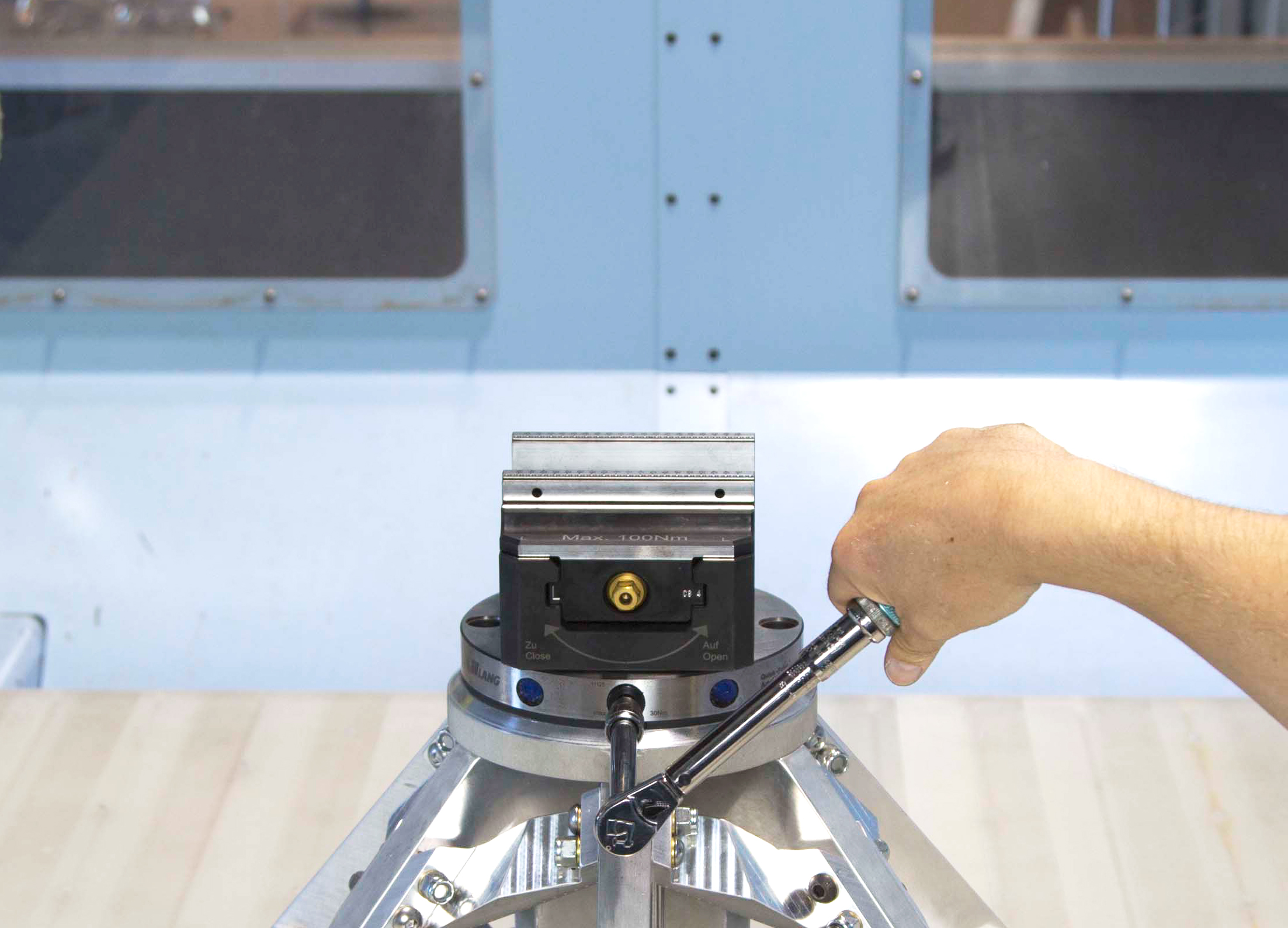

Step 5: Attaching Lang Vise to Stand
If you are using a Makro Lang vise with rectangular stock, here are the steps for installing the vise and securing your stock.
1) Clean the receiver plate and vise with a dry cloth to remove chips and debris.
Any chips trapped between the two can damage the vise and receiver plate, and can cause tolerances to decrease over time.
If necessary, remove blue hole plugs by cupping your hand and using compressed air. For holes you will not need, replace blue hole plugs to prevent chips from getting inside the receiver.
2) Ensure the 8 mm allen bolt in the front of the receiver plate has been turned counterclockwise enough to allow the vise to sit flat on the plate.
3) Install vise by placing clamping studs in the bottom of the vise inside the holes in the receiver plate.
Ensure the front of the vise is facing you. The front jaw will have the letter L, indicating that the threaded rod that closes the jaws will tighten the jaws when turned clockwise. The front jaw will also indicate the maximum torque, 100 N m.
4) Secure the vise to the receiver plate.
Use an 8 mm allen driver on the blue handled torque wrench set to 30 N m. Review Lesson 2 for a reminder on how to set torque levels.
Tighten until the wrench disengages with a clicking sound.

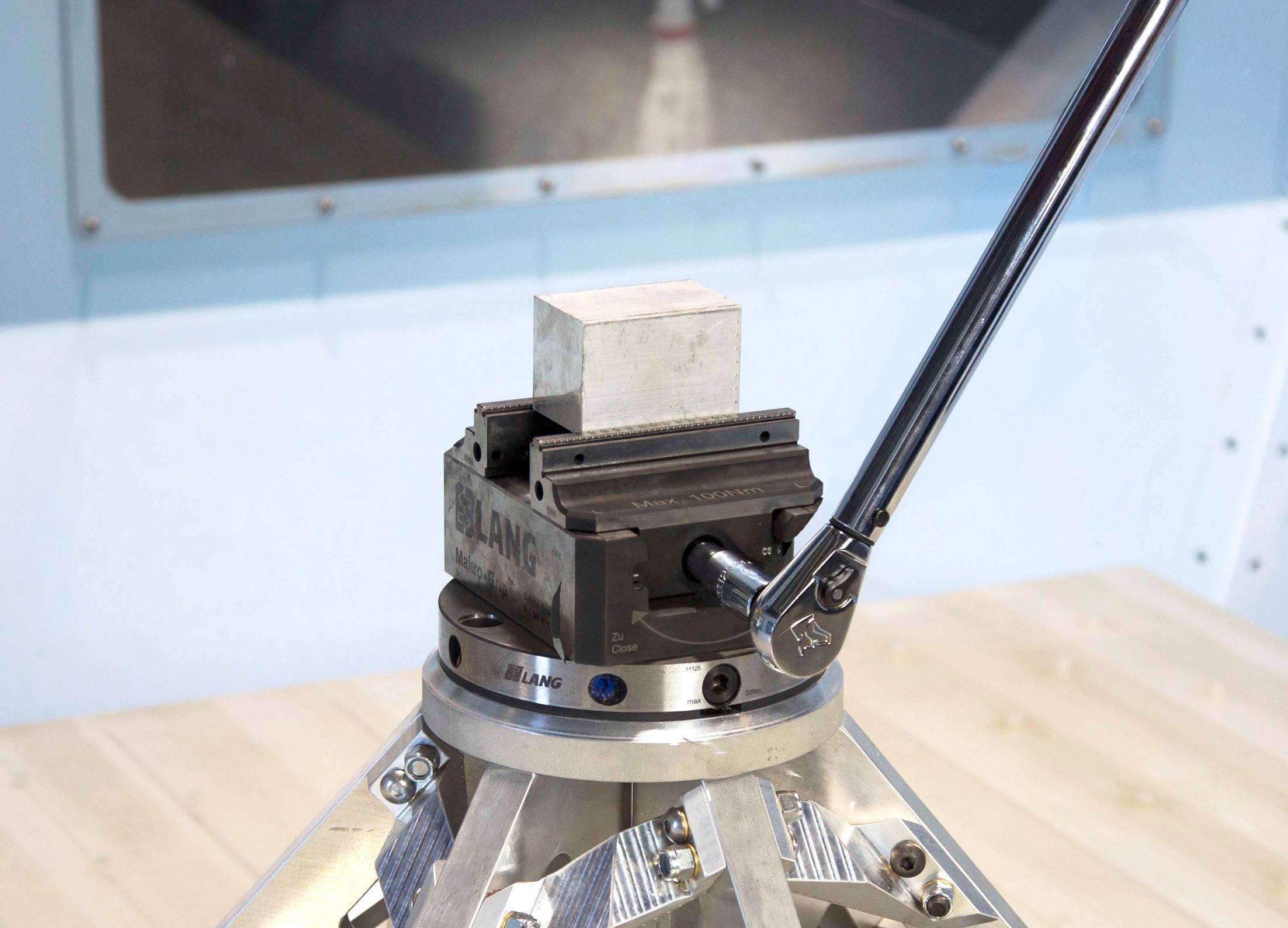

5) Install stock in vise.
Center the stock in the vise jaws with the tick marks along the jaws. If needed, use calipers.
Use the 12 mm socket on the black handled large torque wrench, set to 100 N m.

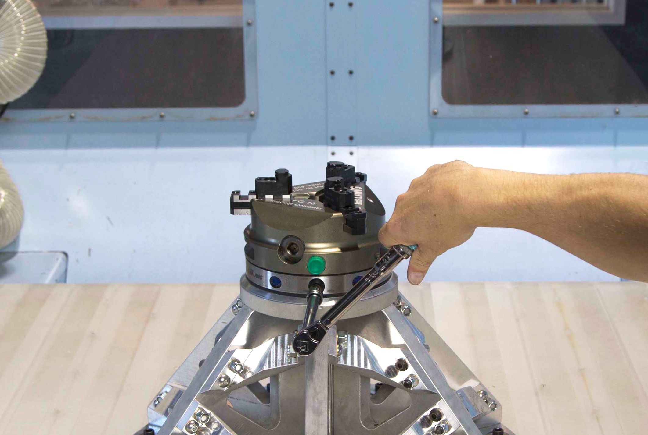

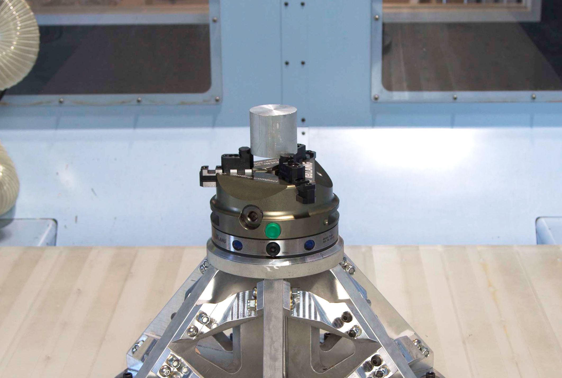

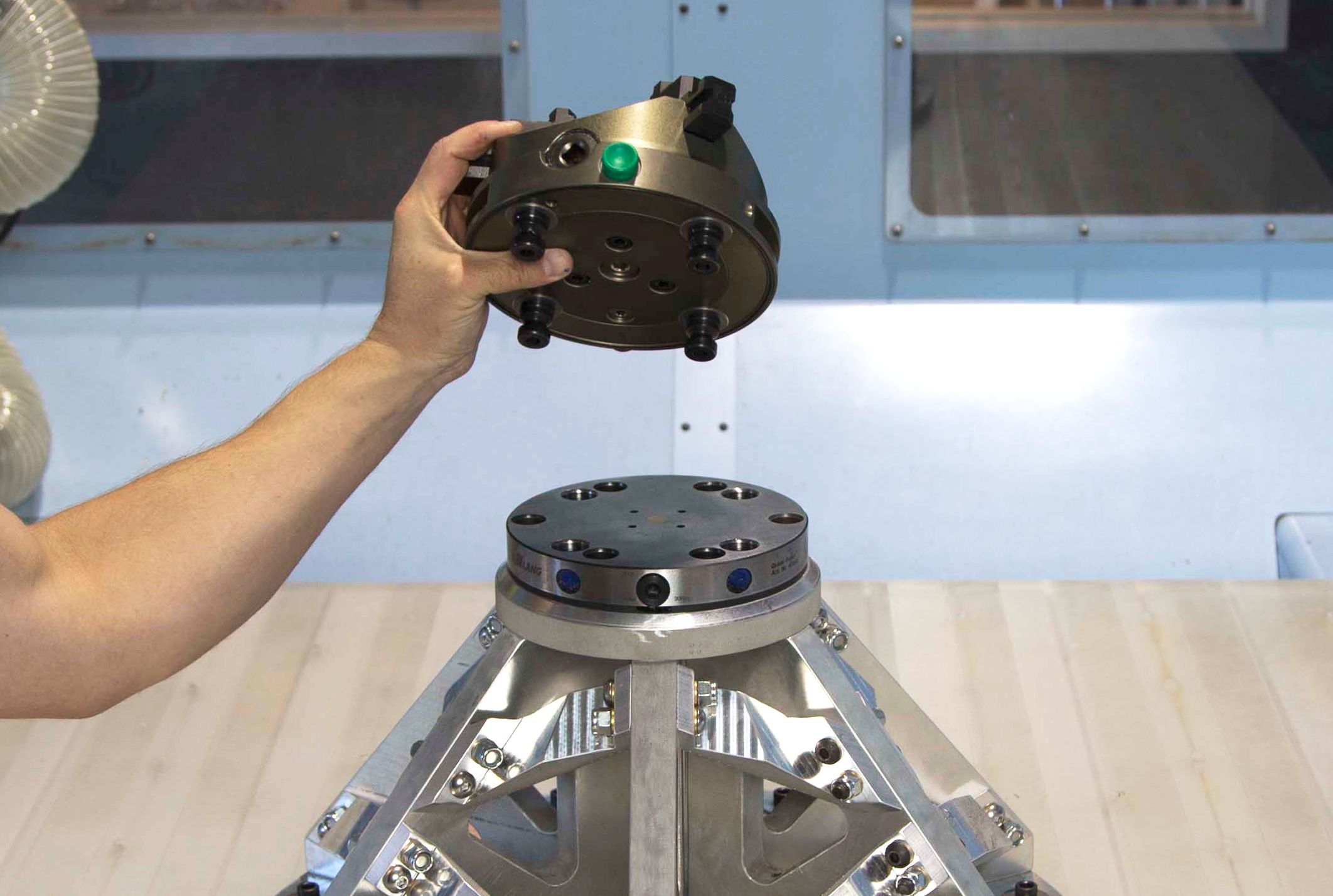

Step 6: Attaching 3-Jaw Chuck to Stand
If you are using cylindrical stock with the 3-jaw chuck, here are the steps for installing the chuck and securing your stock.
1) Clean the receiver plate and chuck with a dry cloth to remove chips and debris.
2) Ensure the 8 mm allen bolt in the front of the receiver plate has been turned counterclockwise enough to allow the chuck to sit flat on the plate.
3) Install chuck by placing clamping studs in the bottom of the chuck inside the holes in the receiver plate.
Ensure the front of the chuck is facing you. The 10.9 mm square socket should be slightly left of center.
4) Secure the chuck to the receiver plate.

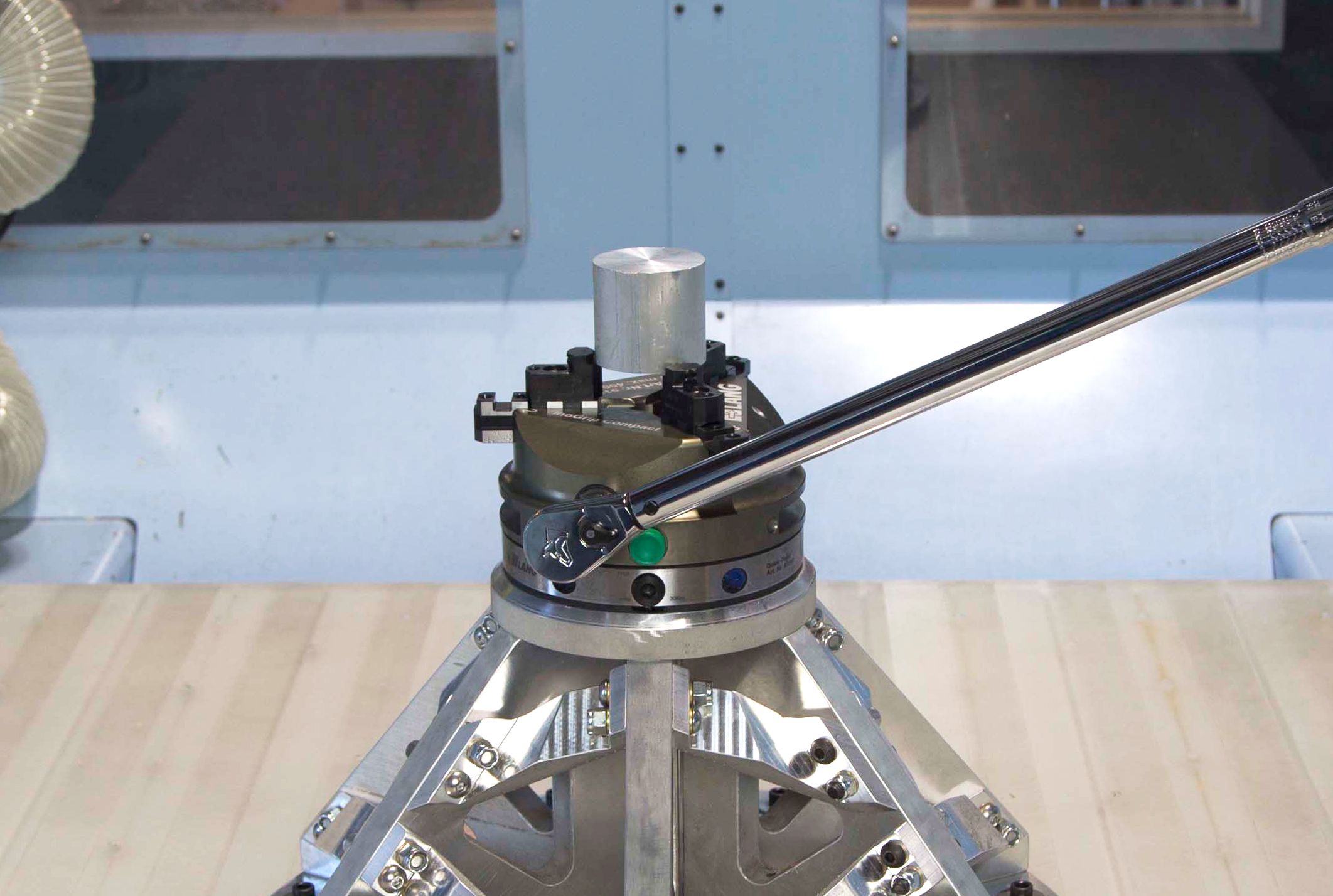

5) Install stock in chuck.
Center the cylindrical stock in the chuck jaws and place in the "high" or "low" position.
Use a 10.9 mm square driver on the large black handled torque wrench set to 70 N m.

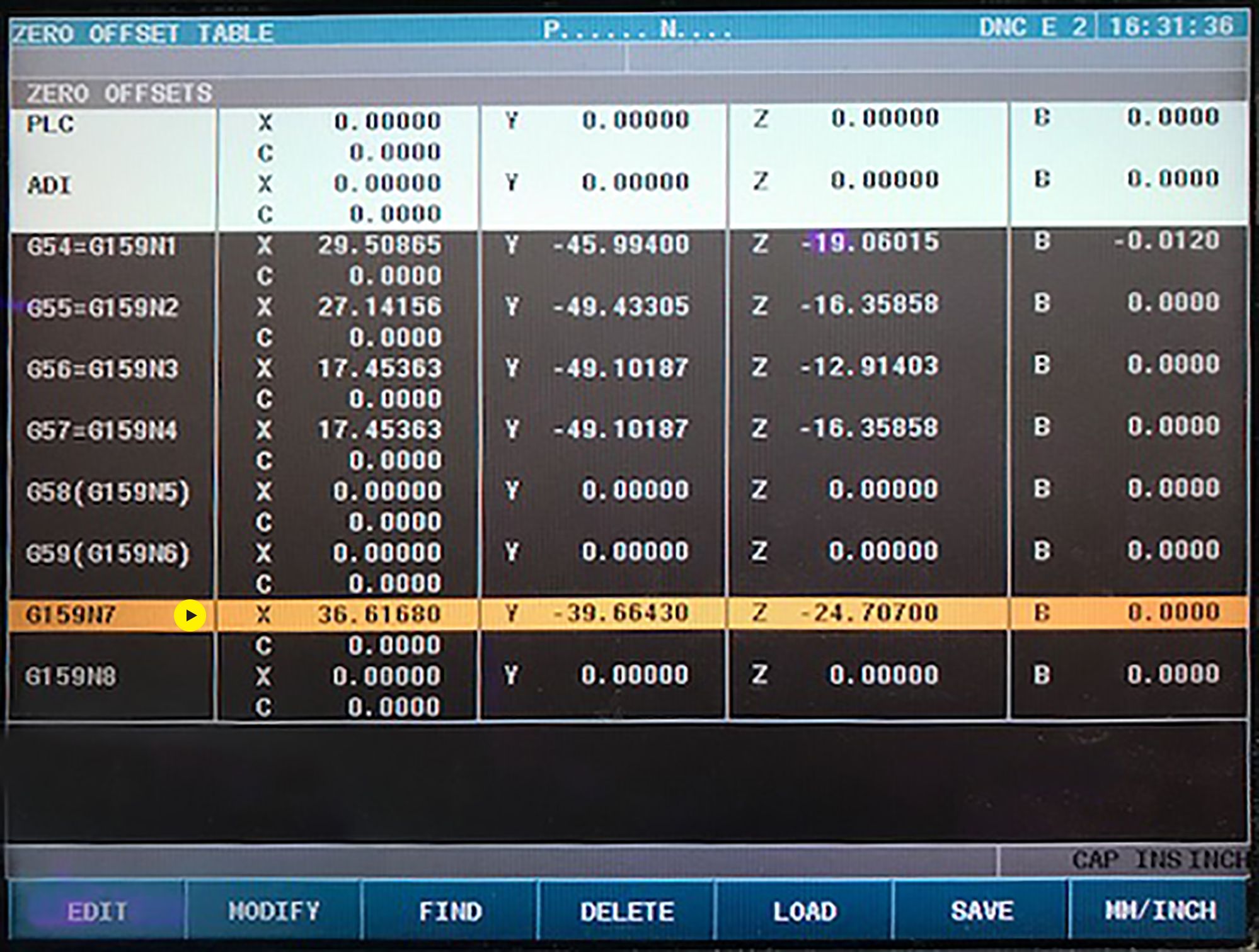

Step 7: Verifying WCS G159 N7
While following the DMS Quick Start Guide, remember that you will not be setting the WCS (G54) by jogging a tool to the back corner of the stock, or wherever the WCS has been set. Instead, you will verify that the controller has the correct G159 N7 coordinates.
Replace pages 11-12 of the DMS Quick Start Guide with the following steps:
1) From the main menu on the DMS controller, press F5 (Tables).
2) Press F1 (Zero Offsets).
3) Use the arrow keys to scroll down to G159 N7.
Compare the numbers to the numbers stored on the sticker outside the machine.
If they are different, consult Shop Staff.
4) Press Main Menu to return to the main screen.
