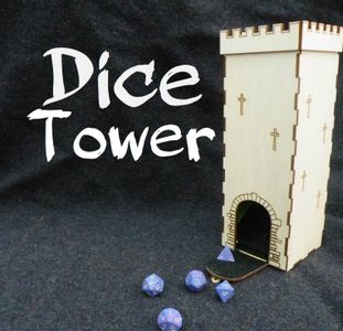

Introduction: Dice Tower
Every role-player needs dice.
Dice need rolling.
Rolling dice need a dice-tower.
This is the tower I made for my eldest - it's fully lined to reduce the clatter of the dice, and has a magnetic closure.
(Big shout-out to Jayefuu for letting me use his very cool door design - sorry I didn't leave the hinges on, dude!)

Step 16: Done!
That's it, you're ready to go.
Open the front door, drop the dice into the top, and read off the score.
I've tried the tower with every shape of dice, even D4, and they all roll through easily. In fact, even a handful of change tumbles through without sticking or catching anywhere.
