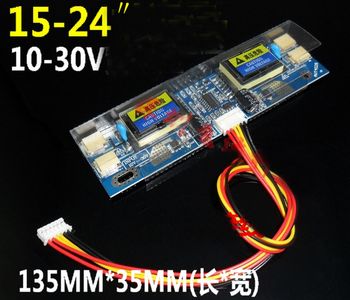

- a 4-channel CCFL Monitor Backlight Inverter ($8 here on ebay)

Step 6: Connect the CCFL Inverter
Attach the CCFL inverter board to the leads that go out to the backlight. The connectors for CCFL are standardized, and should fit right into the corresponding jacks on the inverter board.
Once it is plugged in, secure the board to the back of the backlight with double-sided tape.
Step 7: Wire Up the Voltage Regulator and Battery
For some silly reason the CCFL board runs on 12V, but also requires 5V control signals (ENABLE and ADJUST).
So, we need to connect a 5V regulator -- the UA7805 -- in between the battery and the inverter board, as shown in the diagram below. The circuit produces a 5V signal and connects it to leads 3 and 4 of the power connector for the inverter.
The power connector, which should come with the CCFL Inverter, has six wires leading from it. Here is the pinout:
1: V+ (12V)
2: V+ (12V)
3: ENABLE (5V)
4: ADJUST (5V)
5: GND
6: GND
I found it convenient to attach the voltage regulator circuit to the back of the monitor -- but you could just as well fit it inside.
