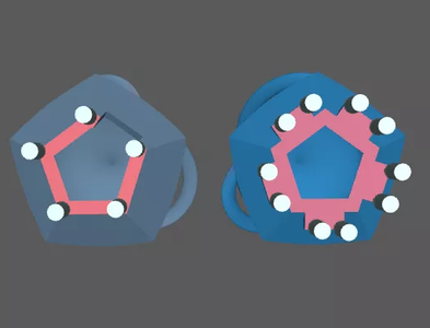

Step 1: Slice and Dice the Parts
Both the designs are 5 pointed stars in 3 dimensions. The Celtic Star and the Star of David are both assembled the same way. It's the outer shell that is different.
Each star is made of of 12 parts. Each of which is glued together with super glue. The 12 parts have 2 different designs that interlock. A slot part and a tab part. The slot parts we will need 10; and of and the tabbed parts we will only need 2.
On my any cubic photon I can get 28 parts placed. In the picture you can see the locations of the supports I used. I printed with a layer Hight of .05mm.
