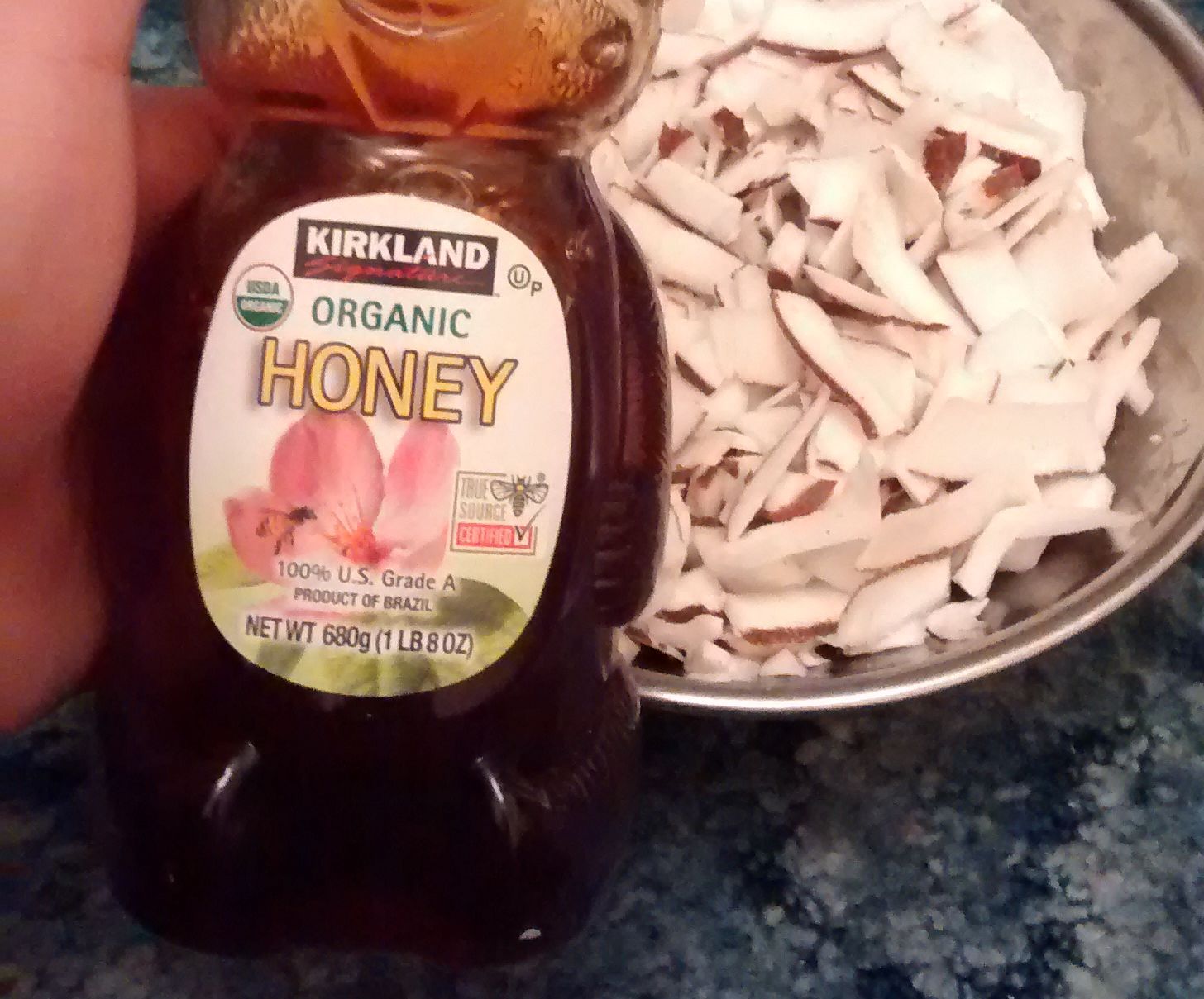

Step 3: Preparing Your Honey
The amount of honey in the first picture is WAY too much, it bubbled over a lot and I had to clean up a lot.
Use the amount of honey that you think will fit around your tang to make the handle, then add a little bit more. If you use a bigger pot, then you could use a larger amount. Heat this honey up until it bubbles profusely and begins to turn a deep red amber. The color you are looking for is a bit lighter then the last picture. Do this slowly because it goes fast.
Do not make too little because you can not easily add new honey to what you have already caramelized.
