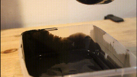

Step 1: Mix Paint & Water
  • Mix paint with about 10-20% water. The mixture should be pretty thin so it can easily form an even coating, but not too thin that you need many layers of coating.
  • Pour the mixture into a large container, and blow away any bubbles left on the surface.

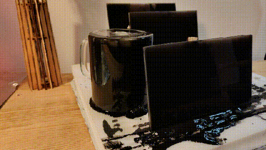

Step 2: Apply Two Layers of Paint
  • Dip the the glass into the diluted paint, and let the excess paint drip back into the container. I use a suction cup, but you can just dip you fingers and wash off the paint (or use gloves)
  • Put the painted glass on a drying rack. I made mine out of packing foam and some sticks.
  • Once the glue is fully dried, dip the glass once more and let it dry again.
Dipping twice is crucial - one layer won't be enough! It's still pretty translucent and you can't engrave it this way - you'll get really bad results. After the second layer is done, the glass should be painted evenly and be completely opaque - compare the 3rd image (one layer of paint) with the 4th image (two layers of paint).
