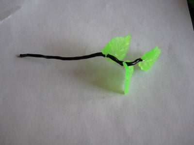

Step 4: Make the Leaf Stems
Cut a 5 or 6 inch piece of wire.
Fold it in half.
Thread a leaf onto it.
Give it a twist or two to hold it together.
Thread on a short piece of shrink tubing and shrink it.
Keep adding leaves and tubing this way until you like it. Leave plenty of un-leaved wire at the end, but finish it all in shrink tubing.
Make enough of these so that there is one leaf stem for every 2 to 3 flowers.

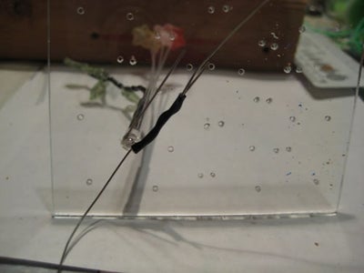

Step 5: Attach the Flowers and Leaves to LEDs
Group a couple flowers (3 worked the best for me) and one flower stem.
Arrange them together so that the heights look good to you.
Cut them all off evenly.
Thread them into the clear shrink tubing a bit. The goal is to find a length of tube that supports them and lets them move around a bit.
Cut the clear tube off with about 1/4 to 3/8 inch extra.
Push the bulb of an LED into the end of the tube. Fidget with it until the LED is solidly in the tube and the fiber optic cables touch it.
Heat shrink it together. BE CAREFUL. The fiber optic is a thermoplastic and will melt with heat. Try to move the heat gun around as much as possible and focus the heat toward the bottom.
Repeat this until all of your flowers and leaves are used up. I ended up with 10 groups.

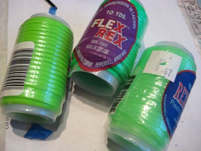

Step 6: Make the Grass
Cut lengths of the lanyard plastic that are around 4 inches long.
Group them in 4 to 7 strand bundles.
Use a short piece of wire to twist them together. This wire will push through the base to support the grass.
Wrap another piece of wire around the whole group folded in half to keep the strands upright (look at the pictures - it's easier to see than to explain).
Repeat this until you have about 24 groups.

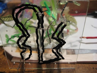

On your remaining plastic decide where you'd like the flowers to go. Spread them out as equally as you can. Drill pairs of holes for the LED legs to go though, keeping in mind a 'route' for the wiring. All of the positives need to connect, and all of the negatives need to connect. I added 4 LEDs without flowers to help brighten it up.
Once those are drilled fill in the board with single holes for the grass. Again spread them out, and make sure there's a row of grass around the outside edge to camoflauge any visible LEDs.

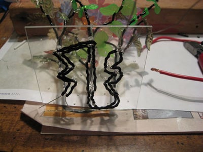

Push one LED through the panel. On the bottom fold the wires over in the direction of the next LED you plan to wire.
Cut two lengths of wire long enough to trace the entire patch of the LED wires.
Leaving a short tail, twist one of them around the positive wire of the LED on the panel. Cut a piece of the black shrink tubing long enough to reach from there to the next LED (plus a bit, because it will shrink along the length of the wire as well.) Thread the tube on and shrink it. Do the same to the negative side. Trim off any extra LED wire. Add another LED and keep wiring the same way. Connect up all of your LEDS being REALLY careful to keep all positives connected to positives and negatives connected to negatives.
At the end of the positive wire cut it down to an inch or so, then add shrink tube and a resistor.
Push the grass pieces through their holes, fold over the wire on the back and secure it with a bit more epoxy.
*All images are the BOTTOM of the panel.*
