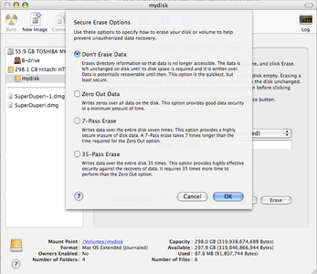

What you need to do is completely Zero your drive, which will completely erase everything on it and find the locations that may be damaged and demarcate them as such.

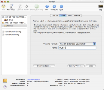

You should first plug in the new hard drive enclosure with the new disk in it . Now you should open the Disk Utility. You can find it in Applications/Utilities/Disk Utility. You should see the new hard drive icon up on the right.
- Click on it and then select the Erase tab.
- Click the Security Options button
- Select Zero Out Data and click OK
- Now press Erase

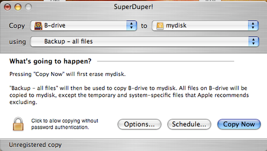

- Download & Install Super Duper
- Open the program
- Select your current hard drive on the left, and the USB external new drive on the right
- Select Backup - all files
- Click Copy Now
