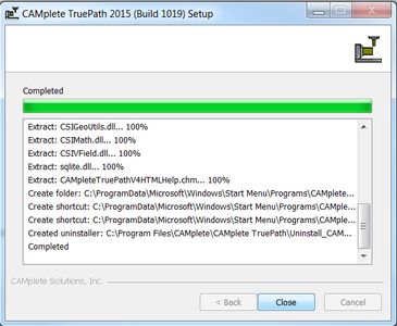

Step 3: Finish Downloading CAMplete

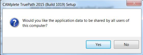

5) If you want to share the application data with all users of your computer, click Yes.

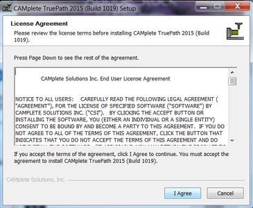

6) Choose I Agree for the license agreement.

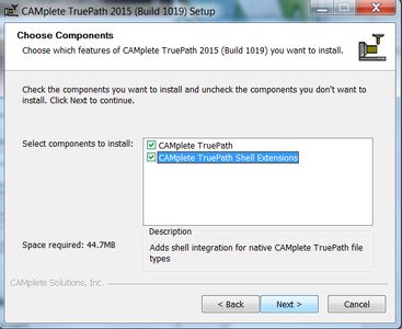

7) Choose both components to install.

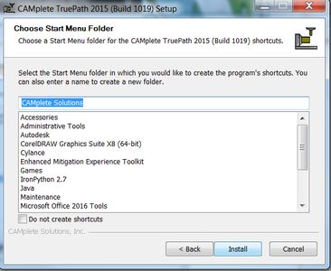

8) Choose Install Location and Start Menu Folder. Click Install.
9) Click Close.

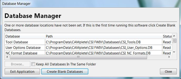

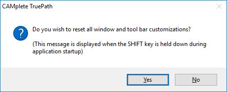

Step 4: Open CAMplete Trupath and Exit
1) Open CAMplete.
2) When prompted to create databases, exit application.
These steps ensure that the CAMplete data will appear in the next step.

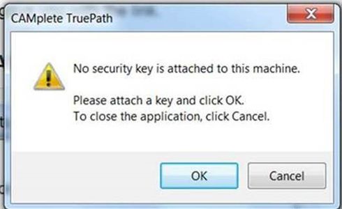

Note: if you get an error that you need to install a security key, go to the next step for troubleshooting.
Step 5: CAMplete Install Troubleshooting
In some cases, CAMplete will not open after downloading and instead you'll be prompted to attach a security key. Here are some steps to help you troubleshoot this issue:

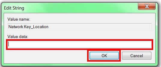

3) Navigate to HKEY_CURRENT_USER/Software/CAMplete/CAMplete TruPath v4/Security Alert Options .
4) Look for Network Key Location in that folder. If you do see it, make sure you see the network key. If you don't see it, right click on the field and choose New>String Value.
5) Name the new string value Network Key Location, and hit Enter.
6) Right click the string, and choose Modify.
7) Enter the network key, and click OK.
8) Try restarting CAMplete.

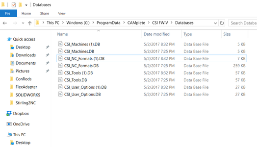

Step 6: Delete Default CAMplete Program Data
Now, you are going to delete the default CAMplete program data. Later on you'll install new data that's specific to the machine at Pier 9.
1) You might have hidden folders on your PC. Check if you can see a folder called 'Program Data' in your C: drive.
'Program Data' is not the same as 'Program Files'!

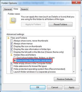

2) If you can't see 'Program Data', navigate to your Control Panel and choose Appearance and Personalization.
3) Choose Folder Options.
4) Click on Show hidden files and folders.
5) Under Folder Options, click the View tab, then click the button next to Show hidden files, folders, and drives, and then click OK.
6) Go back to your C: drive and click on Program Data.
Note: Alternatively, you can enter '%programdata%' in the file explorer path field to go directly to the folder.
7) Navigate to the' CAMplete' folder, and click Delete.
NOTE: DO NOT CONFUSE PROGRAM DATA WITH PROGRAM FILES. Otherwise you'll delete your installation of CAMplete!
You are going to replace this data with data specific to Pier 9 and our Matsuura MX-330 in the next step.
Step 7: Add in Pier 9 CAMplete Program Data
1) Open the 'CAMplete data' folder in Dropbox.
2) Download the 'CAMplete.zip' file to a convenient location.
3) Right click and Extract All.
4) Leave the default destination and click Extract.

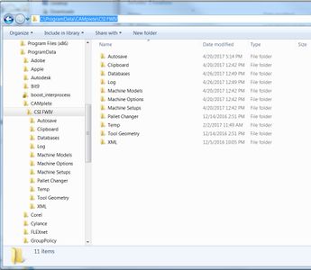

5) Navigate to the new CAMplete folder and drag it into 'C:/Program Data'.
Note: Do not drag the folder within the CAMplete folder, CSI-FWIV, into Program Data, or the file browser tree structure will be incorrect. The full explorer path field should look like this: C:\ProgramData\CAMplete\CSI FWIV . Check this against the last screenshot in this step.
You have now added all the data that CAMplete needs for Pier 9, including the correct post processor and machine definition.

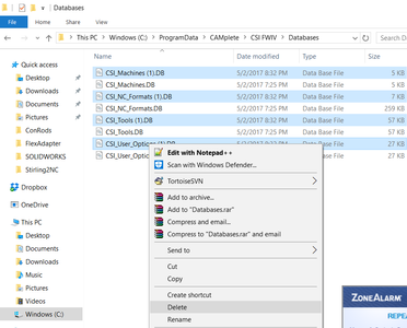

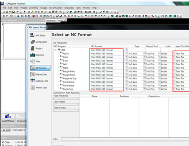

Step 8: Verify That CAMPlete Is Running
1) Open CAMplete again.
2) Click Create Blank Databases.
3) When the Paths have been populated with databases (red text turns black), click Close.
4) CAMplete should open automatically. If prompted, run updates.
You have now verified that you have CAMplete up and running on your machine.

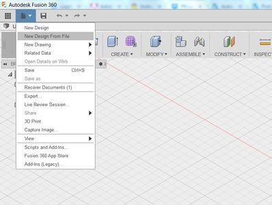

1) Download 'P9 Lang 1471555 Jaws Normal.f3d' from Dropbox.
2) Open Fusion 360, go to New Design from File, and choose the file.
3) Click the Save button and then click New Project.
4) Create a new Project called called 'Matsuura Projects'.
5) Name the file 'P9 Lang 147155 Template', and save it inside 'Matsuura Projects'.

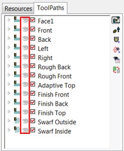

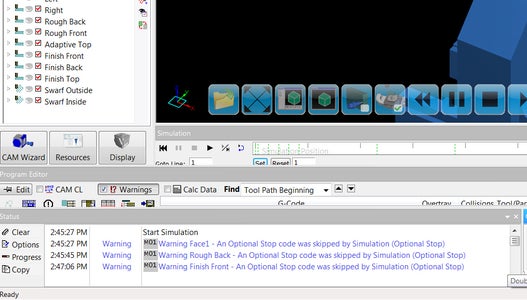

Step 18: CAM Toolpathing
Following this workflow, at this point you would continue with your CAM toolpathing. The simulation will now give you collision data if you machine into your fixture--a compelling reason to perform CAM with a model of your workholding system.
Because this Instructable is not intended to teach you CAM, you are going to work with this same file, except with completed toolpaths, from this point forward.
1) Save the current file.
2) Download this file with toolpaths from Dropbox: MX-330_CAMplete_part_with_toolpaths.f3d.
3) Open the file in Fusion 360.
4) Watch the simulation so you understand what the toolpaths are doing.

Step 23: Verify NC Format
4) On the left side of the window, click NC Format.
5) Verify that the NC Format is Pier 9 MX-330 Format for every toolpath.
Note: If this format is not showing up, please see next step for troubleshooting.
Step 24: CAMplete Troubleshooting: NC Format Not Appearing
If you were able to see the machining definition, but not the correct NC Format (Pier 9 MX-330 Format), try following these steps.
1) You will see 'Default Format Not Found' in the NC Format dropdown. Click the dropdown to make sure there are no other formats that appear.
2) Navigate to C/Program Data/CAMplete/CSI FWIV/Databases.
3) See if there are duplicate databases--for example, CSI_Machines(1).DB. If these duplicate databases appear, delete them.
4) Open a New Project in CAMplete (File--New Project), browse back to the folder with today's date, and see if the NC Format now appears. If not, proceed to the next step.
5) Cancel out of the New Project window.

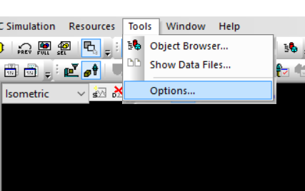

6) In the CAMplete Tools dropdown, choose Options.
7) Click Databases on the left side.
8) The duplicate databases might still be there. In this case, double click each one, and re-map to the original database.
9) Open another New Project, and see if the NC Format appears now. If not, try closing and re-opening CAMplete.
10) If the Pier 9 MX-330 Format appears, continue with the next step. If it does not appear, email Pier 9 CNC shop staff.

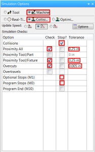

1) On the right side of the screen, under Simulation Options, click the buttons next to Machine and Collision.
Though real-time simulation can be helpful to visualize what is going to happen, it does not perform collision detection, which is what you really want CAMplete to be doing. Feel free to toggle between these two modes as you become accustomed to CAMplete, but be aware that Collision mode is your final safety check.
2) Check the box for Stop next to Collisions.
3) Click on Check next to Proximity All, and enter a Tolerance of 0.25".
If any objects come within 0.25" of the machine components, CAMplete will create a red error message. Always heed these warnings--this is too close to be safe.
4) Click on Check next to Proximity Tool/Fixture, and enter a Tolerance of 0.25".
If the tool and fixture come within 0.25" of each other, CAMplete will create a red error message. In this case, consider moving the part further from the fixture in the Fusion 360 setup.
5) Click on Check next to Overcuts, and enter a Tolerance of 0.005".
Overcast are tool gouges in the part. If you used negative stock to leave in Fusion, you may need to adjust this tolerance.
6) Uncheck the Stop boxes next to Optional Stops and Program Stops.
7) On the left side of the screen, click the eyeball icon next to each toolpath to remove its visibility in the simulation window. This will make the simulation easier to see.

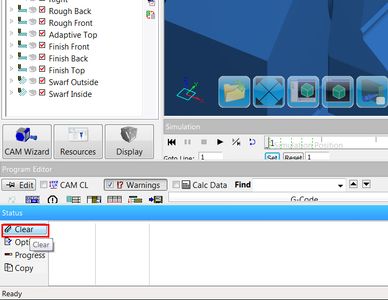

Step 29: Start Simulation
1) On the bottom left side of the screen, click Clear under Status.
This will empty the log so that only the latest errors, warnings, and events will appear.
2) Under Simulation, Click Play.
Unlike Fusion 360, CAMplete runs its simulations directly from G-code code rather than intermediary information from the software. Because this G-code is exactly what you will run inside the machine, CAMplete is a trustworthy safety check.
As the program plays, pay attention to the Status panel and make sure you don't see errors in red. Any red error in CAMplete means that it is unsafe to run the program on the machine. ALWAYS HEED THESE ERRORS AND MAKE ADJUSTMENTS ACCORDINGLY.
If you pause the simulation or make adjustments to tolerances, click the rewind button twice--once to go to the beginning of the toolpath, and once to go to the beginning of the program.
You'll notice that the CAMplete settings don't provide a very visually continuous simulation--the image will only refresh every few seconds. The visuals are much smoother when you run real-time simulation, but again, this does not provide collision detection and is therefore only useful for understanding what will be happening physically inside the machine. You can adjust the simulation settings under Tools/Options/Simulation/Update Based On Time, but this will slow down the simulation processing time.
Once you've simulated the entire program, scroll through the Status window to ensure that there are no red errors. If you see any, you will need to go back to Fusion 360, make adjustments, and repeat the CAMplete process.
Step 30: Re-setting CAMplete Dock Views
It's a common problem for users to lose dock views when using CAMplete. If a window disappears while using CAMplete, follow these steps.
1) Save your file.
2) Close CAMplete.
3) While holding down the Shift key, re-start CAMplete.

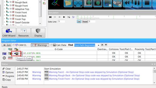

Step 31: Export G-code
Because the G-code has already been created, all you need to do now is export it.
1) In the Program Editor towards the bottom of the screen, click the disk icon for Export G-Code.
2) Insert a USB into your laptop, navigate to the USB, and click Select Folder.
