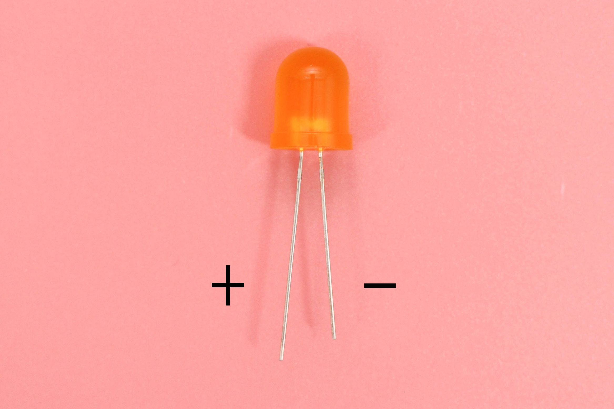

LED
LED stands for Light Emitting Diode. When the right amount of voltage is applied to the leads, an LED produces light. You can find LEDs in all kinds of shapes and sizes. In this class, you'll use 10 mm LEDs. To light up, an LED needs to be positioned in a circuit in a particular way. The short lead goes towards the negative side of the battery marked with a "-" and the longer lead goes towards the positive side of a battery "+".

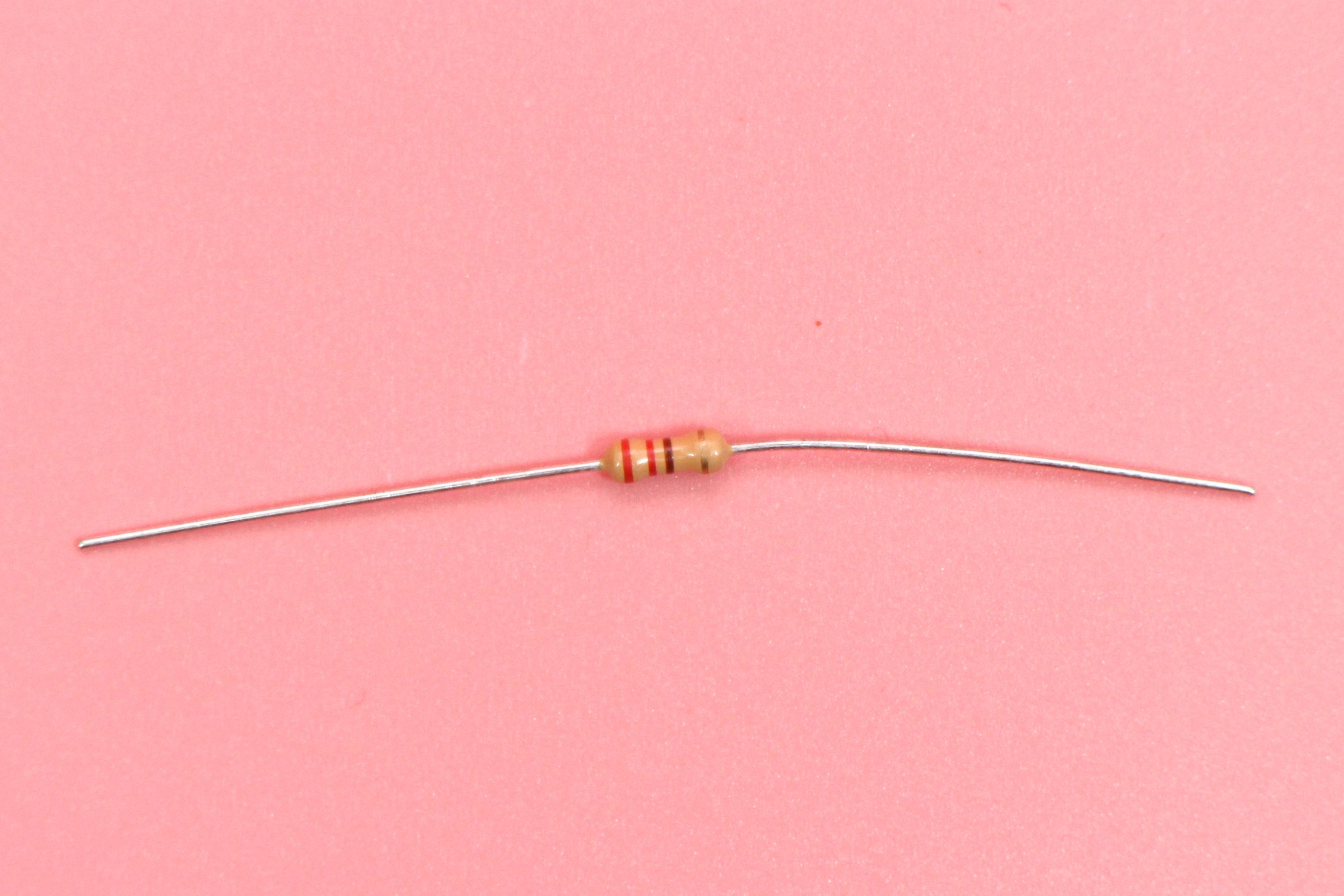

Resistor
A resistor is a common component found in circuits that limits the amount of current that flows. In this circuit, a 220 ohm resistor is used to protect the LED from blowing out (LEDs tend to draw too much power on their own).

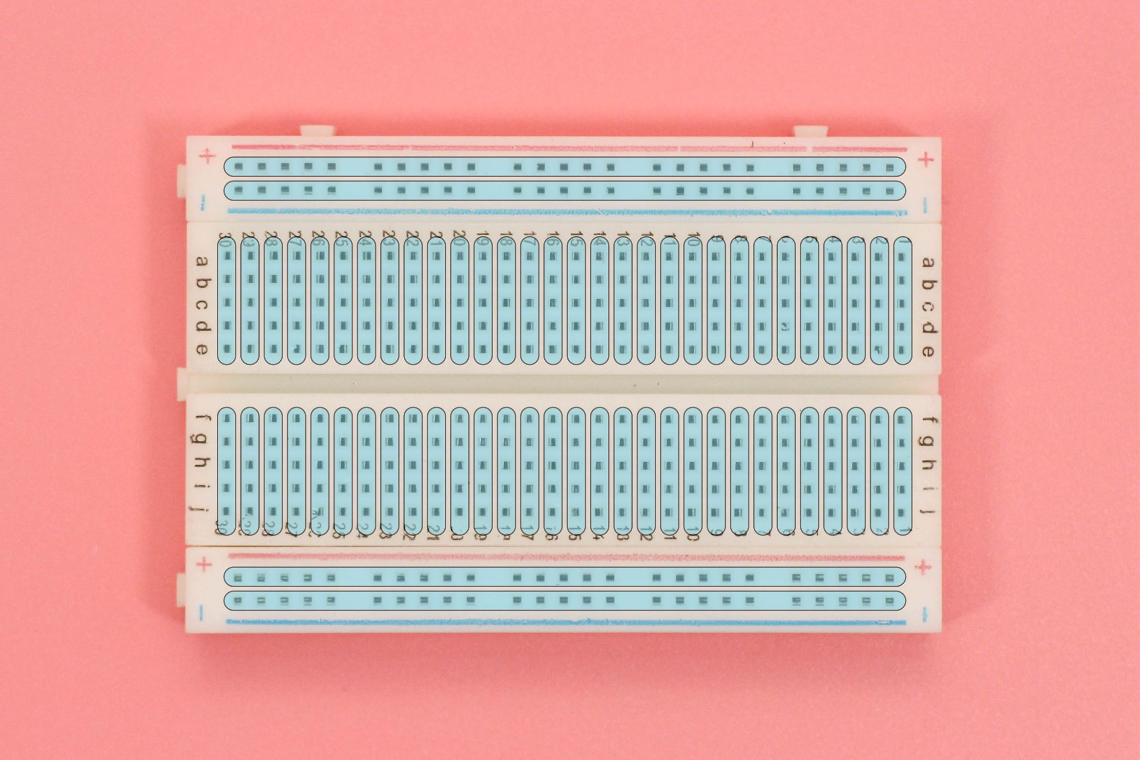

Breadboard
A breadboard is a tool used for quickly building and prototyping circuits. It is comprised of holes that provide a plug-and-play way of connecting electrical components. The connections are made by metal plates inside the board. Once you know which holes are connected to which, you can start plugging in components to make electrical connections. Here's how the holes of your breadboard are connected:
Notice the blue and red lines next to the long strips. These are called the power and ground bus strip or rail. Power and ground are jumped to these strips so components can easily access them.

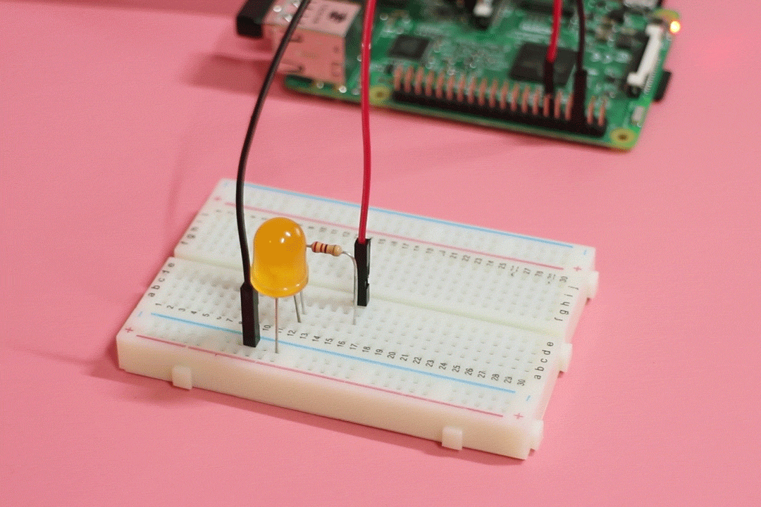

Step 5: Build Circuit
Time to get to circuit building! Connect the LED and a 220 ohm resistor (red, red, brown) to your Raspberry Pi as shown in the diagram. Jump ground from the Raspberry Pi to the ground rail on your solderless breadboard, and jump GPIO 17 to the positive side of your LED-resistor combo.
Positive (long) lead of LED --> 220 resistor
220 resistor --> GPIO pin 17 (board pin 11)
Negative (short) lead of LED --> Ground rail
Ground rail --> board ground pin

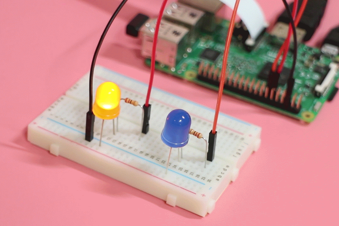

Step 9: Build Circuit
It is likely you will want to put many LEDs in a project, and need another anyway for the photo booth project. Connect a second LED as shown in the diagram.
Positive (long) lead of LED --> 220 ohm resistor
220 ohm resistor --> GPIO pin 27 (board pin 13)
This circuit will be part of the final photo booth project, so let's figure out how we want them to behave. In the final photo booth project, there are two LEDs. One alerts to you to get ready to smile before the camera starts snapping photos. Let's call this the countdown LED. The second LED turns on when the GIF has been uploaded to the internet. Let's call it the upload LED. Choose a different color of each. I chose the yellow for the countdown LED and blue for the upload.
Step 10: Blink Two LEDs
To get the second LED blinking add another variable below yellowLED = 17 and call it something unique:
blueLed = 27
Set the pin as an output:
GPIO.setup(blueLed, GPIO.OUT)
Create a for loop for the LED and put it below the first one. Change the number of times it blinks and how long the delay is. This blinks the blue LED three times every three seconds:
for i in range(3):
	GPIO.output(blueLed, True)
	sleep(3)
	GPIO.output(blueLed, False)
	sleep(3)
Save this sketch as twoLEDs.py and run. The first LED will blink then the second!
Great! You now have your two final LEDs for the photo booth working! Change the behavior of the LEDs to fit their purposes better. For example, perhaps you don't want your upload LED to blink at all and want it to stay on for a whole 10 seconds to make sure people see that the photo has uploaded. Or, you want the countdown LED to blink 3 times for a 3, 2, 1 countdown.

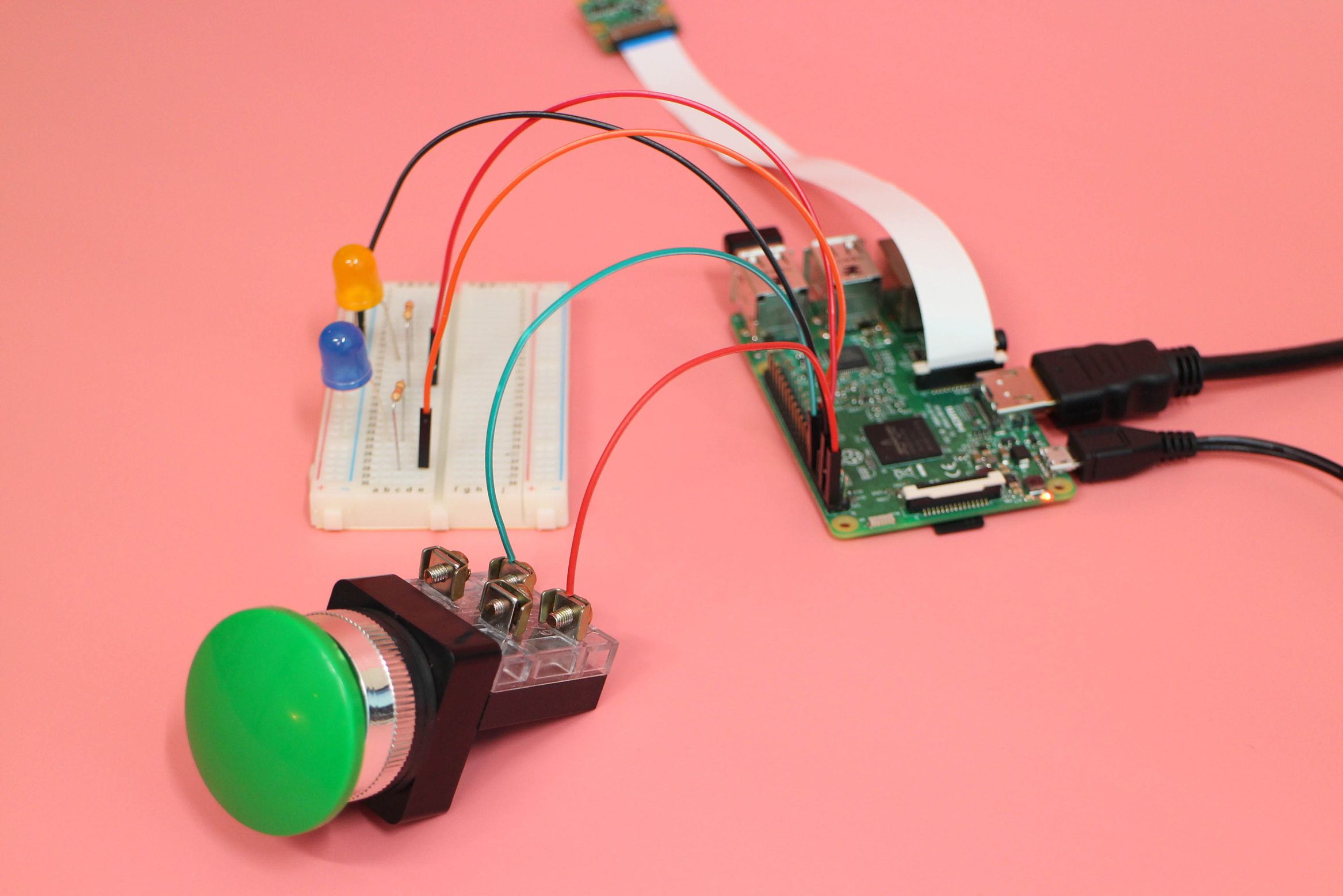

Step 11: Build Switch Circuit
Time to read a switch! First, you need to connect jumper wires to the switch's leads so you can connect it to the Raspberry Pi. The leads on this switch are the two bottom screw terminals.
Grab two jumper wires and a pair of angled wire cutters. Make sure the jumper wires each have a female header at one end. Cut off the end opposite the female header and strip the insulation off about 1/2" down.
Use a small Phillips head screwdriver to loosen the two lower terminals on the switch. The goal is to wrap the wire around the screw and to then capture it between the metal plates by tightening the screw. It helps to first twist the small strands of the wire together then create a small hook with the wire to hook around the screw post (clockwise, so the screw tightens the wire around the screw). Once your wires are connected to the switch, connect the switch to the Raspberry Pi as shown in the diagram:
either side of switch --> GPIO 18 (board pin 12)
remaining side of switch --> power pin (either 5 volts or 3.3 volts)
Leave the LEDs plugged in the breadboard; you will use them later on.

Step 15: Combine With Camera!
Whew! Great job. You've done a lot with just one simple circuit. Now, let's add the camera module. Instead of using Raspistill to take a photo like you did previously in command-line, you will use a Python module called picamera.
Create and save a new file called button_LEDphoto.py. Write the following code:

Save and run. The countdown LED will do its thing, then the camera will snap a photo.
After the image preview has stopped, the upload LED will go on. But right now, this program doesn’t upload anything! That's what the next lesson will teach you. Let's give that LED a real reason to go on!
