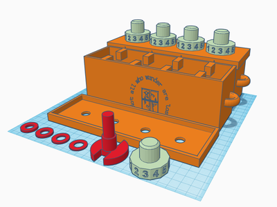

I've also purchased a 3D printer recently. After printing multiple maze containers for geocaching, I've decided to dust off my basic engineering skills and chose Tinkercad to make a lockable geocaching container.
So, I present you the 7th attempt at box making :D
First versions were .... emh... not a box... or not lockable ... or consisted of like 20 parts (yes, really) .
The lock is a rotational thingy, which is glued to the numbers' wheel while rotated to the preferred symbol.
The attached files should be quite self-explanatory, also a few links to the files online:
3D printer. I used Creality Ender 3 Pro with 20-80% infill.
Step 1: Printable .stl Files
Printable files, separate for the lid, box (+ unlabeled box) + the locking mechanism made out of two parts - a locking wheel and the numbers' wheel.
If your print feels too loose, you might print a few of the 1mm spacers and fit them between the lid and the numbers' wheel.
